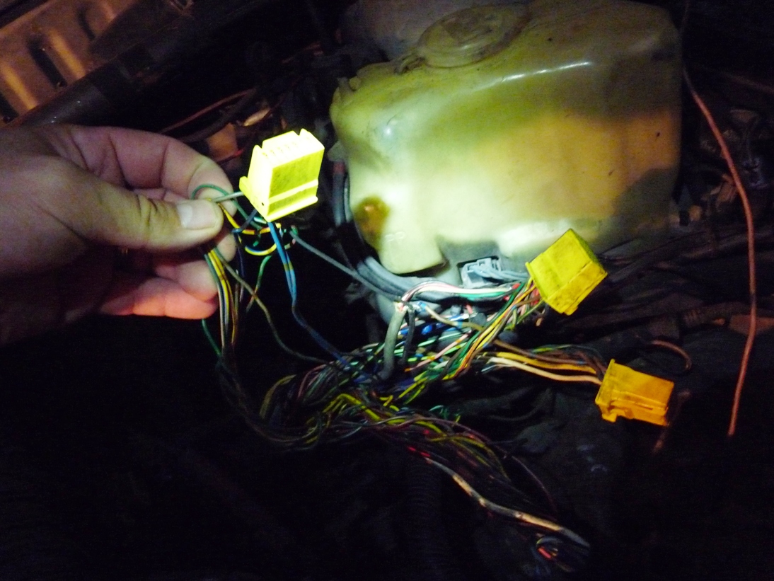

Thinking the problem was just a simple(?) engine loom swap, I pulled the loom out of the parts car and I was going to plug it upto my engine, connect the ECU and job done.
However! my engine has a lot more stuff connected then the parts car did, and when I was sitting in my engine bay tonight, it didn't feel right pulling the loom out.
After closer inspection of the loom that's in the GP, it looks like the #&*@ stupid &@$!% mechanic did splice it, but I have no idea what he did, however I do have a 4EFTE and 3ETE loom diagram so I could work it out.

To see the engine loom pics with blue electrical tape where it appears it was spliced, check out - Technical Thread

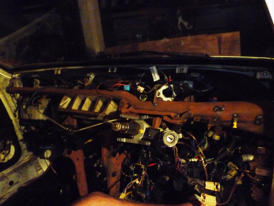

Ever wonder whats behind the dash of a EL31 Toyota Corsa??? (not even once?) Well just in case you do:
I'm planning to strip everything out, and put it aside.

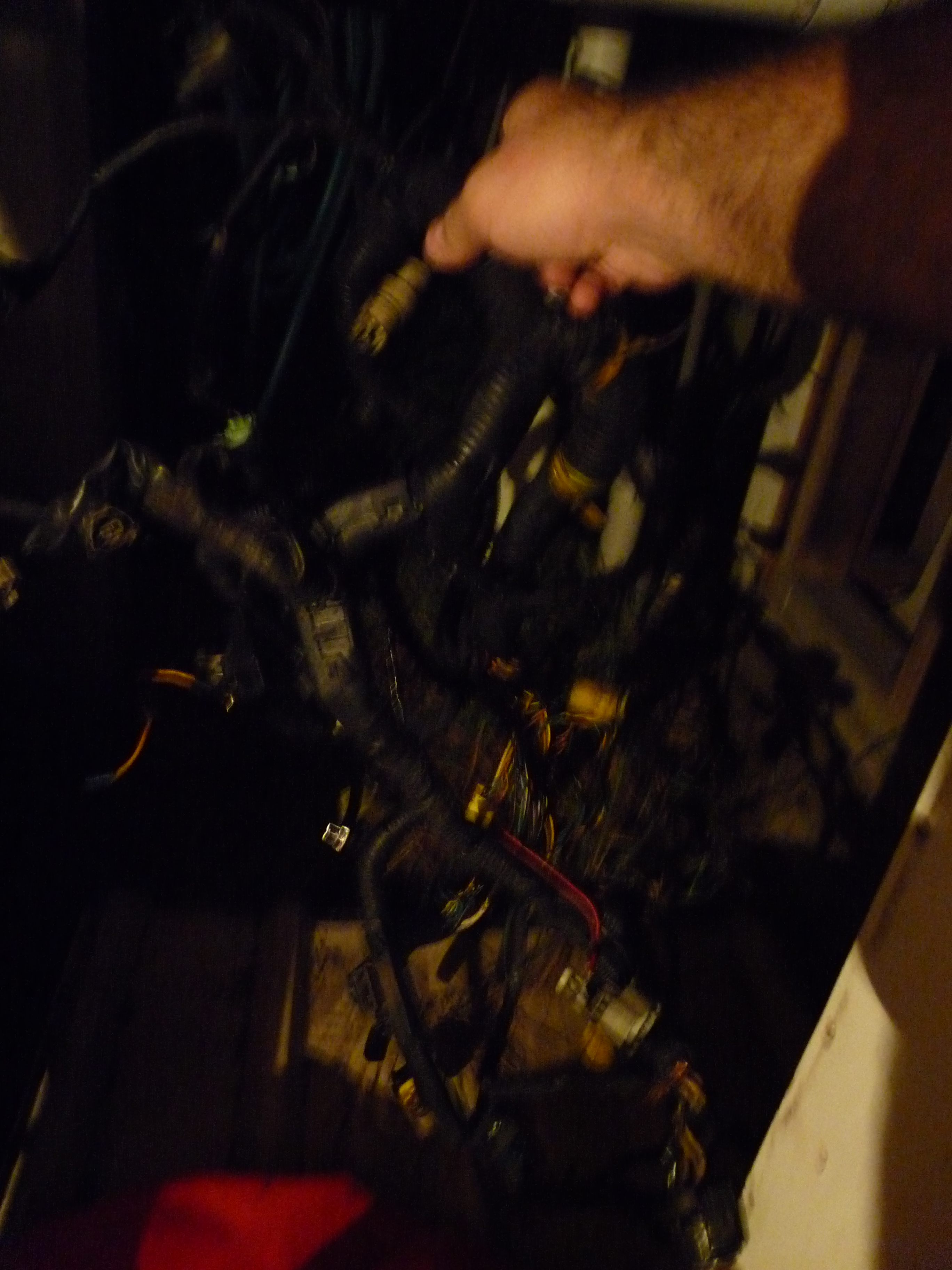

Difficult to get the loom out?

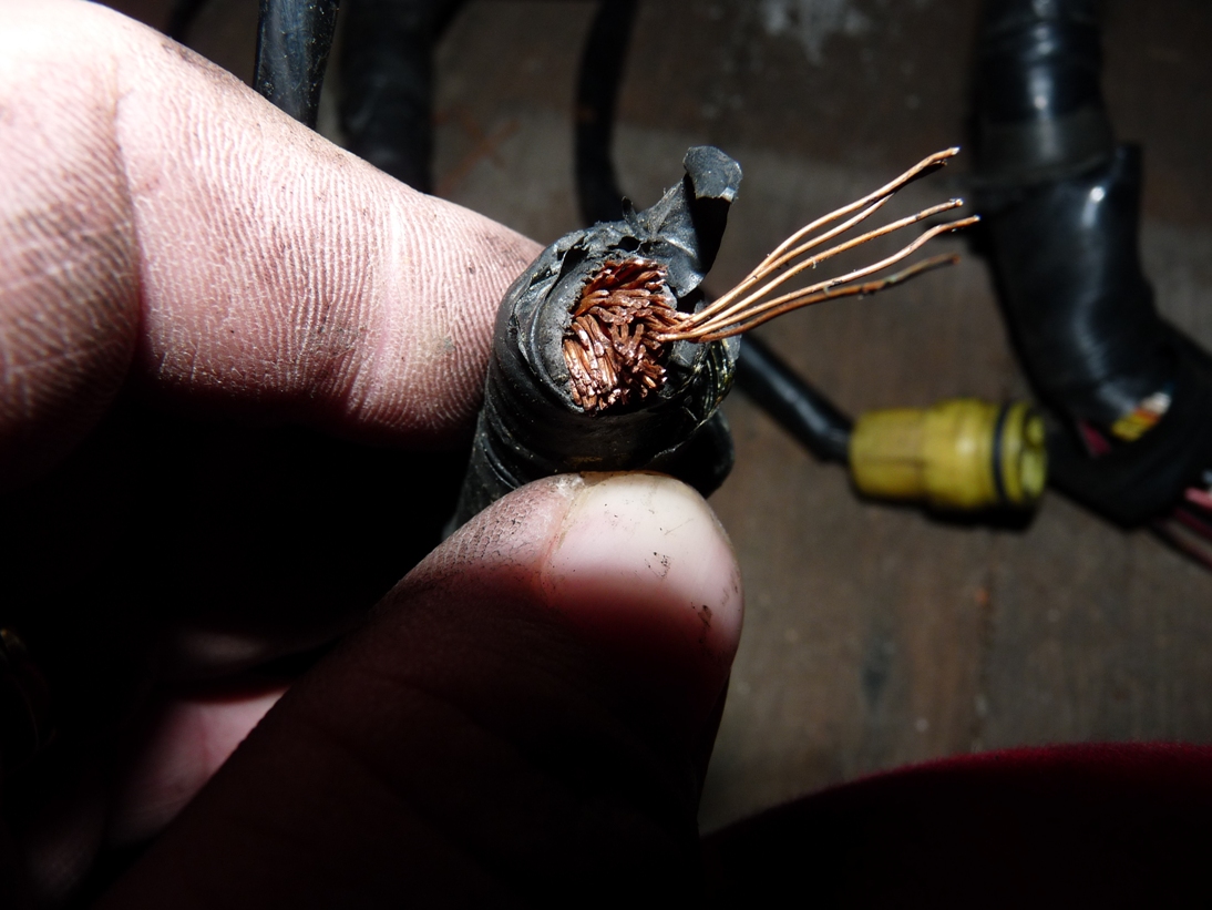

As for the loom, not really, just un-pluging and taking the care not to break anything, had to take the strut bar off to get in behind the motor, and also cut one huge arse copper wire behind the engine, not sure if that's important :hmm:

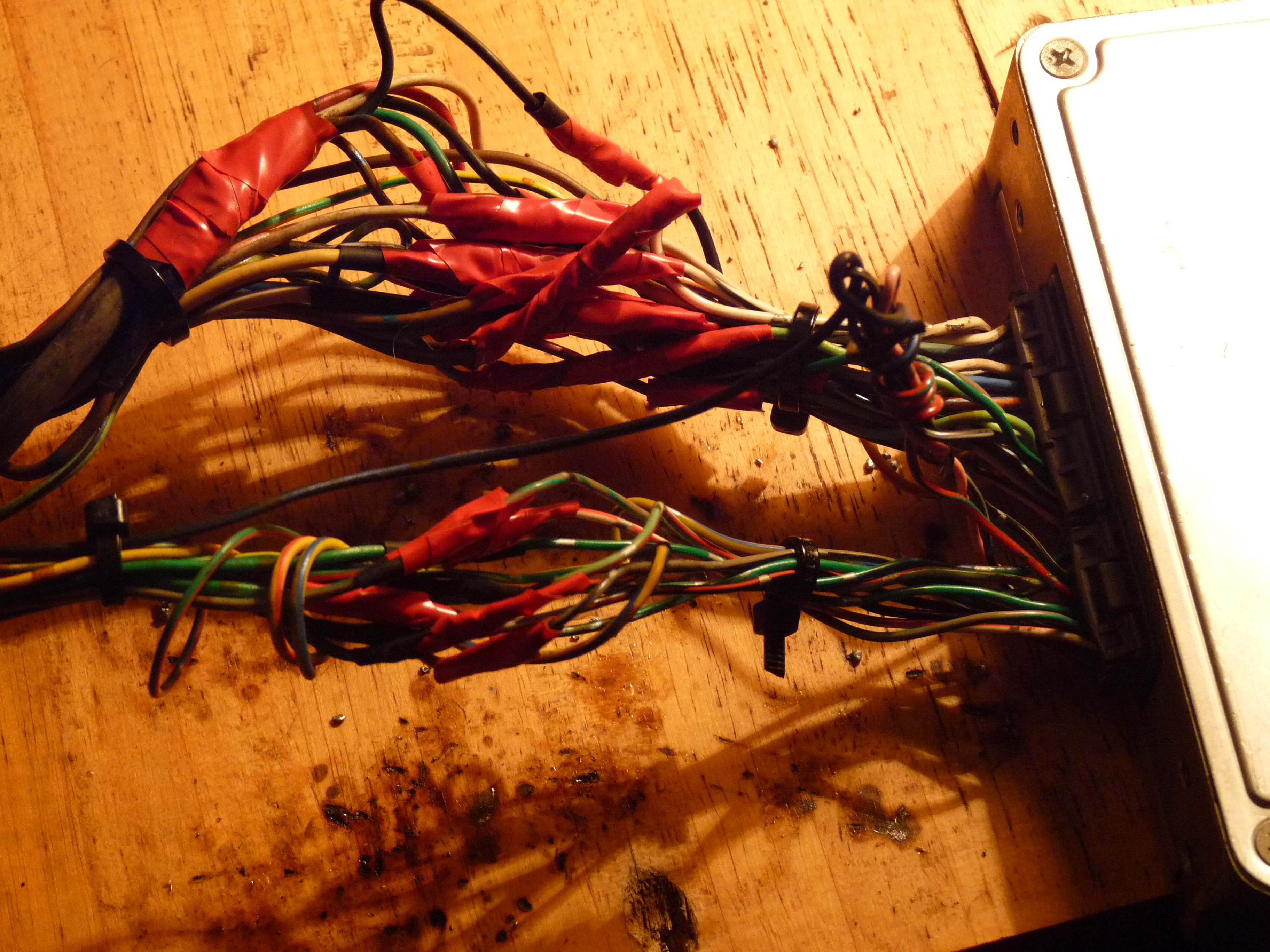

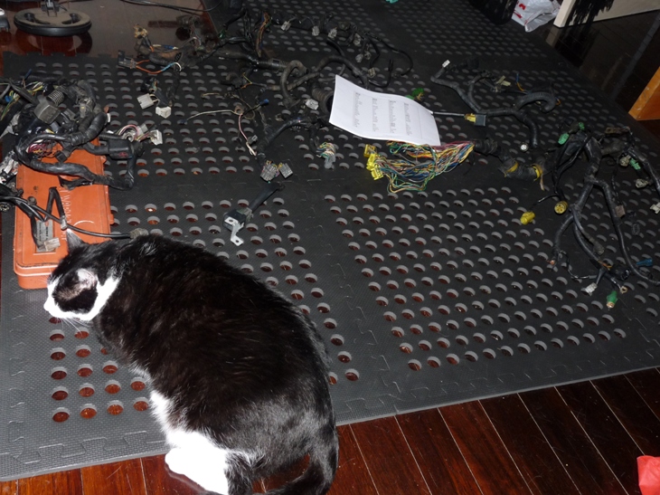

**EDIT** - Update: I just put both looms next to each other:
Here are some wiring issues :blinks:

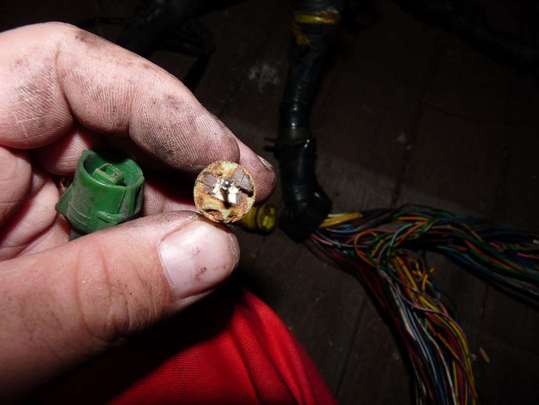

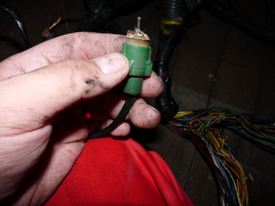

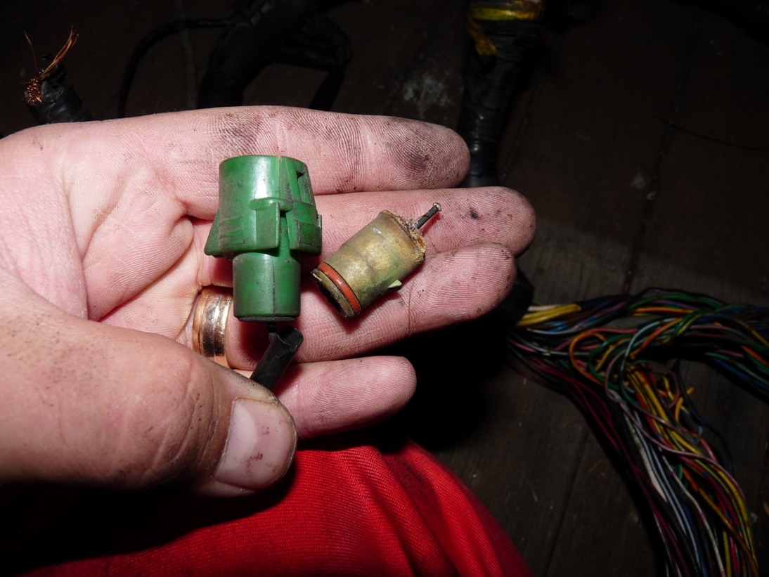

First 3 - accidential pulled out the sensor, whats' a good fix?
I had to cut this thick wire, any clues on rejoining something like this via male/female connecter?
Also, checked the looms out, seems to be a few different plugs and some completely missing.. :(
Edited by TOMsGPTurbo

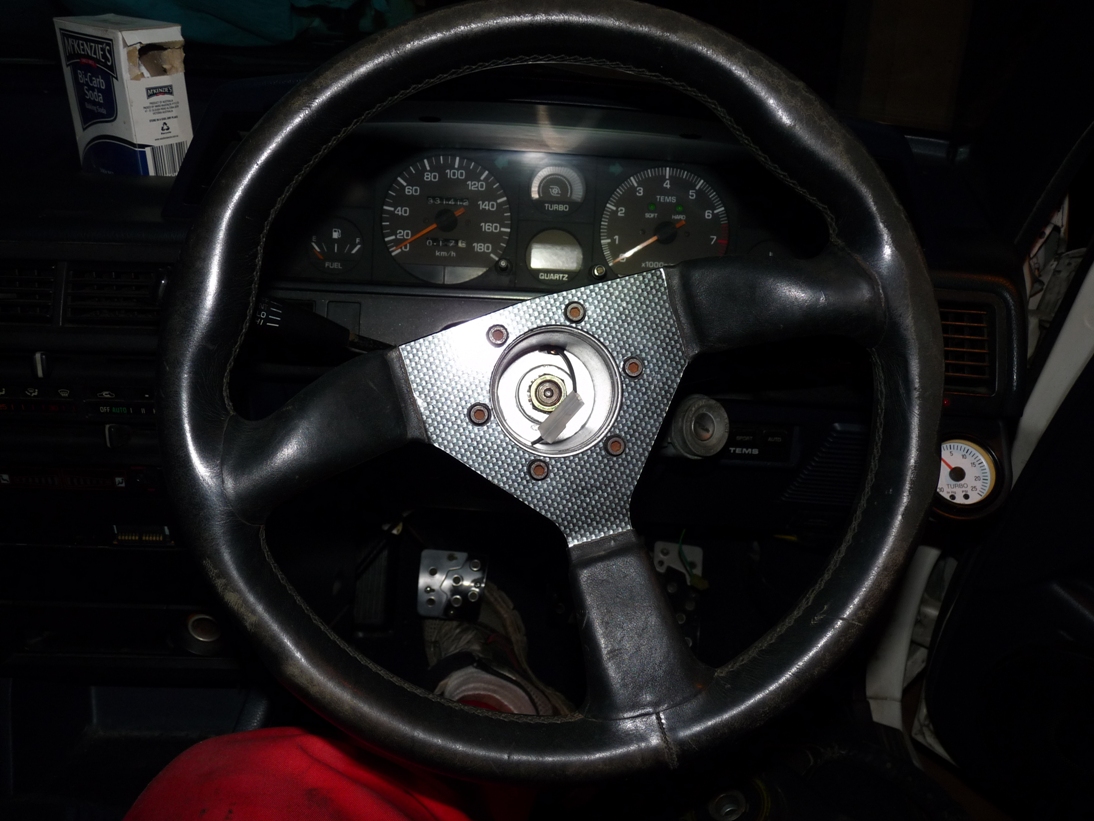

I thought I'll chuck that worn out Nardi steering wheel on, looks alright, crapy condition but a lot lighter then the original, which I'm planning to restore and keep around.

Current situation (with my assistant sleeping on the job):

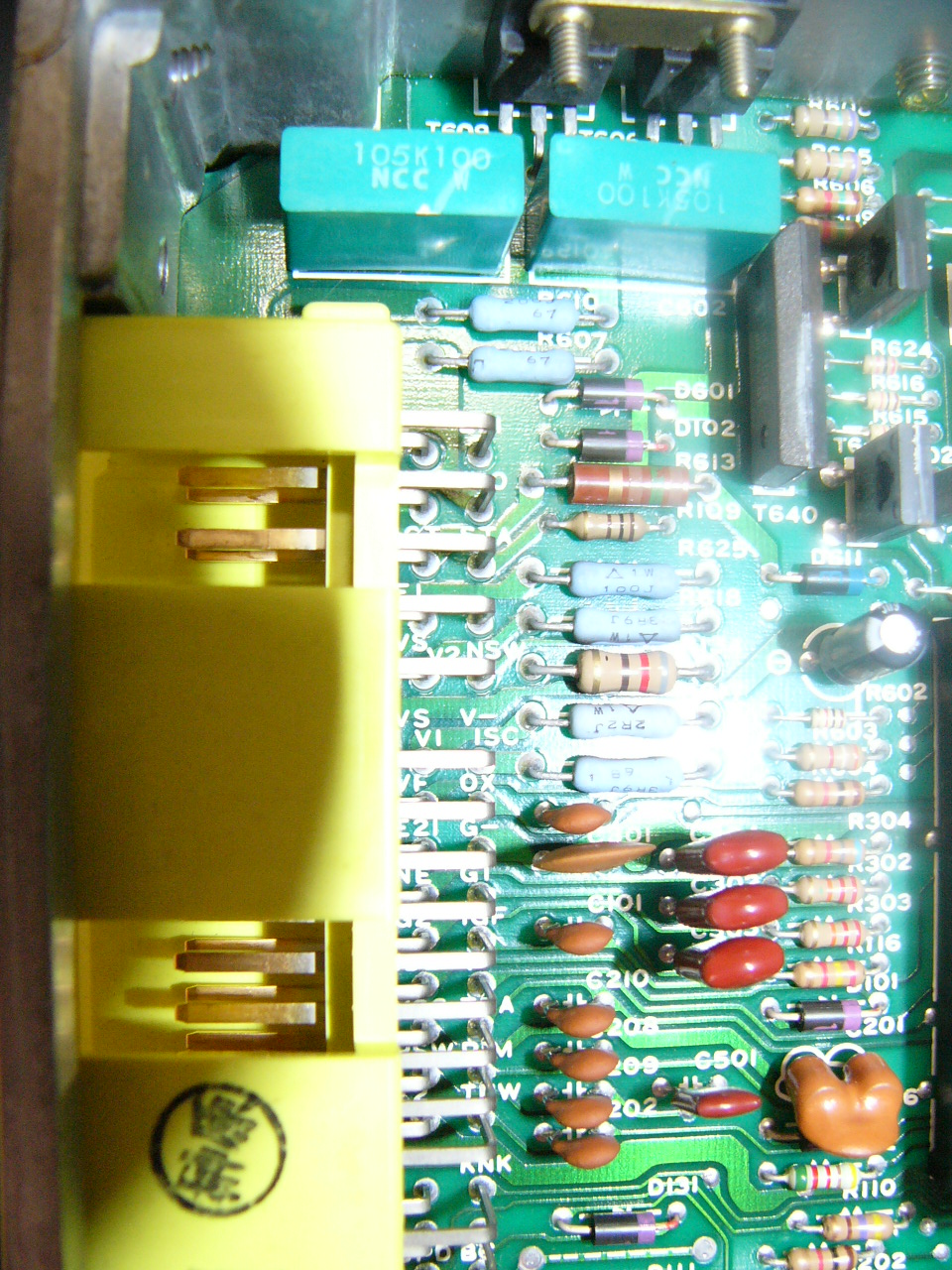

Would VS VS1 on the 3ETE ecu be the same thing as VS V1 on the 4EFTE ?
EDIT .. it is... I did a typo on my ECU plans
Should be VS V1 .. confirmed via ECU circuit board.

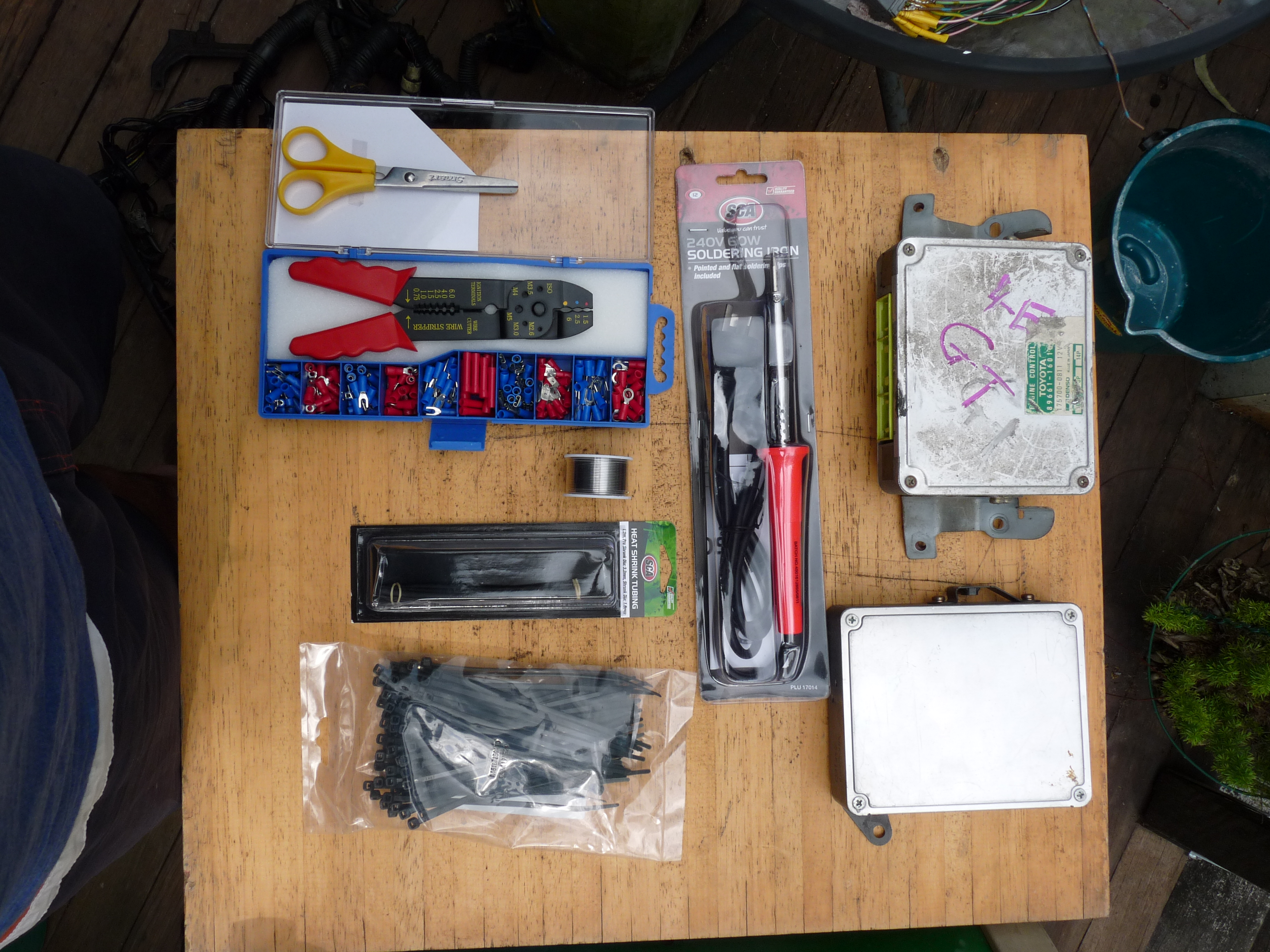

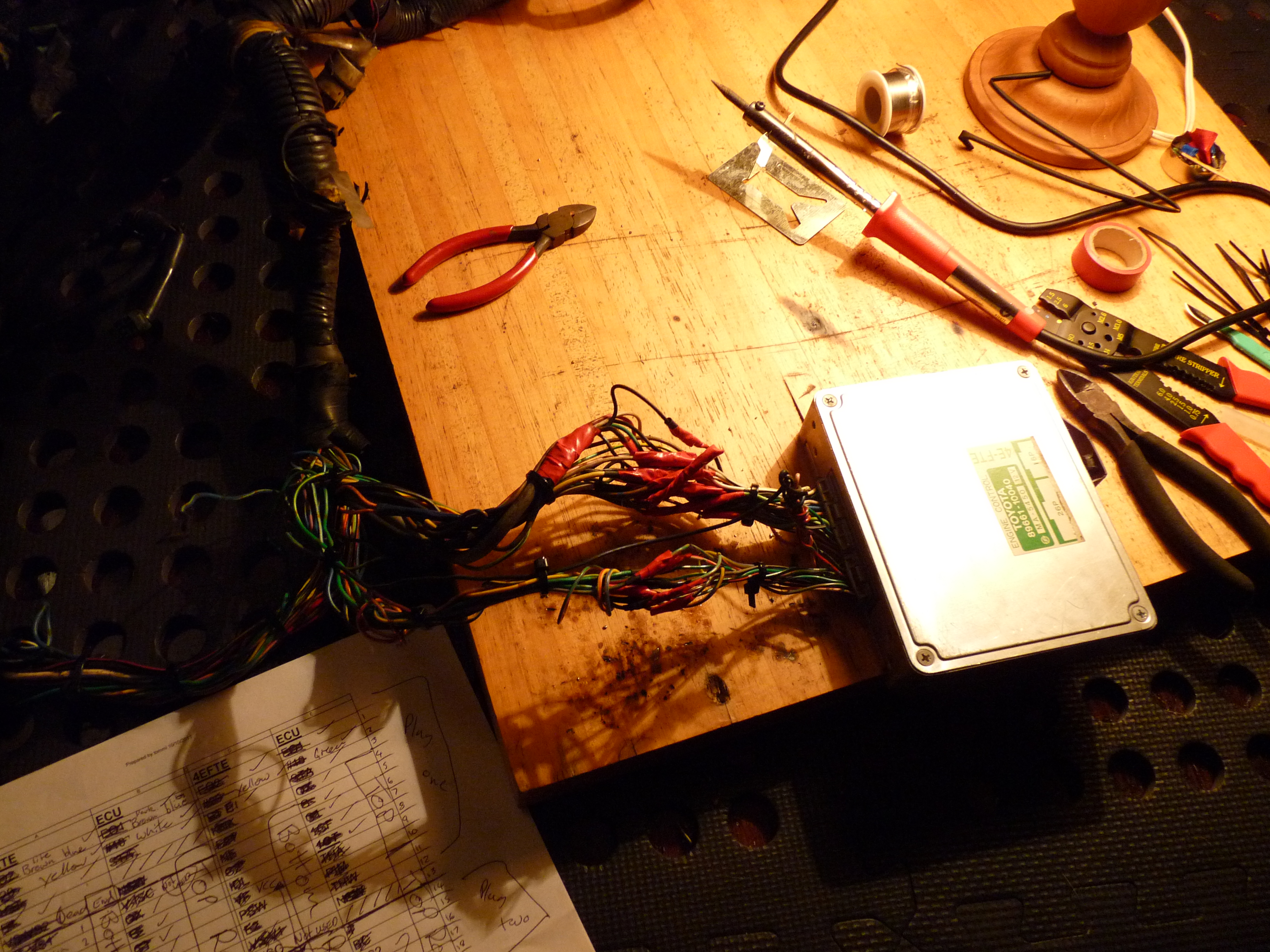

Started the wiring today, here are some photos:
All the equipment I purchased, $50.00
The mission:
I made a mistake, and had to re-track my steps .... major pain in the arse.

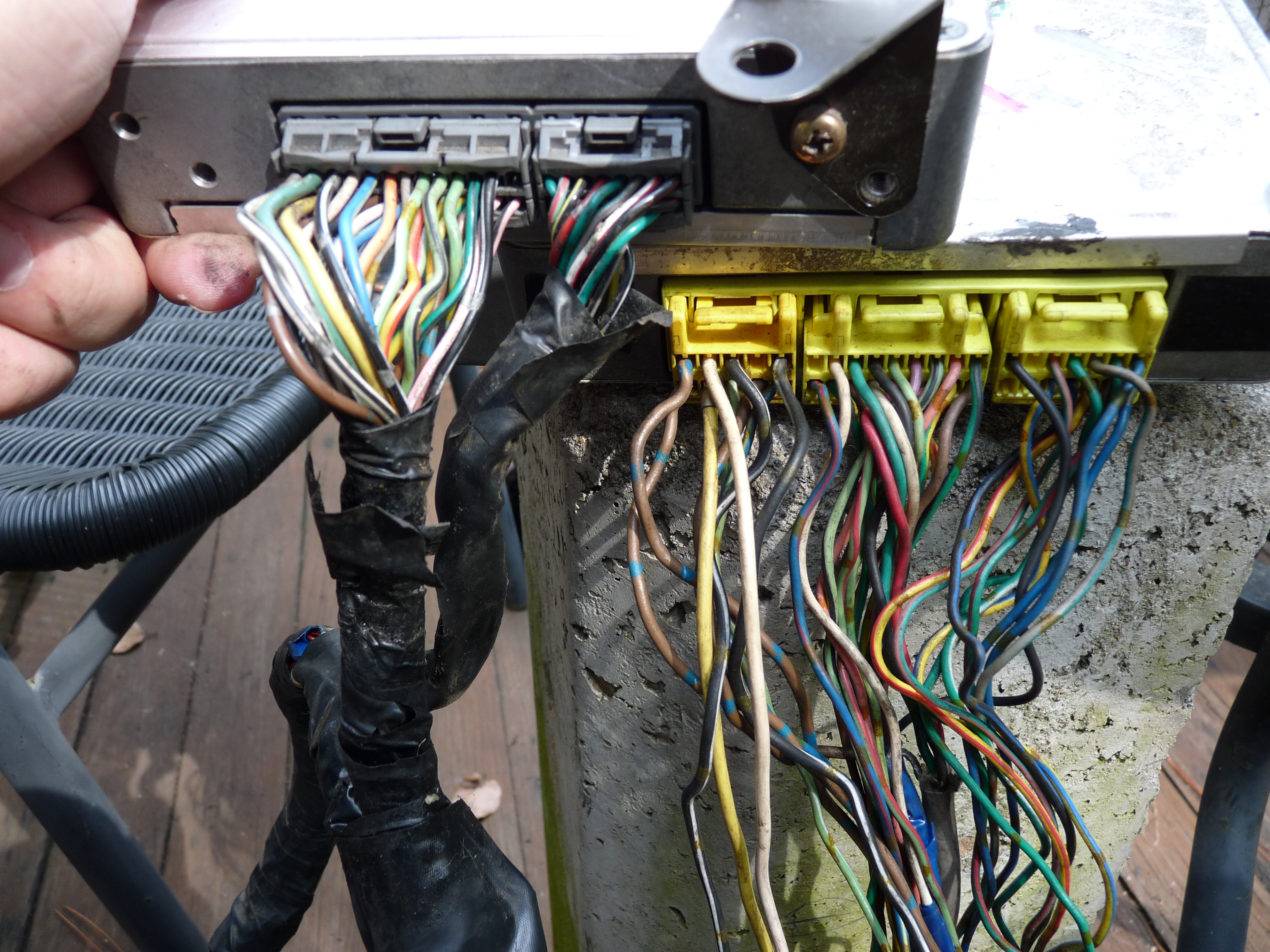

Anyhow, here is the 3ETE ecu loom with 4EFTE, my first go at auto-electrics, including soldering lol
Close up of ECU wires, may not be pretty, but lets hope it works:
