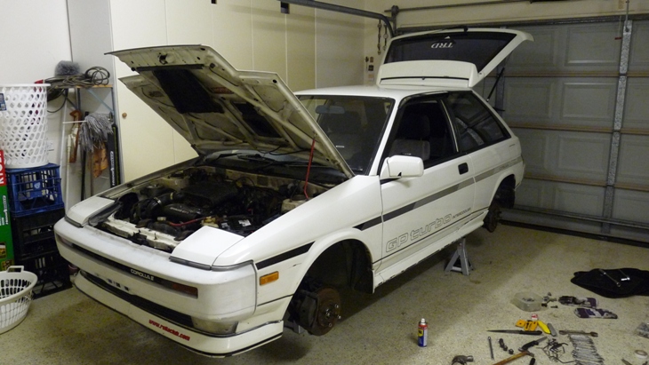

Up on stands, wheels off and ready for some work

Check out the front and rear wheels both off the ground with only one Axle stand in place.

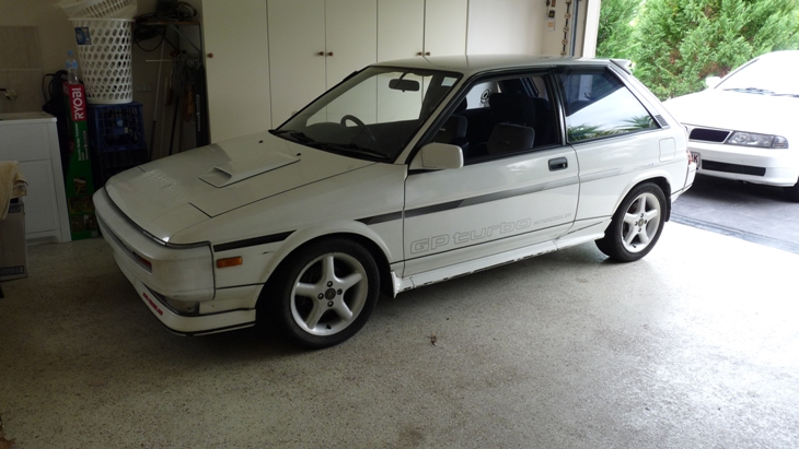

End result, much lower all round and stiffer suspension

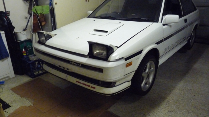

Front bumper off

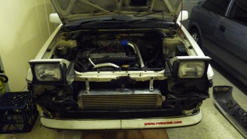

Dummy fitting the intercooler - damn thing is huge but where there is a will there is a way!

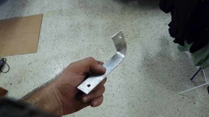

Brackets made out of alloy
Another test fit
Trimmed the bottom radiator support

I made this bottom bracket for the radiator, crazy bend but now the radiator doesn't move at all

Front bar on and everything fits in place
Fits in nicely after the trimming

Last two photos from Part Two - FMIC fitment
Note: longer brackets made to drop the intercooler down so the piping can fit nicely in.
Now all I need is the reducers from 3" to 2.5" and can finally plumb it all up!
