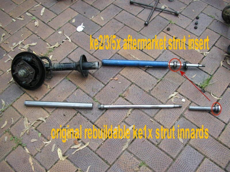

Felix Posted June 3, 2007 Report Posted June 3, 2007 You can replace the strut inserts. Read back over this thread to see how ke2/3/5x aftermarket strut inserts can be fitted into your existing strut housings. :bash: Quote

philbey Posted February 15, 2011 Report Posted February 15, 2011 DIG DIG DIGGING!!! So from what I gleaned in this thread, the Ke20 shock is about 50mm shorter than a KE10 shock.... Is the actual stroke shorter though? Where I'm heading with this is that a shorter stroke shock will get around the non-captive spring issue if I get a custom set of springs made up. Quote
Felix Posted February 15, 2011 Report Posted February 15, 2011 (edited) shock body is 25mm shorter. Piston shaft is 25mm shorter. Overall 50mm shorter. You end up with a reduction of 50mm in droop. Edit: Found the pic I posted earlier in the thread which disappeared. Edited February 15, 2011 by Felix Quote
philbey Posted February 15, 2011 Report Posted February 15, 2011 sweet that's what I was hoping, although couldn't be sure, just because the compressed length is shorter, it might not mean extended length is shorter. This is good news, it means anyone running shorter springs can still remain captive although increase in stiffness and addition of KE20 strut tops may affect it again. Will keep posted, I'll source a set of KE20 inserts now instead of bothering with KE10 ones. Quote
