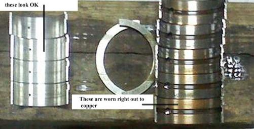

Viterbo Posted November 4, 2015 Author Report Posted November 4, 2015 I was thinking of crankshaft bearings... Having to work my cranck and buy new bearings (around 150€) or buy a new set of lifters (24€+Tax each), don't know what's worse haha Quote
altezzaclub Posted November 5, 2015 Report Posted November 5, 2015 Wouldn't a lifter problem give you an odd tappet gap?? Easy enough to check. Can you push the lifter pistons down against the oil in a 5K?? In my old Armstrong Siddeley you pushed the pushrods right down by levering on the rocker with a big screwdriver, and set the tappet gap to 90thou. When you started it it rattled for a minute then settled down. Any jammed lifter showed up staight away. For bearings you could take the bonnet off, lift the motor and drop the sump for a look. Pain in the arse job, but a little quicker than pulling the whole motor out and stripping it. Quote
TRD ke70 Posted November 5, 2015 Report Posted November 5, 2015 Have you changed the oil filter since the rebuild?engine change. Could be a faulty oil filter. If not, i'd put my money on bearings and worn crank. Quote
Viterbo Posted November 5, 2015 Author Report Posted November 5, 2015 Yes oil filter has been changed. I'll be checking the crank in a few days. Strange thing is this crank worked in my 4K for more than a year with no problems. But maybe the 5K rods and the new bearings didn't adjust as it should.. Quote
