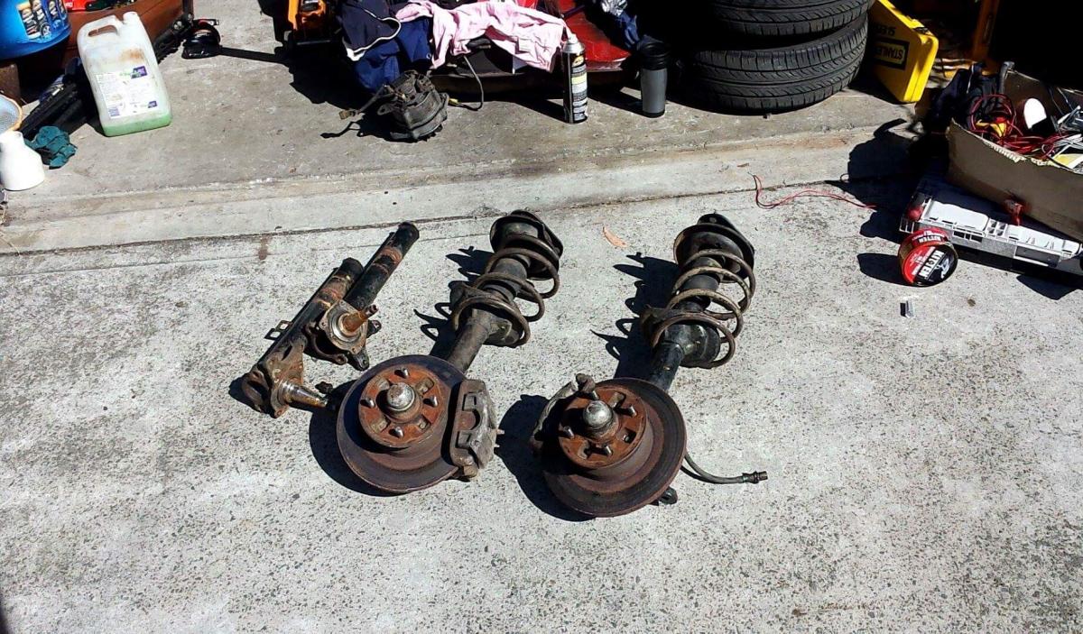

pozza123 Posted March 27, 2016 Author Report Posted March 27, 2016 Picked up some xt130 struts with modified knuckles :D Quote

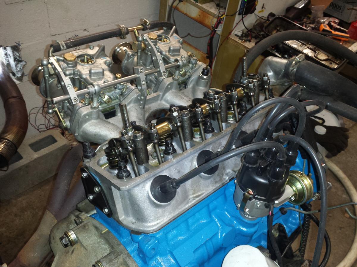

7000rpm Posted March 27, 2016 Report Posted March 27, 2016 This is a pic i took the other day of the 5k on the dyno, Should have her back this week! Pretty happy with the results 115hp at the flywheel :) Mate that is bulk power out of a K series, congrats! Mind sharing with us what work has been done and specs? Quote
pozza123 Posted March 28, 2016 Author Report Posted March 28, 2016 (edited) Mate that is bulk power out of a K series, congrats! Mind sharing with us what work has been done and specs? Cheers man! Yeah I don't mind. So its a 5k with the "O" dish pistons 4k head ported standard valves (hopefully not for long) combustion chambers have been re worked Solid rocker shaft spacers 1gge rods (had these laying about and decided to give them a try, they looked alot stronger than the 4k ones I had) Compression is around 10.5/1 Unsure on cam specs but I think it's around 275 degrees duration on both (doesn't kick in till 3000-3500 rpm) Has been balanced Fuel is supplied by a pair of 40mm dcoe webers Random set of extractors I already had (these will be changed at a latter date) I think that's all might have missed something out Later down the track I'd like to put a bigger cam in and some bigger valves and see what she'll do Edited March 28, 2016 by pozza123 Quote
7000rpm Posted March 28, 2016 Report Posted March 28, 2016 Great thanks for that. I have similar plans to build my 4k, but it's for track use. Do you have a dyno graph available? Quote
pozza123 Posted March 28, 2016 Author Report Posted March 28, 2016 I wish I did! She was an old analogue dyno Quote
7000rpm Posted March 28, 2016 Report Posted March 28, 2016 Be interesting to see your car up against a 4age coverted ke Quote
pozza123 Posted March 28, 2016 Author Report Posted March 28, 2016 I'd give it a fair crack if I ever line up against one haha Quote
