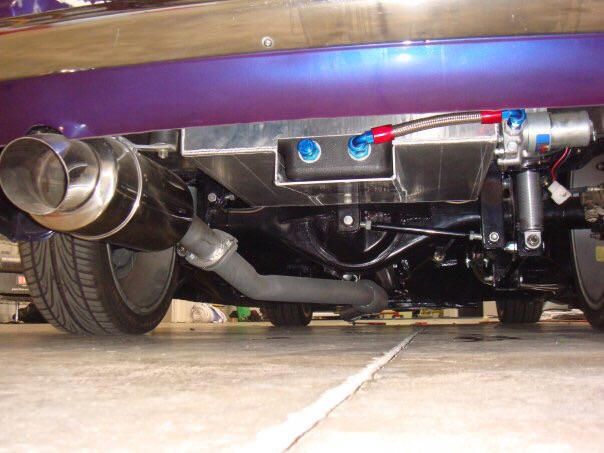

Later on this year i am going to convert my ke25 rear end on coil overs. I was going to remove the leaf springs (i cannot go low as much and is not really neath) and go a set up like this.
But i still haven't get to it but should work. Have to figure out what coils to use for top mount and ride height. The only prob that i am seeing is that the diff will touch the body.

To be honest that was i was going to try first cause its much cheaper and less hassel but I'm not sure i will get the height. But I'm still doing body work on the car after that its time to check that one. The only problem that i am seeing is that the diff will hit the body in the middle maybe i have to arrange the body work that part. Will see
In my case i have 15 inch rims with arches. I cut the body arch so that the tyre will look as flash with the tyre. Mine is going lower than that, If you look closely you will notice that the centre of my rim is almost centrer with the line of the body. The red car rim is a little underneath the line. And mine i think it has to go a little more down. It is just a trial.
