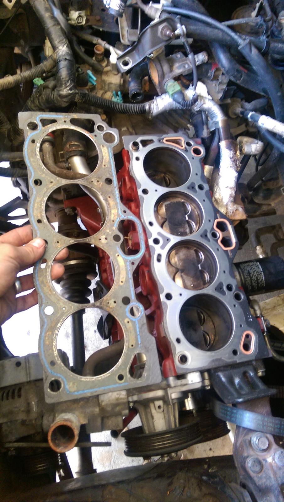

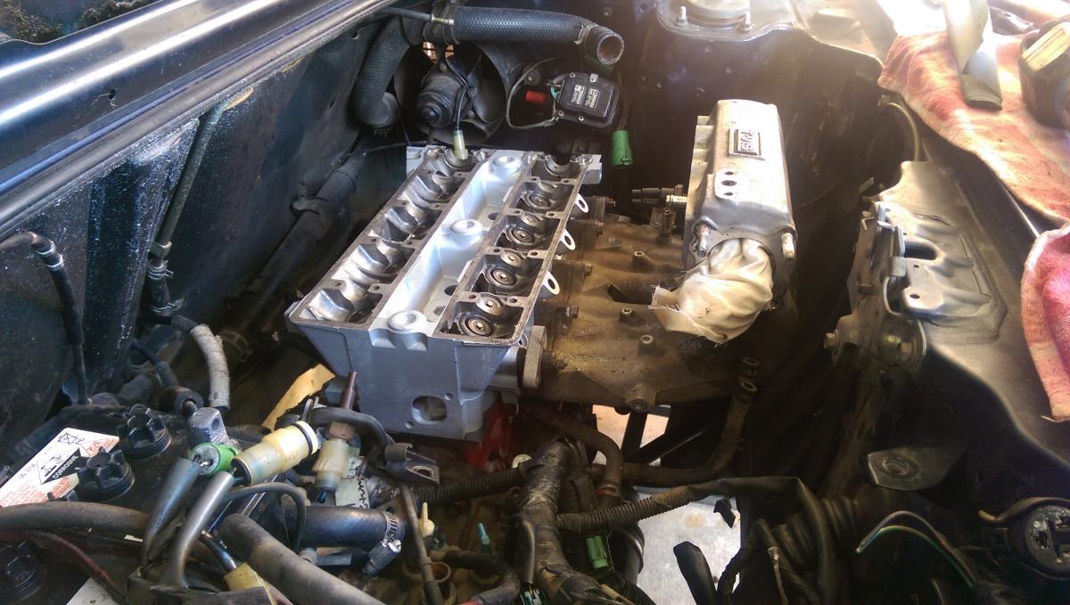

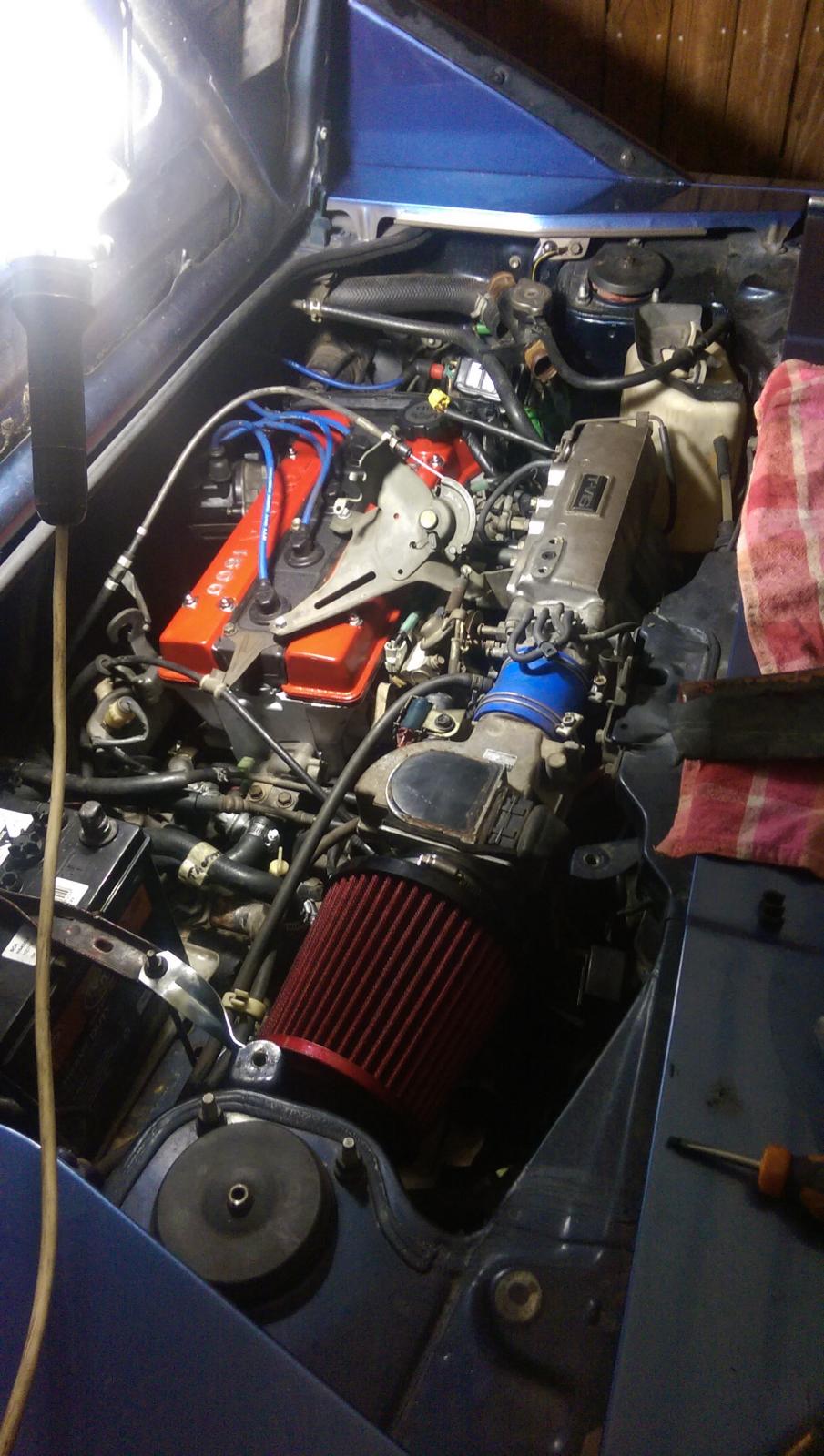

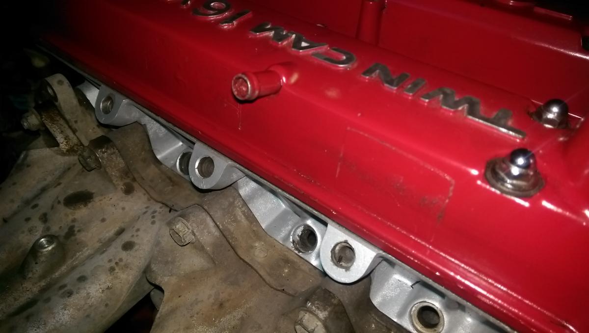

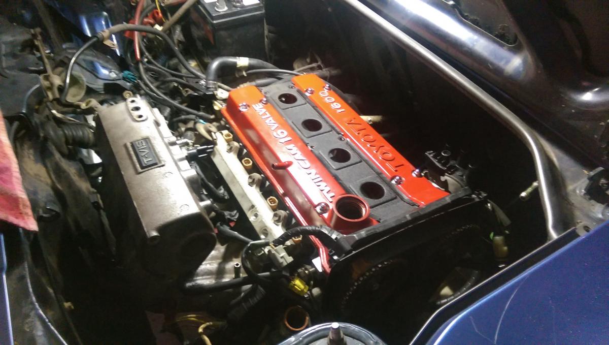

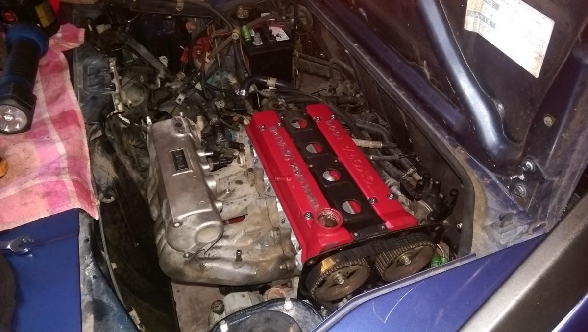

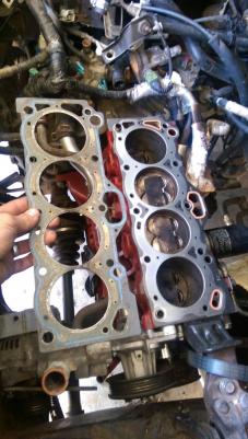

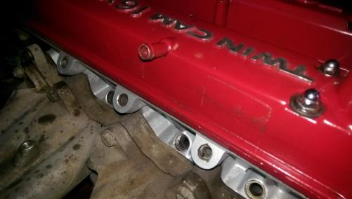

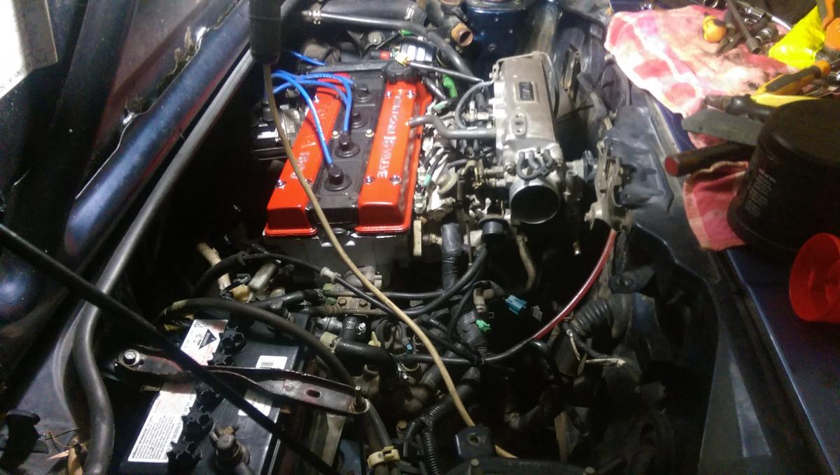

B.L.Z.BUB Posted April 9, 2015 Author Report Posted April 9, 2015 It would stop eventually but I ended up unhooking the battery. Got cracking today. Gasket comparison, theres no comparison to genuine. Yay! Rocker covers painted right over the OEM stickers. I decided to actually use the timing marks unlike the last guy. Slowly getting there. All done, well the engine is done. Still need to bolt on the exhaust, put the radiator and fans back in and clean the pipes out. Went back together pretty easy. Quote

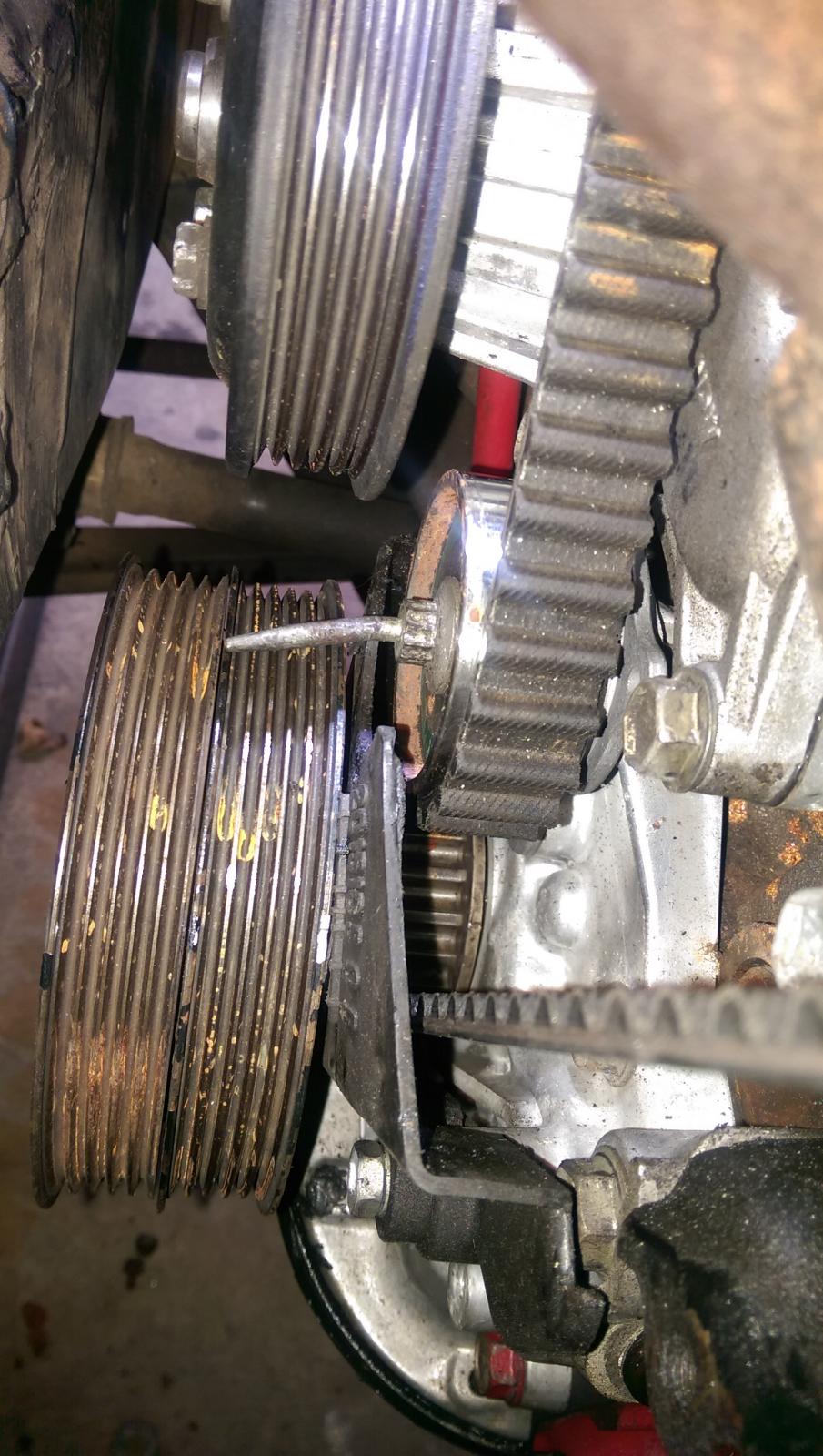

B.L.Z.BUB Posted April 9, 2015 Author Report Posted April 9, 2015 I actually hasn't been to bad to work on. I can't get the timing belt tensioner spring on. Well I probably can, might have another crack tomorrow. Supposedly you can pull out the engine bay fan and get access from the side. Apart from that one area everything else is reasonably accessible, the car isn't too wide that reaching into the middle is a chore. Quote

oldeskewltoy Posted April 9, 2015 Report Posted April 9, 2015 On 4/9/2015 at 11:14 AM, B.L.Z.BUB said: I actually hasn't been to bad to work on. I can't get the timing belt tensioner spring on. Well I probably can, might have another crack tomorrow. Supposedly you can pull out the engine bay fan and get access from the side. Apart from that one area everything else is reasonably accessible, the car isn't too wide that reaching into the middle is a chore. I recommend to NOT use the tensioner spring... its an accident waiting to happen... It is even worse if you have the belt correctly tensioned. Once the timing belt is set to the above spec, I've found that the tensioner spring typically is a bit loose on the mounting pin. With vibration the spring can fall off, and shreds the timing belt. If you have the correct belt tension, and the correct torque on the tensioner bearing, the spring is not needed.... kinda like an appendix. Quote
B.L.Z.BUB Posted April 9, 2015 Author Report Posted April 9, 2015 I only just found out its not a backup spring like I thought. I've always set it like the above pic usually by feel. Never had an issue with the GZE doing it that way so I'll keep doing it like that :) Dave good question, no idea. Assuming manual rack as it feels similar to the ke. Quote
B.L.Z.BUB Posted April 10, 2015 Author Report Posted April 10, 2015 There was a leak from the heater tap. Probably the culprit. Quote

B.L.Z.BUB Posted April 11, 2015 Author Report Posted April 11, 2015 (edited) It was hunting at idle but turned out to be a sensor I forgot to plug back in. Running 100% now. Pretty happy, just need a Rwc now. Bonus picture. Edited April 11, 2015 by B.L.Z.BUB 1 Quote
