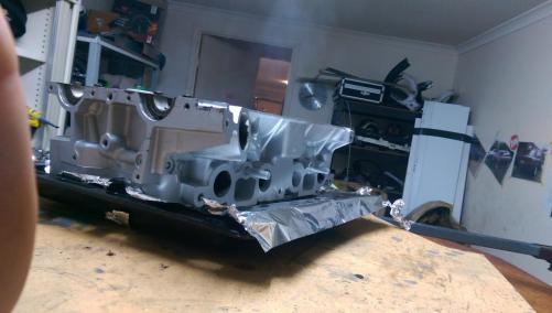

B.L.Z.BUB Posted April 8, 2015 Author Report Posted April 8, 2015 Looks pretty cooked to me. The oven didnt go to 300 so I just maxed it for the final bake. Quote
