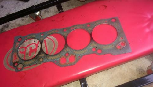

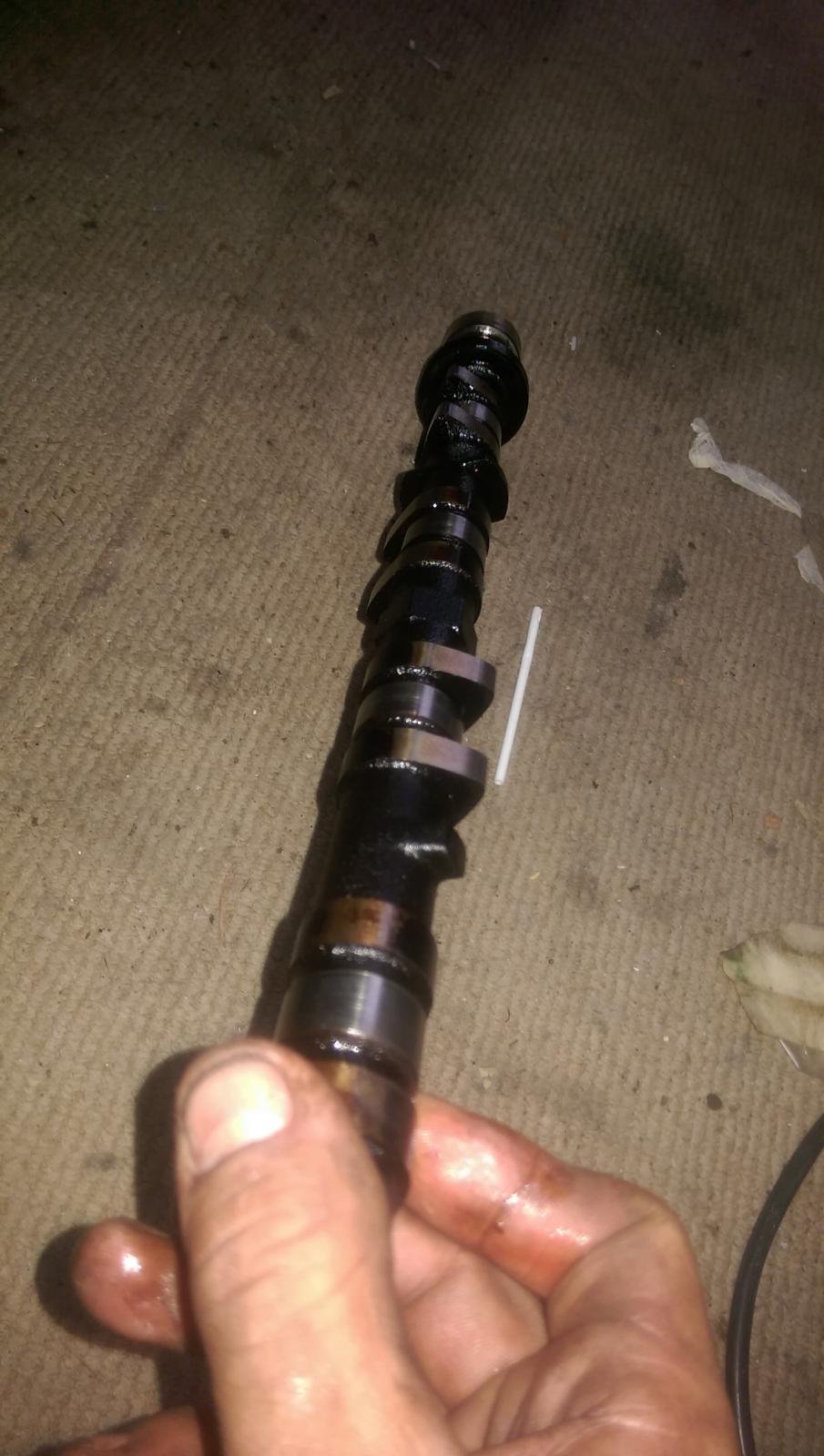

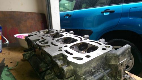

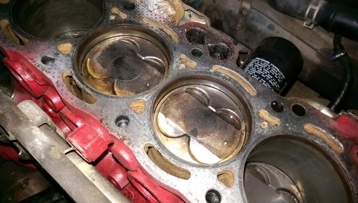

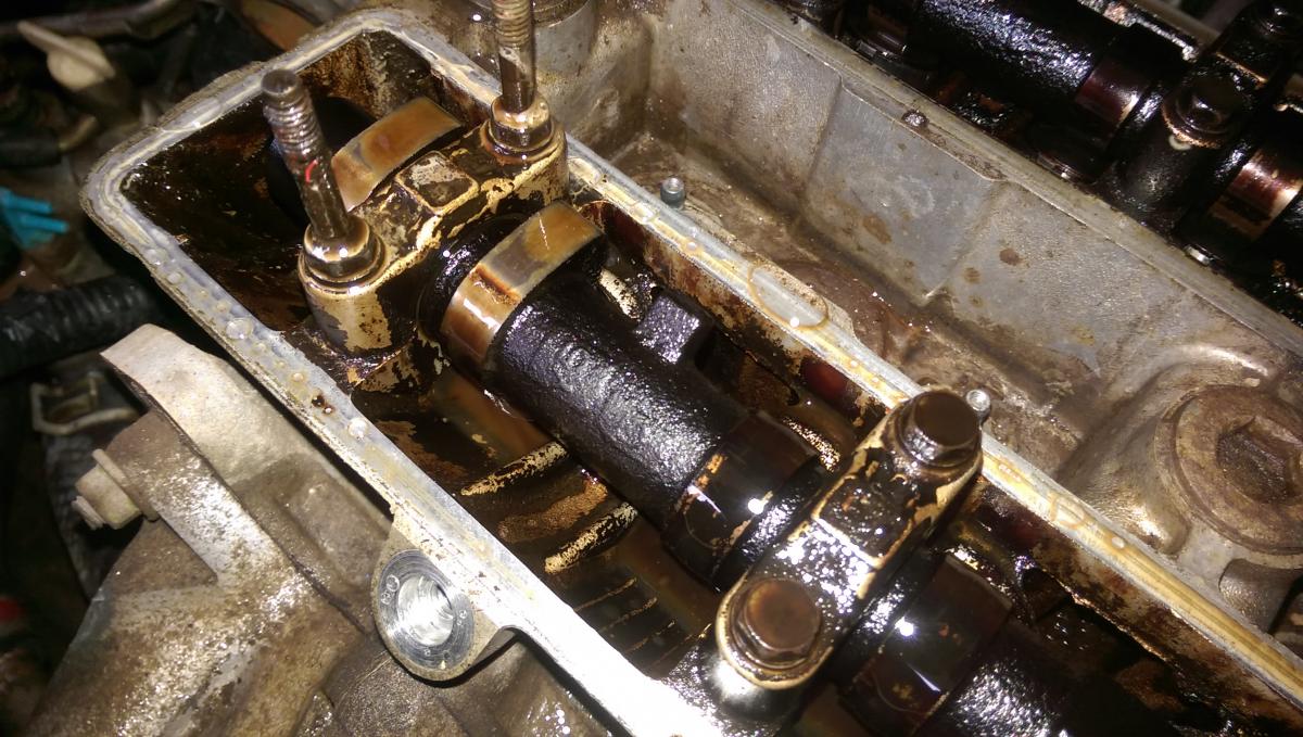

B.L.Z.BUB Posted March 31, 2015 Author Report Posted March 31, 2015 Head is off. The 'genuine' head gasket was some shitty cheap one. The 'cams' are stock. The pistons however are what I was told and are high comp ones. I'm not an expert but the head bolts didnt feel torqued down enough. The head and block arent pitted, warped or cracked. Plus the gasket doesnt have any noticeable blow outs so I'm guessing the head has lifted due to improper torquing? Look I'm, definitely no expert but I'm just happy its all easily repairable. Maybe the HKS cams will make it in from GZE_illa :y: Quote
benhachi Posted March 31, 2015 Report Posted March 31, 2015 Did you get the head crack tested or just visually inspect it? Quote
B.L.Z.BUB Posted March 31, 2015 Author Report Posted March 31, 2015 (edited) Visual. I know it's not the best system but it's all I can afford. Will give it a far more thorough inspection tomorrow. Edited March 31, 2015 by B.L.Z.BUB Quote

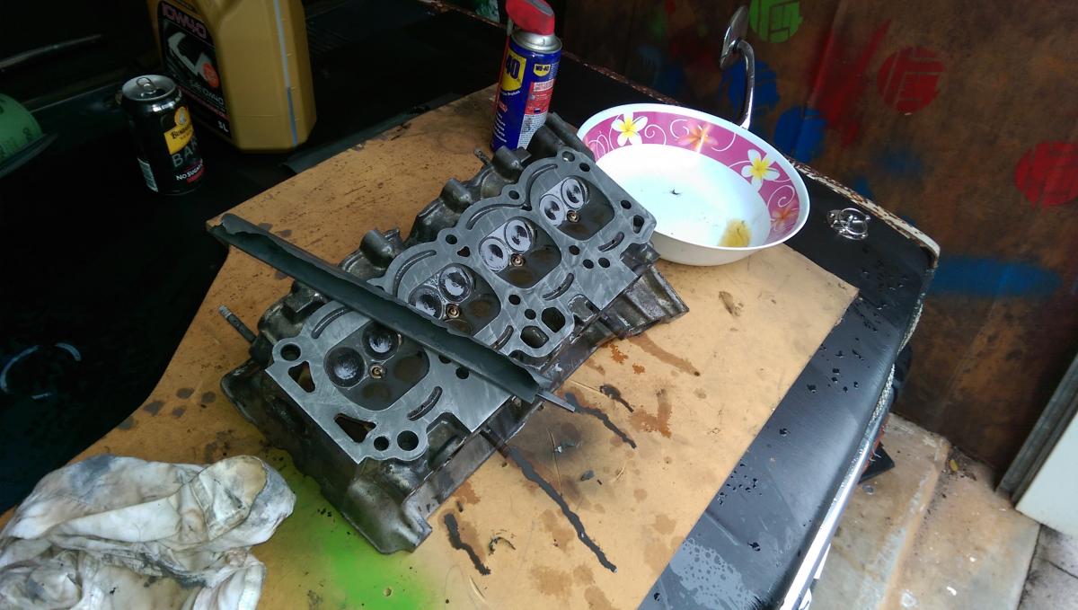

ke70dave Posted March 31, 2015 Report Posted March 31, 2015 How did you check the head for flatness Quote
oldeskewltoy Posted March 31, 2015 Report Posted March 31, 2015 are the washers under the headbolts??? Once you get the head out I'd love to see some photos of the chambers and ports ;) OEM Toyota head gasket seals the best, especially if the block deck has not been machined. Quote
B.L.Z.BUB Posted March 31, 2015 Author Report Posted March 31, 2015 On 3/31/2015 at 1:25 PM, ke70dave said: How did you check the head for flatness Straight edge ruler Quote
LittleRedSpirit Posted March 31, 2015 Report Posted March 31, 2015 Thats a cheesy looking HG. Lying pricks. Quote
B.L.Z.BUB Posted March 31, 2015 Author Report Posted March 31, 2015 Yeah looks like a nasty $30 durapro or something. Quote

ke70dave Posted March 31, 2015 Report Posted March 31, 2015 Whatever head you choose I would really recommend getting it skimmed and crack and pressure tested. Saves so much heartache. Quote

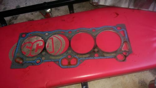

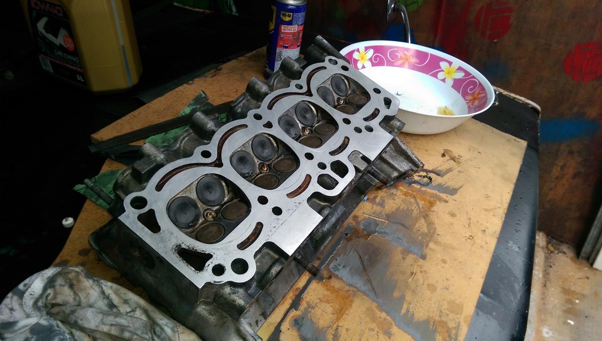

B.L.Z.BUB Posted April 2, 2015 Author Report Posted April 2, 2015 Head bolts turned up but not the gasket so it'll sit for at least another week I'd say. Might give the interior a really good detail and fix the drivers side power window. I also got a whole bush kit with it too so might get stuck into that. I gave the head a bit of a tidy up. At least the pistons look legit. They have STD stamped on them so I'm hoping that means bore and not compression. If anyone can tell what they are by the pics let me know. Quote
oh what a nissan feeling! Posted April 2, 2015 Report Posted April 2, 2015 looking good mate, head cleaned up well, that trick works fine with a composite gasket. Yep std is the bore size. Quote
