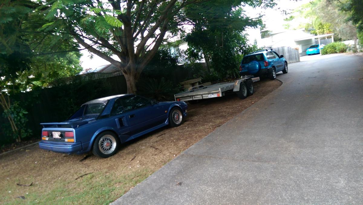

KE70+AE92 Posted March 29, 2015 Report Posted March 29, 2015 And the fun begins!! That sucks so much man!! How far are you away from home? Quote
LittleRedSpirit Posted March 29, 2015 Report Posted March 29, 2015 Sucks mate but its a good way to ascertain whether the other stuff that's supposed to be in the motor is there. Quote
Sznaps Posted March 29, 2015 Report Posted March 29, 2015 did previous owner change hg before? I would suggest going with toyota oem hg they are just very good. Quote
altezzaclub Posted March 29, 2015 Report Posted March 29, 2015 That's no good! You borrowing a corner of some local garage and ripping it apart yourself? Did it back in the 70s when I first came to Aussie, the Beetle blew up on a trip from Canberra to Darwin.... Quote

B.L.Z.BUB Posted March 30, 2015 Author Report Posted March 30, 2015 Supposedly the engine was totally rebuilt which I wouldn't doubt as it drove great and was super responsive for a NA. I'm leaning more towards a cooling system issue. I know they have issues if shit isn't bled properly. It could be as simple as a cooling system that's been used more for urban stuff not up to the task of extended driving. I'll know more soon. We were lucky enough that Sams dad was at our house and grabbed a trailer and came and rescued us. The guy I bought it off has also refunded me $500 to cover trailer hire, racq membership and buying a new gasket and head bolts. He didn't need to do this and I was blown away, great guy 10/10. Quote

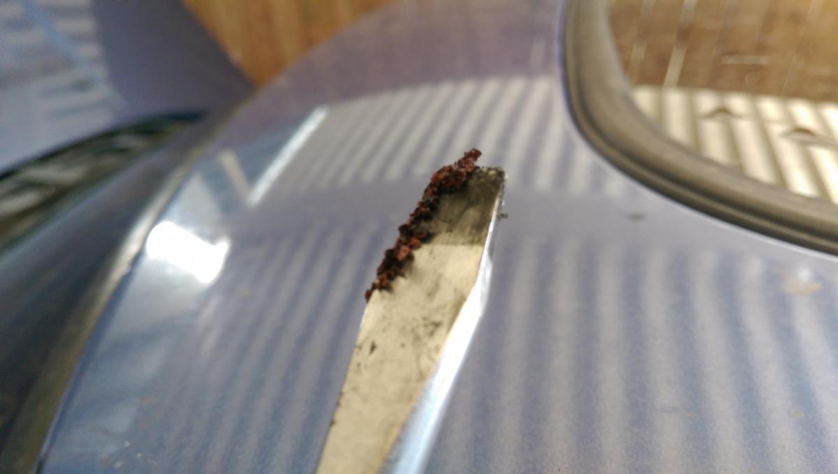

B.L.Z.BUB Posted March 30, 2015 Author Report Posted March 30, 2015 Scraping this off the inside of the rad hoses. Quote
LittleRedSpirit Posted March 30, 2015 Report Posted March 30, 2015 Sounds like it needs a radiator, hoses, thermostat and all the rest. Its worth doing when you buy a nigh on 30 year old car. Sweet car btw. Is that original paint? Quote

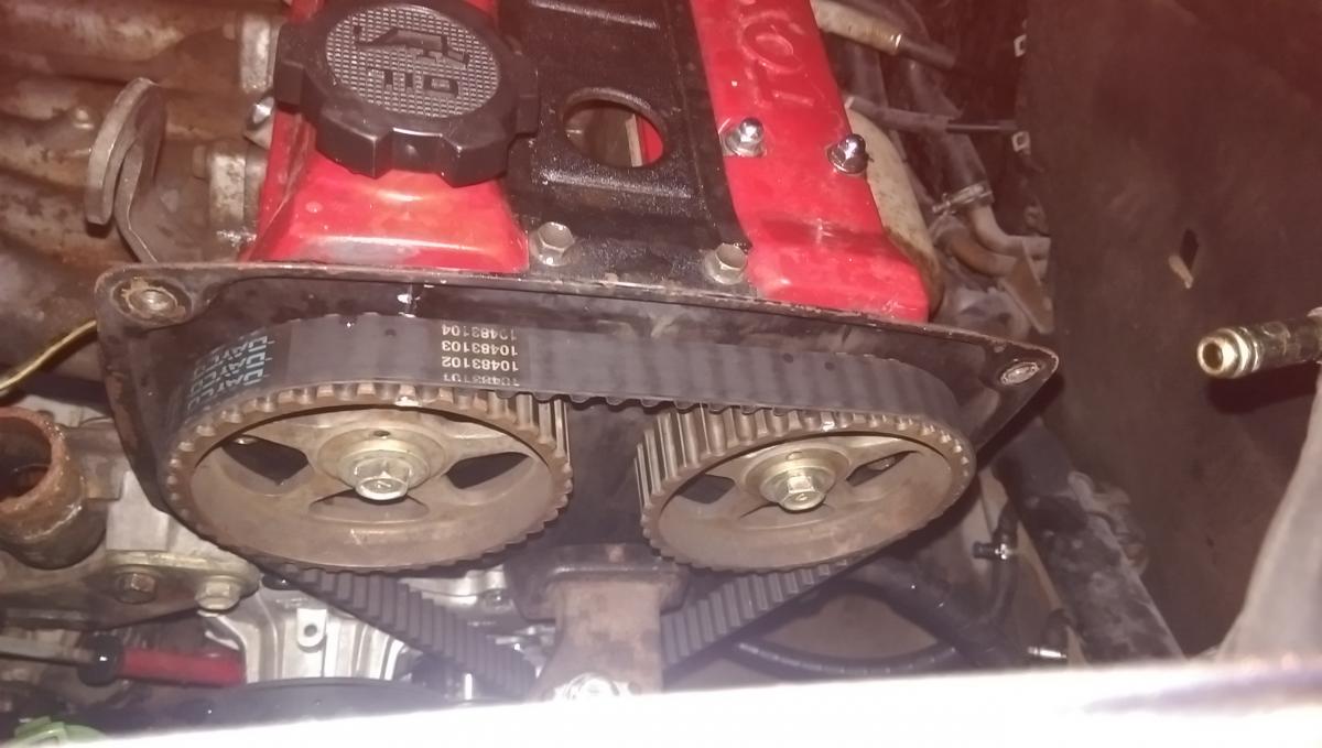

B.L.Z.BUB Posted March 30, 2015 Author Report Posted March 30, 2015 On 3/30/2015 at 7:36 AM, BUZ440 said: Why did you want buy an MR2? Dunno, but glad I did. Exhaust cam out by a tooth. Getting it ready to pull the head off. Quote

B.L.Z.BUB Posted March 30, 2015 Author Report Posted March 30, 2015 Yeah that's my philosophy. I can do an egr delete and tidy up the engine bay as well. Gotta look at the positives. I wanna get something I can feed down the coolant pipes to clean them out. Might see if the local hardware store has something Quote
