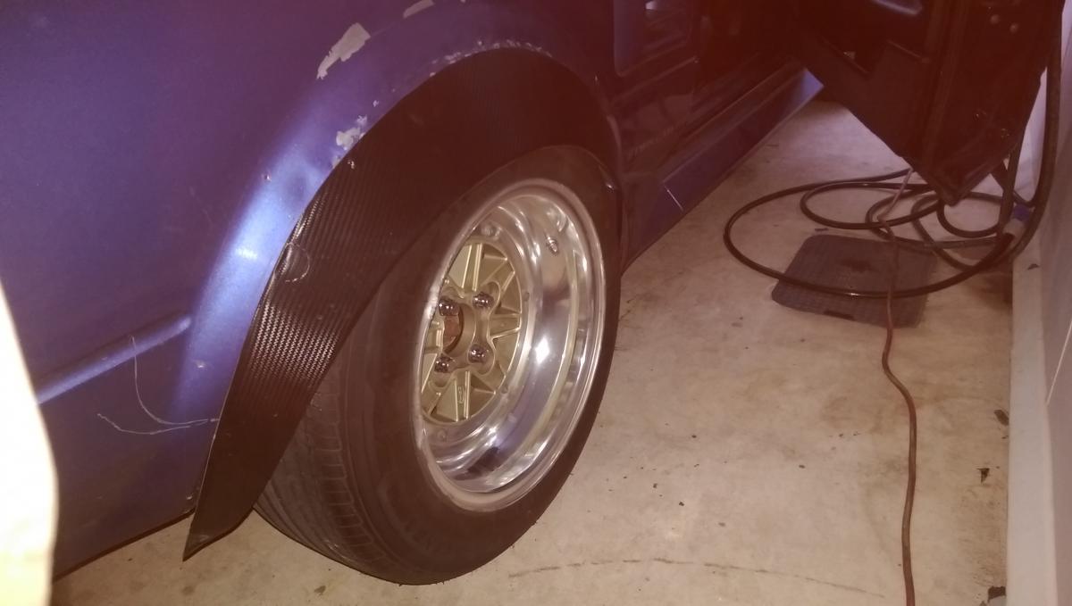

B.L.Z.BUB Posted June 24, 2015 Author Report Posted June 24, 2015 Had a bit of scraping in the rear. Was gonna buy some camber plates then was informed the rear hubs have camber adjustment. JDM as. Quote
