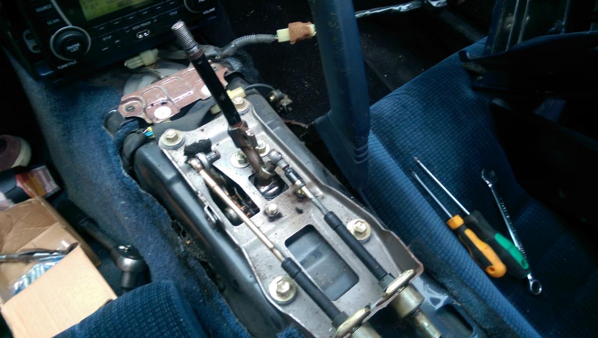

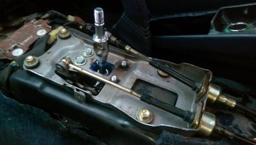

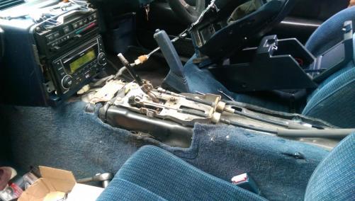

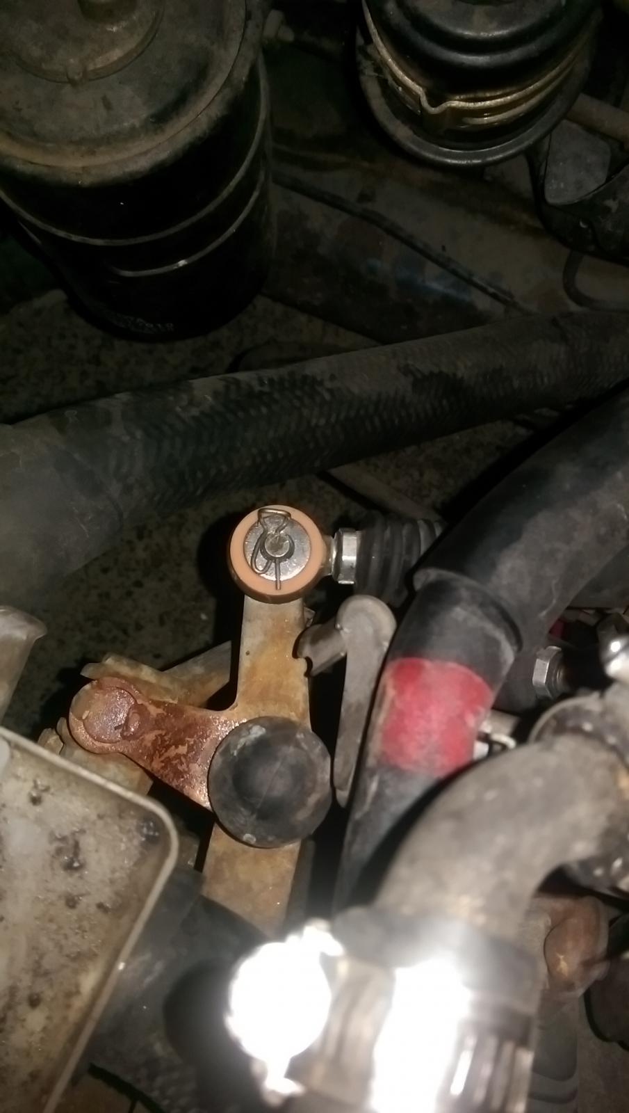

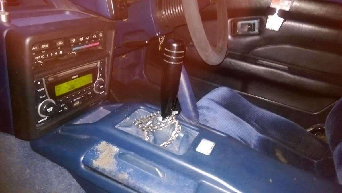

B.L.Z.BUB Posted May 31, 2015 Author Report Posted May 31, 2015 I think you jinxed me. Anyway, decided to do RWC stuff, so I did the shifter instead. Started with this, pretty high when you include my shifter and a LOT of throw. Pulled it all apart , added solid shifter base bushes. Dropped the entire shifter down 10mm or so with a spacer plate and added the short shifter. don't have a before pic but it was at least 100mm higher and like shifting with a hockey stick. And also installed solid gear link bushes. Shits tight yo. Quote

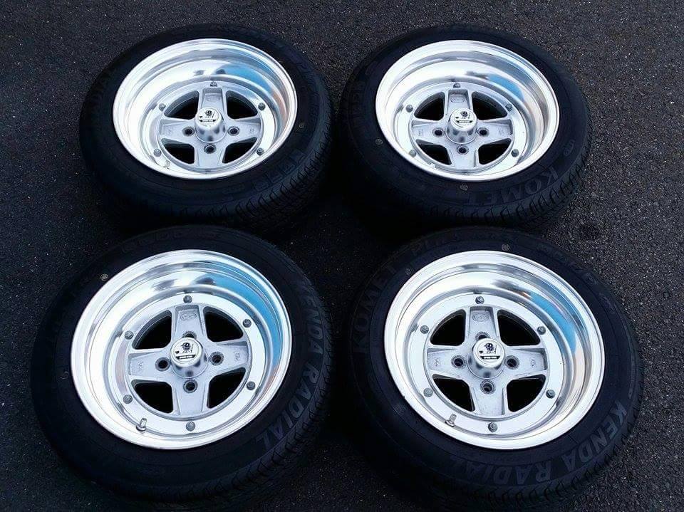

B.L.Z.BUB Posted June 1, 2015 Author Report Posted June 1, 2015 Thanks for jinxing me, those wheels got sold before the KE. :( Quote
B.L.Z.BUB Posted June 1, 2015 Author Report Posted June 1, 2015 Can I say ʞ©$ɟ now? EDIT: Sweet. Quote
B.L.Z.BUB Posted June 2, 2015 Author Report Posted June 2, 2015 Worked out better, found some even cooler wheels. Will need bolt ons though. Quote
