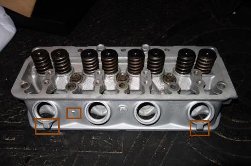

Type of head you want is easily recogniced by lumps under sparkplug 1 and 4

Tor's suggestion is a good one, of just replacing your cracked head with a 5K one. Here is a picture of a 5K head clearly showing the casting "lumps" under no:1 & no:4 sparkplug holes, to look for.
The compression ratio will not be too much different to what you've already got, and after you had the 5K head skimmed, you could always cc it's combustion chambers, and work out the CR. Others on here have cc'd the 4K "D" dished pistons before, & you'll find the cc figures here somewhere. 22cc off memory.
Just make sure you swap over the rocker gear from your old head, and use your original pushrods, as you've got adjustable tappets.

Hi Donald,
All you've got to do is find a 5K head. Used on Toyota vans & petrol Toyota forklifts.
