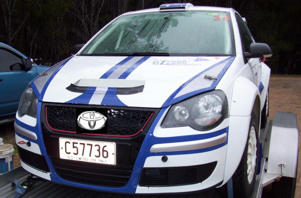

rob323 Posted February 2, 2015 Report Posted February 2, 2015 I'm hoping that the collective brains trust here can assist with a problem of leaking power steering pumps. A friend has imported an RSi Runx rally car from South Africa which has a modified 4age 20 valve motor in it. The previous owner sent over 2 spare power steering pumps cause they would continually blow seals and they could not work out a solution to the problem. Is this a problem with Corollas that have the 2ZZ motor (which would also be revving just as high?) If not, then maybe I'll try to get one and see if that will fit on the car. I'm assuming (just a guess at the moment), that the high revs makes the pump run at too high a pressure and that is what is causing the seals to blow. 10 kms yesterday at an autocross track with revs between 5000 and 7500 was enough to make a pump fail. Another possible solution might be to get an underdrive pulley machined up to help reduce the pressure (or are they readily available?), or does anyone know if the pressure relief valves in the pumps be modified? There is a rally in 2 weeks time which we hope to enter the car in, but it will be a short event if it spits the seals from another pump as quickly as it did at the autocross track. Cheers, Rob. Quote
rian Posted February 2, 2015 Report Posted February 2, 2015 (edited) Isn't that a 1ZZ in the picture? Edited February 2, 2015 by rian Quote
rob323 Posted February 2, 2015 Author Report Posted February 2, 2015 That would explain why it goes so bloody well if it is. I'm trying to get hold of the engine number to find out for sure. Quote
rob323 Posted February 2, 2015 Author Report Posted February 2, 2015 (edited) Bugger, all he has given me for the engine number is V0110486711. Chassis number AAPV0110650486711. He is positive it is a 1600cc motor, and it has what looks like a C56 gearbox (5 speed) attached to it. I'll see if the owner can pull the engine number off the block instead of what's on the paperwork. I wonder if they got some freaky 1.6 litre motor over in South Africa that we haven't seen here? Edited February 2, 2015 by rob323 Quote
ke70dave Posted February 2, 2015 Report Posted February 2, 2015 Google images certainly suggests that is a 1zz and it certainly isnt a 20v Maybe it has 20v quad throttles adapted? Looks like a pretty damn fun car though. Got any more pics or videos for my own curiosity? Quote
rob323 Posted February 2, 2015 Author Report Posted February 2, 2015 (edited) Righto, I reckon the engine is a 3zz-fe, 16 valve, but modified with quad throttle bodies and who knows what else. Goes like a cut snake and the rev limit is set up around 8000-9000 rpm. Edited February 3, 2015 by rob323 Quote

rob323 Posted February 4, 2015 Author Report Posted February 4, 2015 Love the photoshop! I might pinch one of his vw motorsport power steering pumps to put on the Runx though. We know they can handle 9000 rpm (and the odd trip to 11 000 rpm). What are your thoughts though. I don't think the standard 3zz motor was ever meant to rev this high and the power steering pump was probably geared accordingly. I'm trying to find a meaningful chassis number on the car so i can see what other models might share the same pump. Quote
