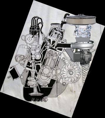

If you want low to midrange grunt & don't want to spend a lot go with a C12A turbo but an original ceramic unmodified one as the rebuilt steel wheel turbo's are heavier & definitely laggier to drive on a 1J & so would be the same on a 4K & as you are not talking about using some 8K rev range would be more than fine, even ceramic turbo's in the 1J are good for around 7K RPM ..
