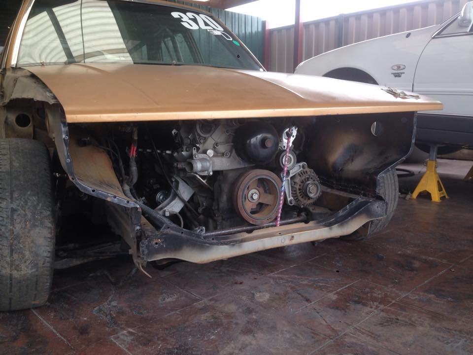

Over a few drinks at said mates work shop n spied this in the corner neglected as he had just bought a fully prepped KE70 LS1 powered drift car.

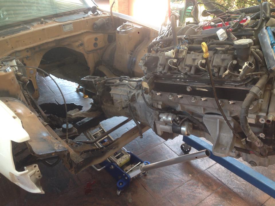

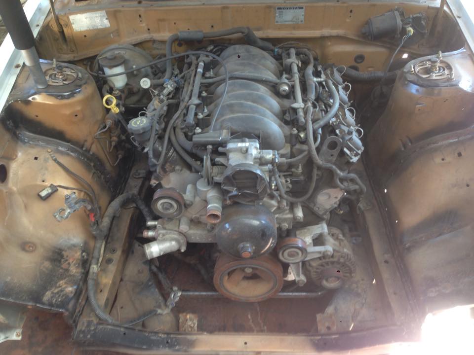

Sooooooo then I pulled out the LS1/ T56 and sold them to a mate asap. LS1 is a great engine but in a car this light is severely over kill and plus I already had a full drive line for a turbo V6 ready to go in.

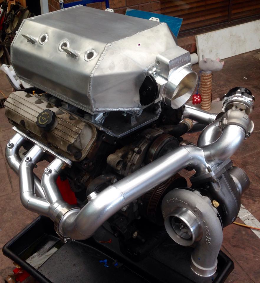

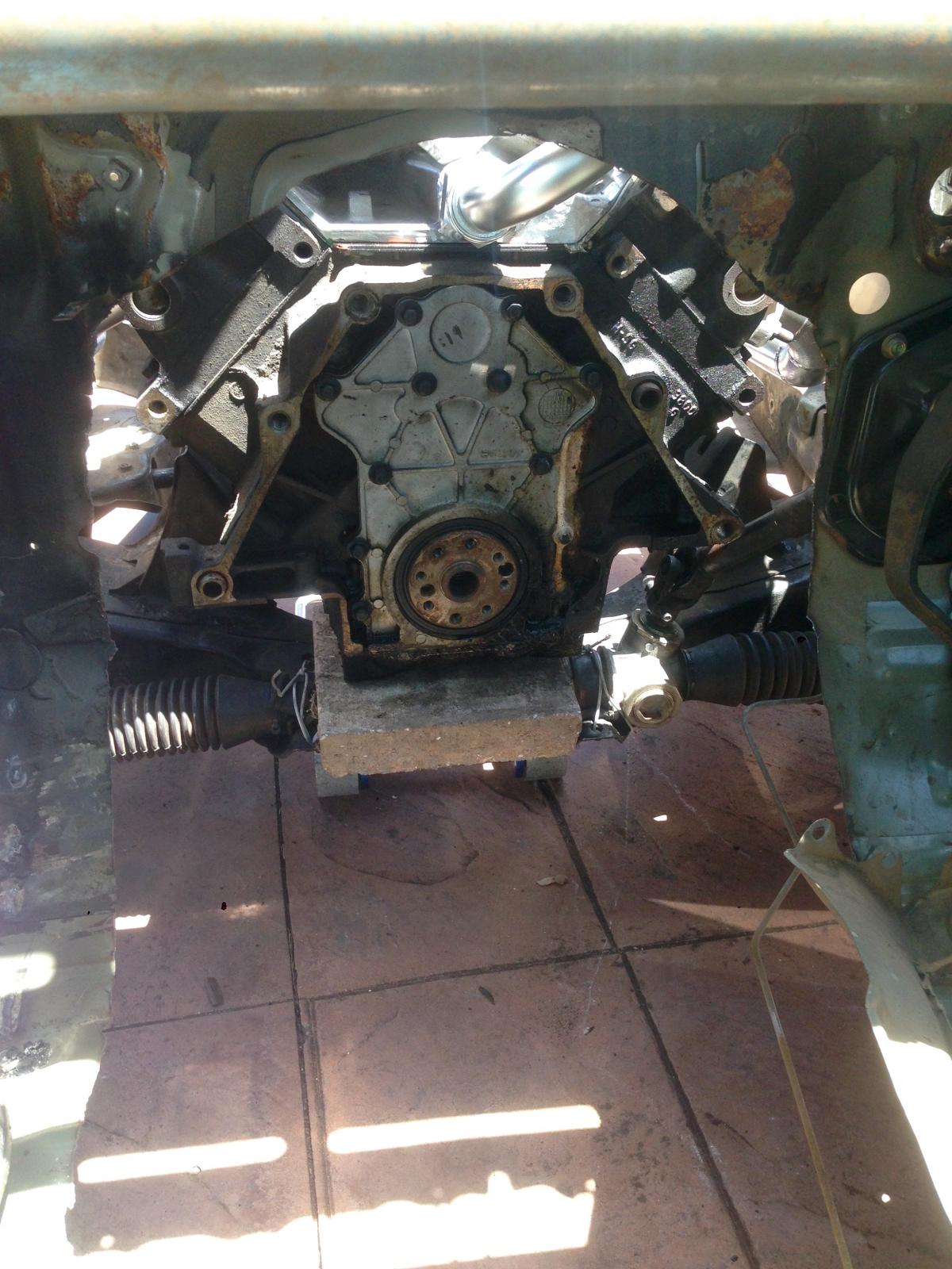

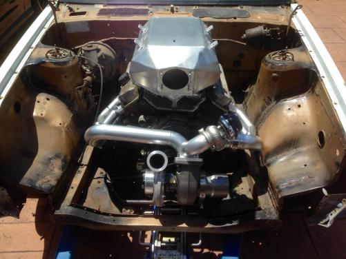

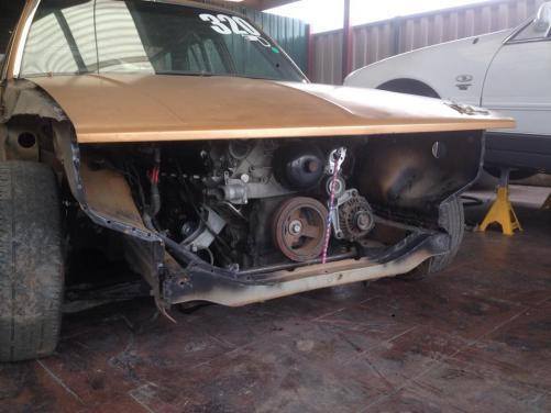

At the stage of mock up now and need to get it back a bit further (15cm between bunky plenum and firewall) and a tad lower too as there's a chance it doesn't need a bonnet scoop. Once a good mock position is achieved I'll set about making some mounts.

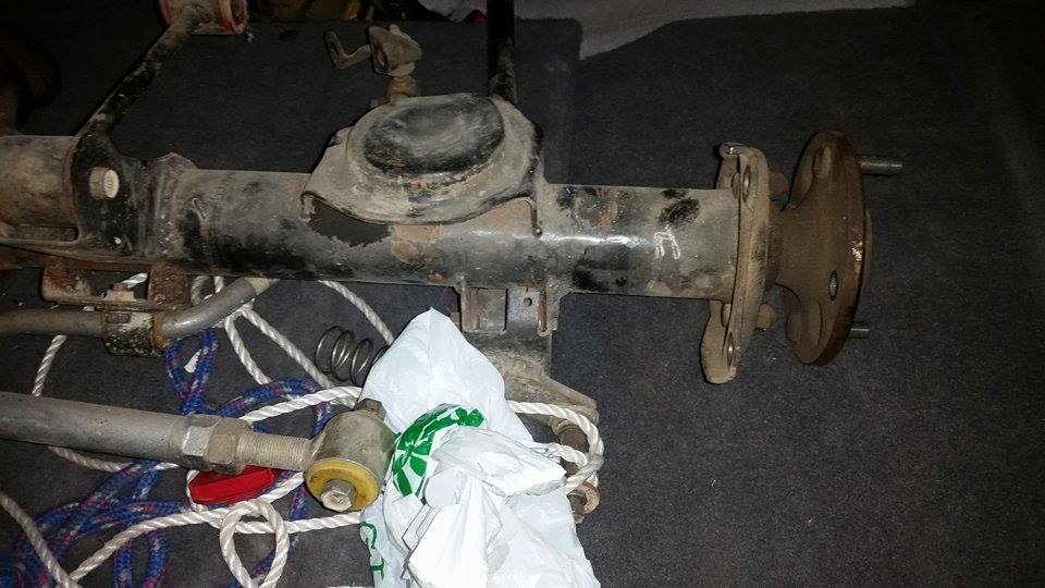

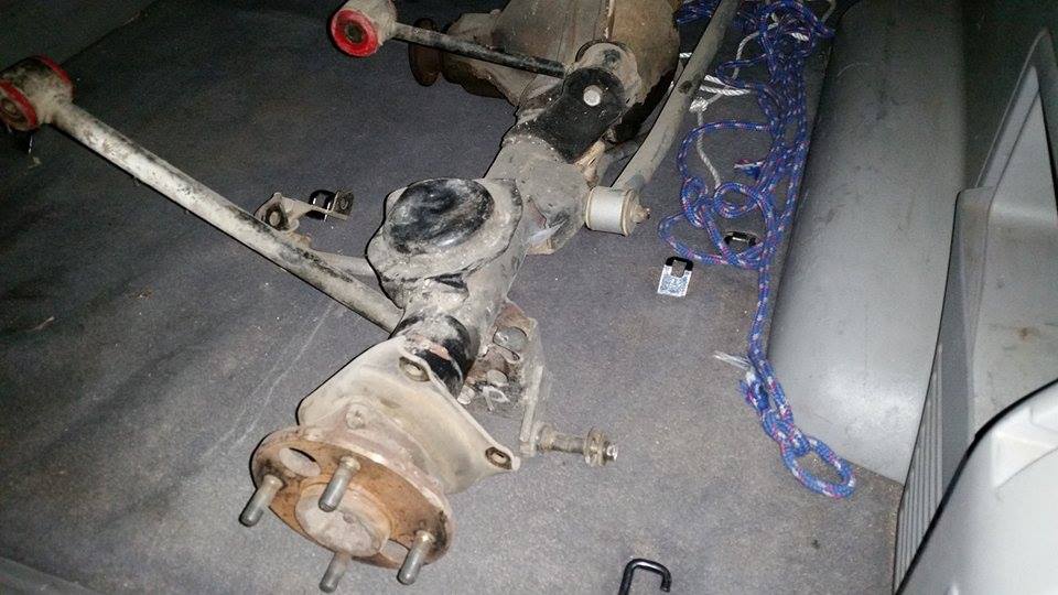

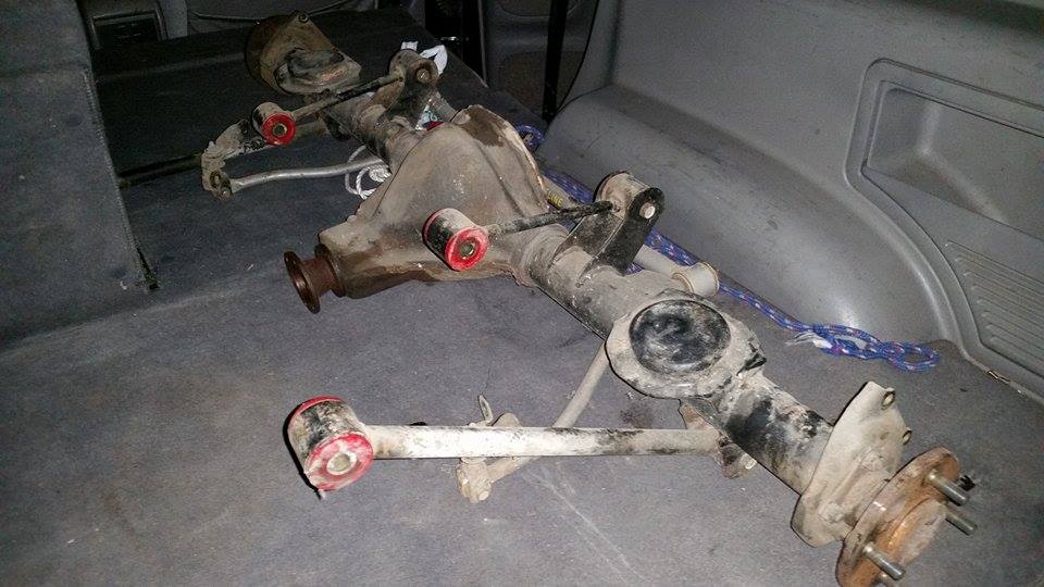

After help from a few good people on here I decided on fitting an R31 diff to handle the torque. Unbelievably the next day after realizing what was needed the exact thing I was looking for came up for sale albeit in another state.............where luckily a mate that is a helpful sort happily drove the 3 hour round trip to pick up for me :) Winning!
This diff has already been converted to KE70 arm pick up points and only needs some brakes and prolly a freshen up but for $300 no complaining

Cheap diff! Is it lsd?
Yeah hope to sell the whiteline bits off as I've already ordered T3 solid mount everything. I haven't got the diff at mine yet as my mate is bringing it over from Radelaide to Melbs next week, not sure if it's LSD but guessing it's a cig special lol. Looking for a kaaz centre though and different gear ratio as it's currently 4.11:1. not the best for a turbo car of this weight

That diff needs a pinion seal pronto!
Sweet project though
Hell yeah lol. I'll do bearings n full over haul before I track it. Who knows what living hell it's been through in this guys drift car

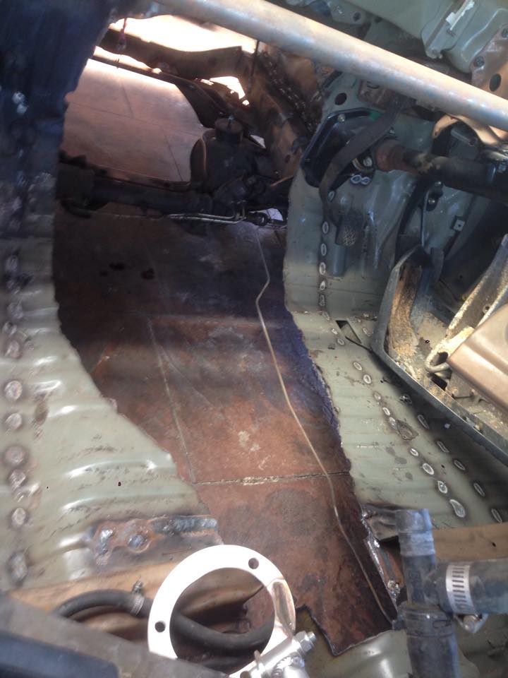

The boxes are part of an equal 4 link kit where you cut the floor pan to replace the shorter top link bars. This is to correct pinion angle and aid traction. Big learning curves ahead but the kit is well though out so should go together ok with a bit of planning on my part

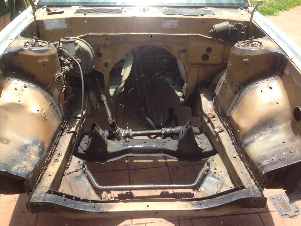

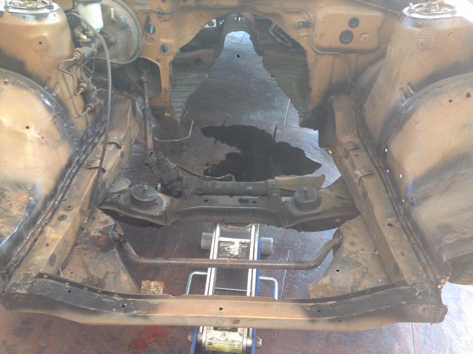

Turbo pipes have been dropped off to HPC and still needing to sort something out for engine fitment regarding the oil sump fouling the cross member. Leaning more and more towards doing a tube cross member
