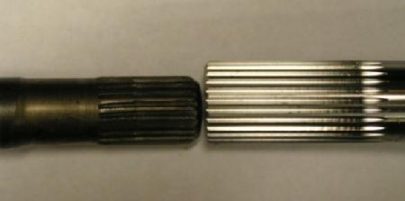

oldeskewltoy Posted December 12, 2014 Report Posted December 12, 2014 (edited) could you shed some light on T series plz? Billet axles are definitely not out of the question and trying to keep unsprung weight down as well so a Hi Lux diff will be a good option but I think last resort Your KE70's axle code is most likely an "S" code... note the bottom line, far left "c/tr/a/tm" = color, trim, axle, trans. My axle code is S374. You can look up axle codes here - http://www.celica-gt...tial_codes.html The "S" code ring (crown) gear is 6.38" and is the predominant axle size in most E7 models (some 2TG powered GT models) were available with the larger "T" 6.7" ring(crown) gear, ALSO the AE86 GTS (Corolla model after the E7) came through with a "T" axle, and disc brakes Here I'm swapping in a "T" assembly for the original "S" unit - seen on the ground. The "T" housing/ring(crown) gear/assembly is the unit Weir Performance built their axle kit for....... Edited December 12, 2014 by oldeskewltoy Quote

batmo Posted December 13, 2014 Author Report Posted December 13, 2014 Your KE70's axle code is most likely an "S" code... note the bottom line, far left "c/tr/a/tm" = color, trim, axle, trans. My axle code is S374. You can look up axle codes here - http://www.celica-gt...tial_codes.html The "S" code ring (crown) gear is 6.38" and is the predominant axle size in most E7 models (some 2TG powered GT models) were available with the larger "T" 6.7" ring(crown) gear, ALSO the AE86 GTS (Corolla model after the E7) came through with a "T" axle, and disc brakes Here I'm swapping in a "T" assembly for the original "S" unit - seen on the ground. The "T" housing/ring(crown) gear/assembly is the unit Weir Performance built their axle kit for....... Awesome info there. Appreciated! Quote
