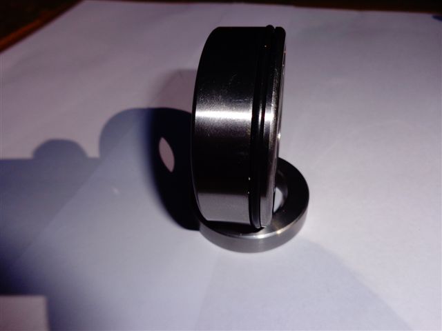

Ordered a new set of good "Japanese" brand "sealed" rear wheel bearings, but not sure which way they go on ?
The bearings are 62mm OD x 21mm wide, with 29.8mm bore.

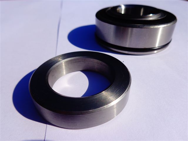

The bearing itself has an inbuilt "O" ring seal in the outer circumference, as depicted below.
My logic tells me the "O" ring side of the bearing would face the hub/outer, so that when you pressed the bearing into the diff casing, the "O" ring would have minimum distance to travel or slide, and therefore have less potential to be damaged.
However, the centre part of the bearing is flush with the outer on one side, and sticks out 3mm on the other side. The side where inner & outer are flush is the side the "O" ring is on. (see pictures above)
All the KE rear wheel bearings I have used previously, have been reversible, as the inner boss stuck out the same amount on both sides.

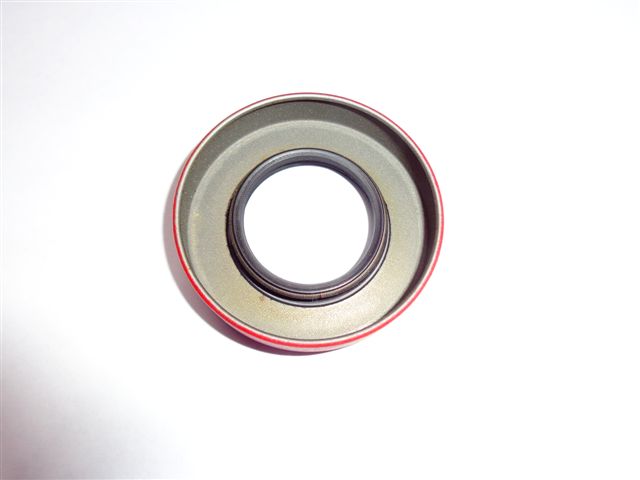

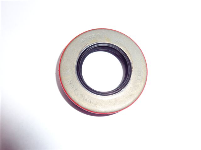

The bearing kit also came with a conventional oil seal.
post-270-0-88528400-1413759358_thumb.jpg post-270-0-00388500-1413759378_thumb.jpg
I've changed a few rear wheel bearings on KEs over the years, although the last one was quite a few years ago. I can't remember ever having to replace an oil seal in the diff assembly.

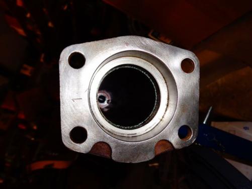

I had a look with a torch and there is no where for it to be fitted.
There is no where on the axle for the oil seal to make contact, as after the machined section for bearing & locking collar, the shaft is "rough"
I did look the catalogue up, & found this bearing set suited other vehicles & makes beside the Corolla. I assume the oil seal is for some other vehicle application, and therefore no applicable when used on the Corolla.

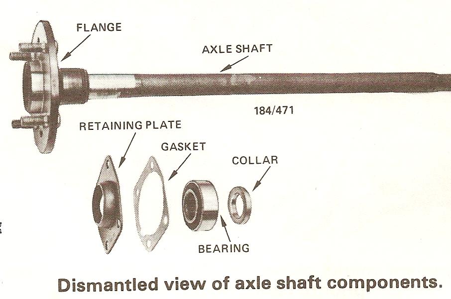

I've noticed on searching this forum, that some have made reference to a seal, but what they were really referring to was the gasket between brake backing plate & retaining plate in exploded view above.

Think I have solved the riddle ! I think the rubber "O" ring was a later development from bearing manufacturers. These are a sealed bearing, so normally no diff oil will get through to the outside & into the rear brake area. The interference & step at the back of the casing, (to butt the bearing up against), would normally prevent oil seepage. I think the "O" ring is probably a backup.

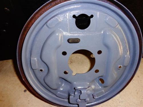

If however some oil got past the bearing, the retaining plate was designed to collect it. It has a little recessed section at the bottom which funnels any seepage out through the backing plate and onto the road, away from the brake linings. See the little cutout in the backing plate on the bearing centre round hole, and matching cutouts on the flange.
I remembered I had an old Ke55 rear axle in the shed, I have used in the past as a slide hammer, to remove stubborn axles. Luckily, it still had the original bearing on it. The bearing did not have the "O" ring. It did have a 3mm extension of the centre section of the bearing on one side only. That extension was facing towards the hub.
My assumption that the "O" ring would be the last part of the bearing to be pressed into the diff casing was wrong. With the 3mm boss towards the hub, the "O" ring would go in first.
I'll get the new bearing pressed on in the next day or so, and "fingers crossed" it will all work out OK.

My past experience is the "O" ring faces outwards. Entirely up to you, but I put a smear of sealant over the "O" ring and outer bearing surface just to give it that extra piece of mind and as a backup, For that "Just incase I pinch the O ring while putting it back in" scenario,
cheers!
Humm ! That's the way I would have done it, with the "O" ring facing out, but if I do it that way, the 3mm extension on the bearing inner boss will be facing in, not out, as I've determined it should be.
