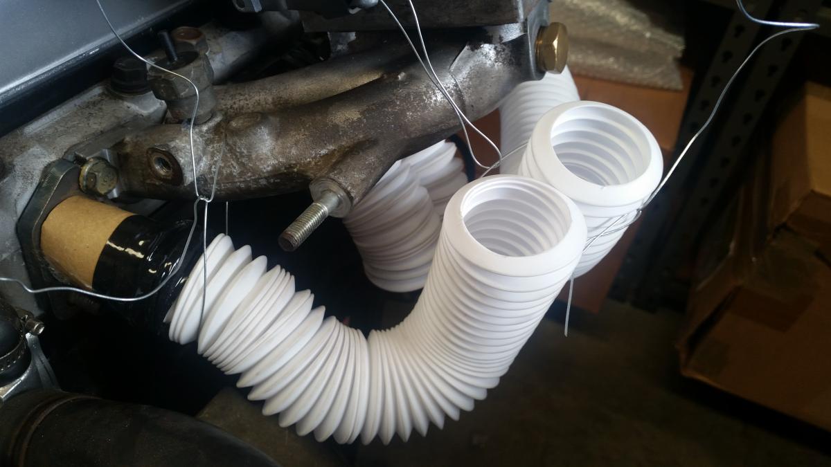

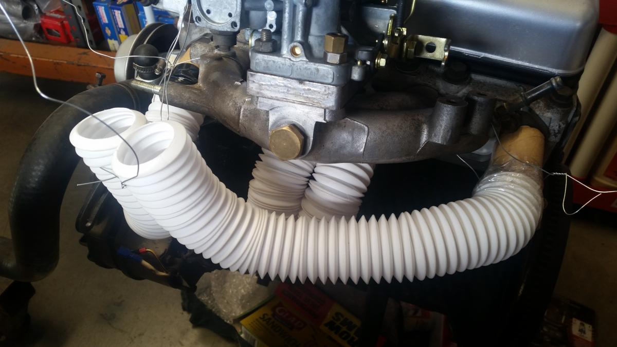

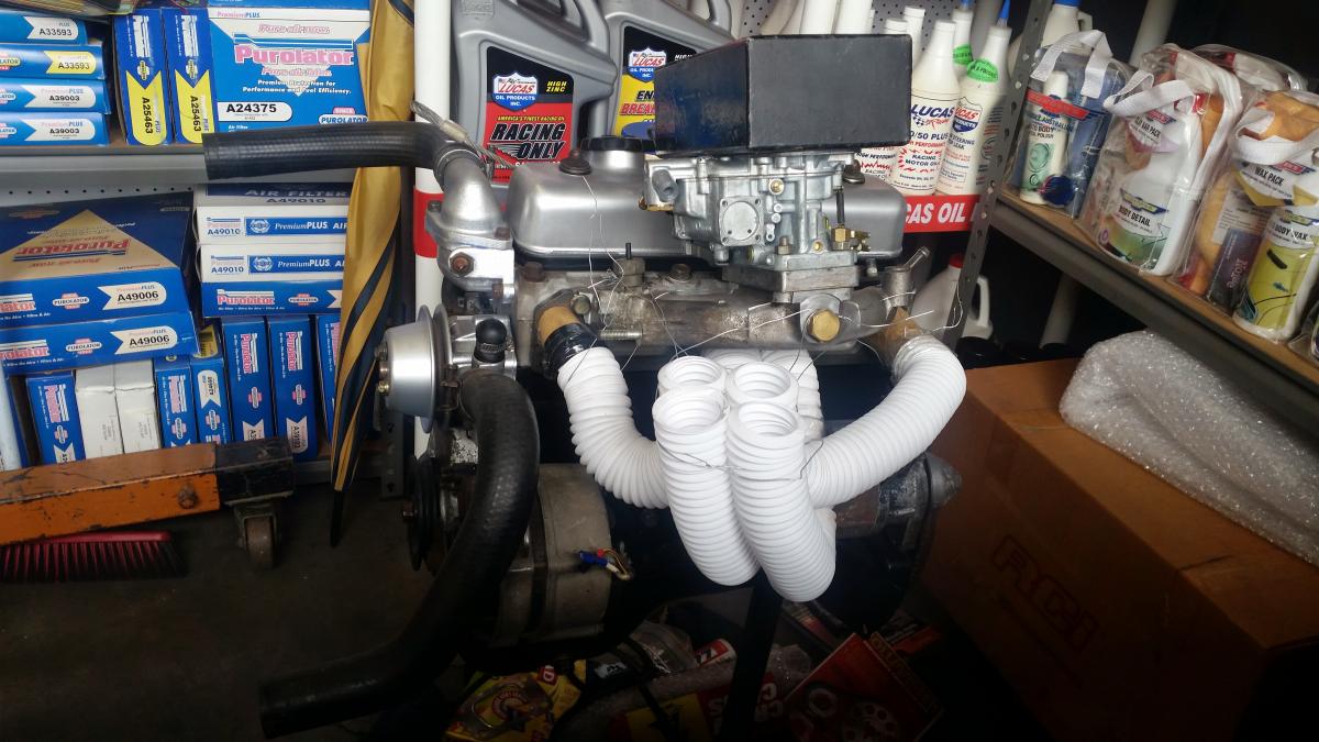

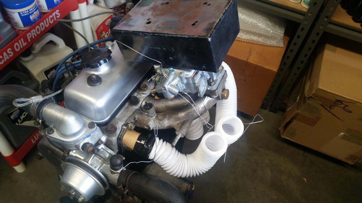

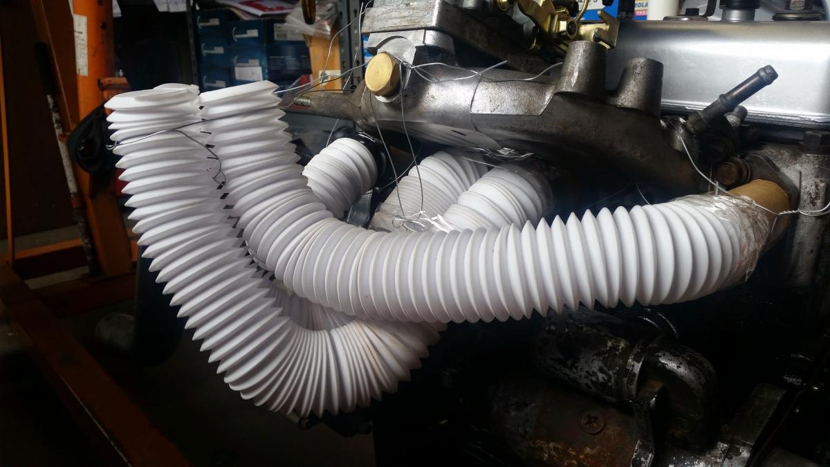

Today i stared to mock up the exhaust manifold pipes to the turbo. now before you all laugh yes its plastic pipes and cardboard once I have it where i want I will take it to the exhaust shop and get them to make it up for me.
Ok I have done the other 2 pipes now.

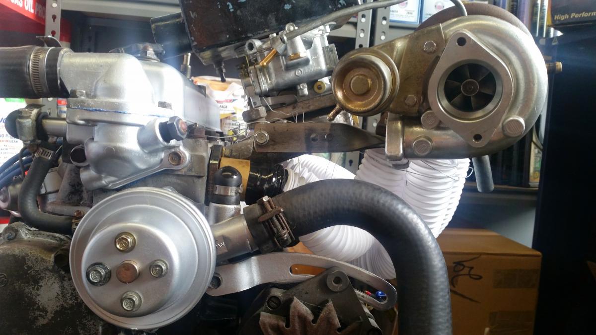

and made a bracket to hold the turbo (for mounting reasons only)
I will now take the turbo and bracket to the car with engine still in there to make sure it fits.
I have a feeling looking at it however it wont fit and will have to make adjustments but that is ok.

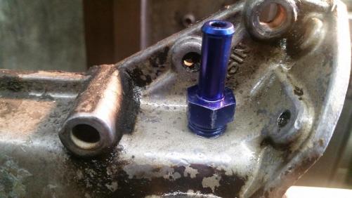

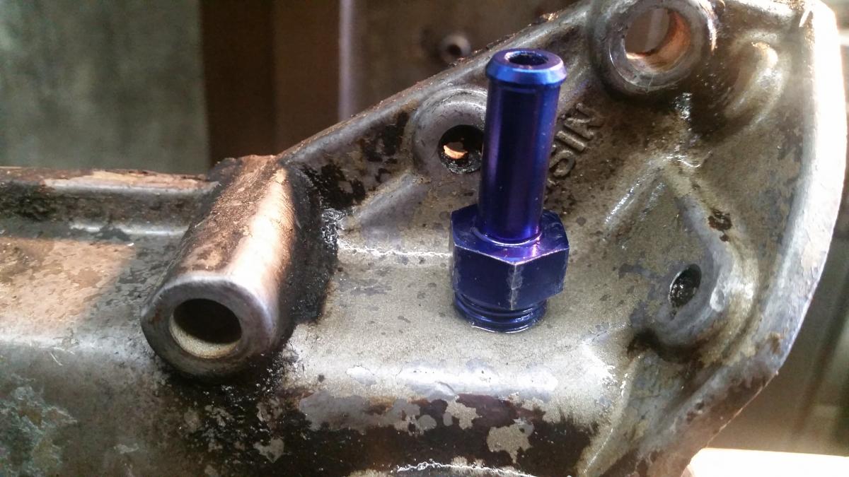

I have also drilled and tapped in the oil return line into the timing chain cover. I think this will work nicely.
Hey mate, just a tip - When you get the manifold made up make sure you keep access to the manifold bolts with a socket and extension as you can with stock manifolds. I can't get to the one next to ex port #3 like that, its a bitch and I have to remove the starter motor to give me room to spin a spanner on it.
Cheers mate yeah that will be the plan.
I also tried fitting to the car and the turbo hits the strut I need to move it further forward and up a little higher that is today's task :)
