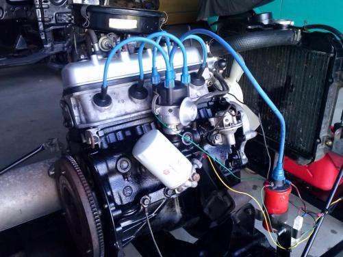

KE70PWR Posted July 27, 2014 Report Posted July 27, 2014 Hi all thought I would start a bit of a thread here with my rolla. I bought the rolla about 5 years ago now and had been driving as a daily until i had a work car so started to do some work on her. I pulled the motor out and did a rebuild myself (lots of learning). Tried various combinations of carbs from stock to weber also tried twin SU's worked great but my cam was to lumpy so did not work so well at idle. Anyway moved to Sydney and the car stayed here in QLD and unfortunately had to be stored outside and very quickly grew rust and was not quite the same. However I have now moved back to QLD and have decided to get it back on the road and make a project out of it. I am going to keep the k motor but make it a turbo blow through set up. Quote

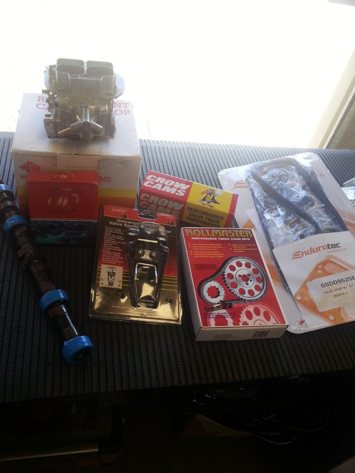

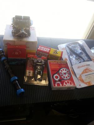

KE70PWR Posted July 27, 2014 Author Report Posted July 27, 2014 (edited) Parts have started to arrive. custom cam regrind "tighe cams" 104 for the exhaust and 112 on inlet Double valve springs "Crow cams" Rollmaster timing chain and gears. new weber 32/36 carby. Various other turbo bits fuel pump and boost tee. Edited July 31, 2014 by KE70PWR Quote

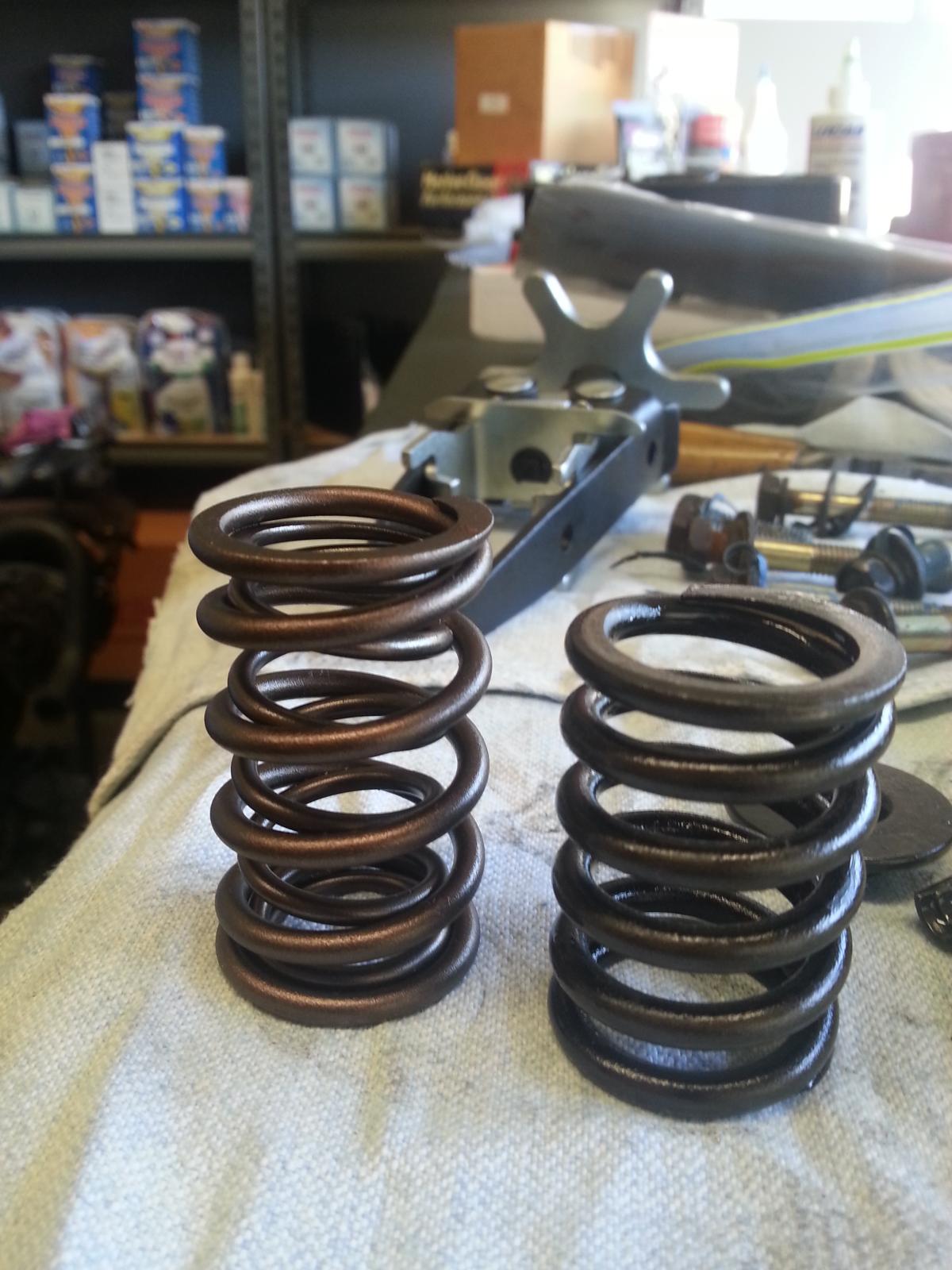

KE70PWR Posted July 27, 2014 Author Report Posted July 27, 2014 Stock valve spring vs double springs Quote

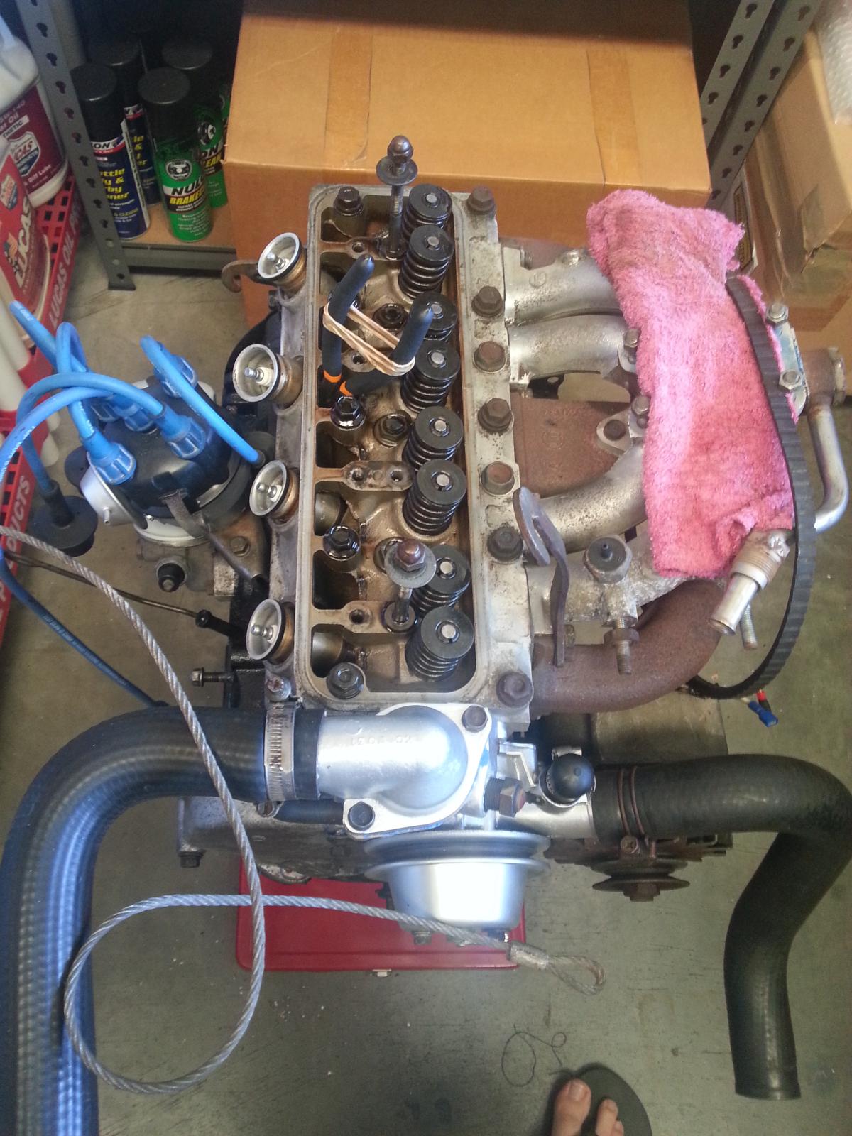

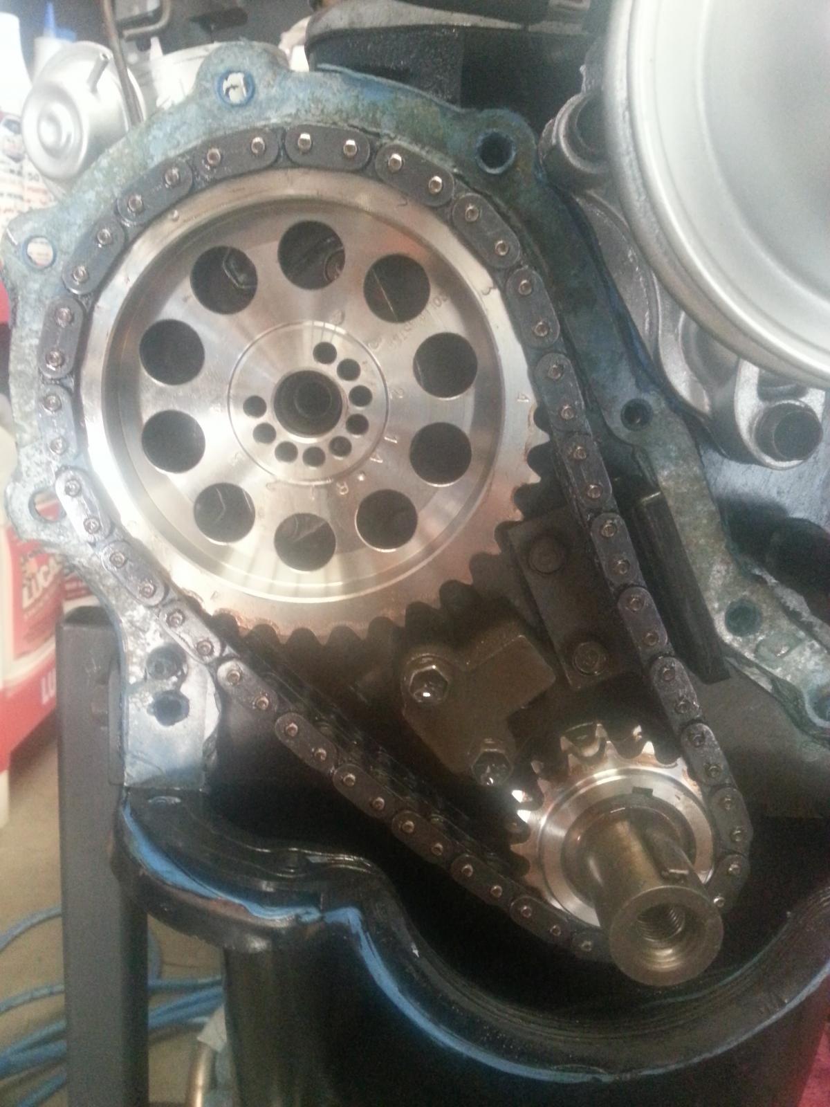

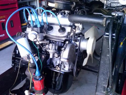

KE70PWR Posted July 31, 2014 Author Report Posted July 31, 2014 on the weekend i got a few bits installed. Cam new cam chain and gears new double springs. its coming together now. next step is to get the j pipe finished and make up the oil and water lines for the turbo with a custom return plate for the oil where the original fuel pump came from. any one has any suggestions please share as I am only fumbling my way through. :) Quote
