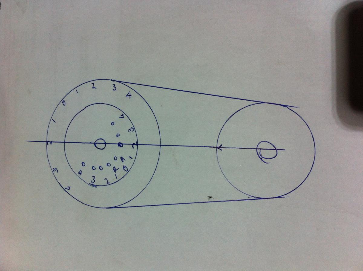

I'm at work so I banged this up real quick.
Unless your cam grinder gave you specifics to advance or retard the cam, you'll need a degreeing wheel to set this properly.
NB: In this hastily scrawled diagram, the cam gear is 180 degrees out.
