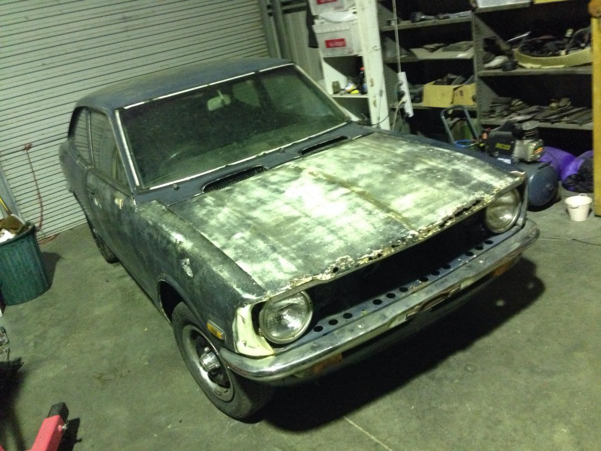

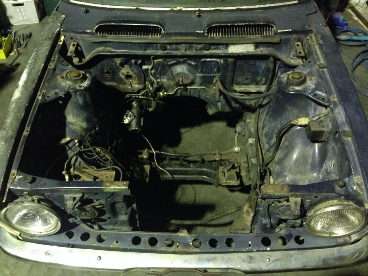

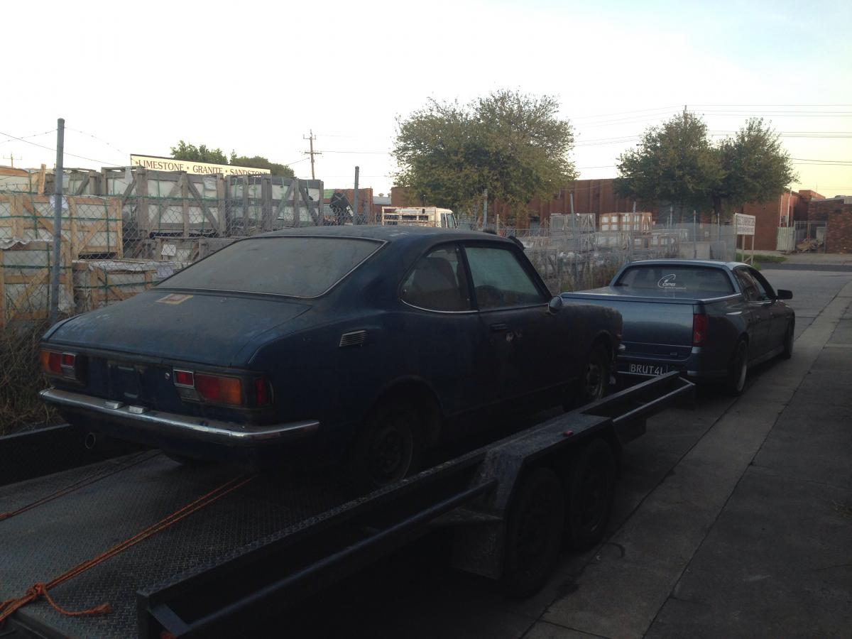

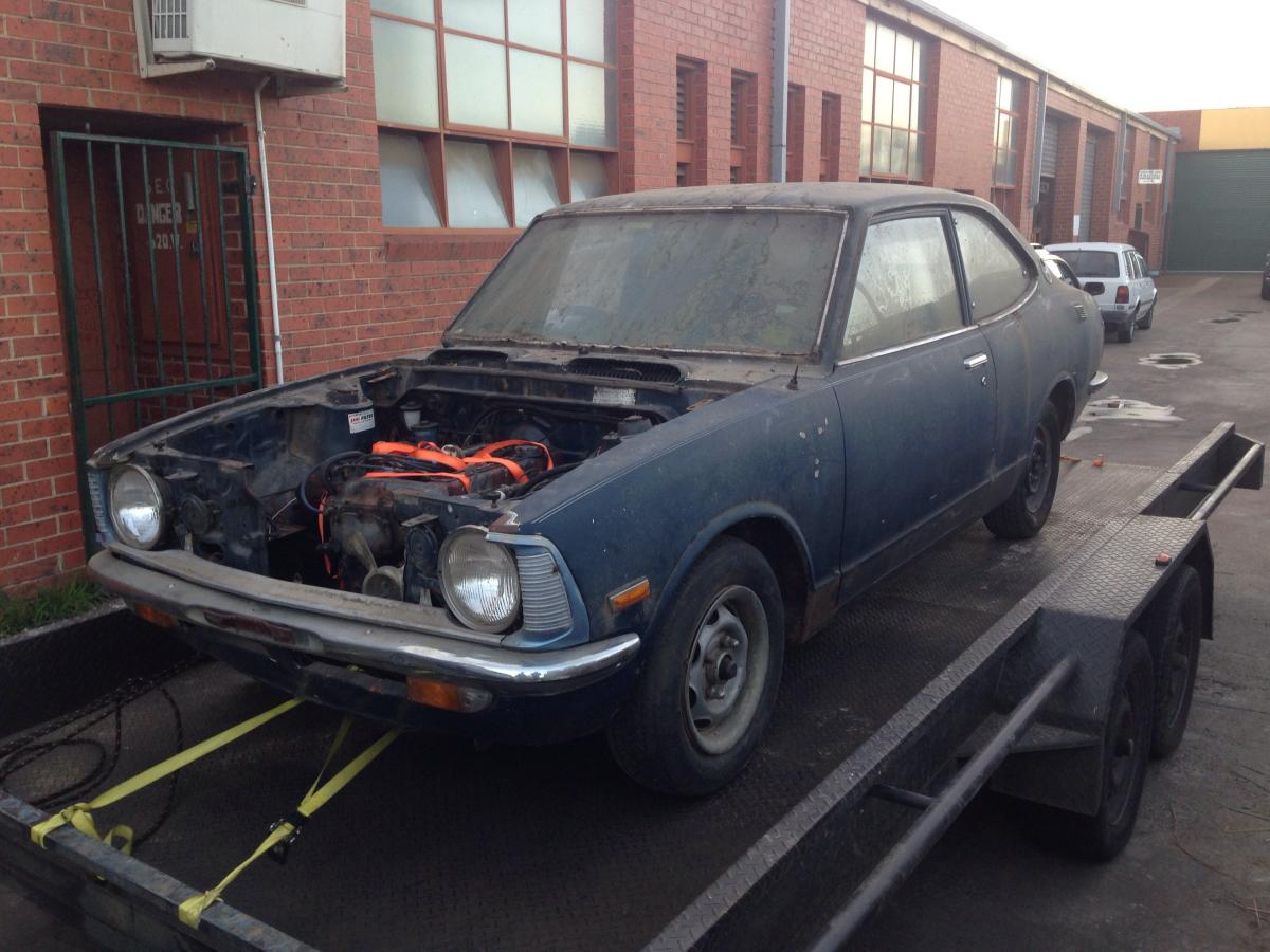

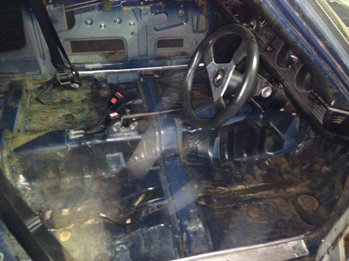

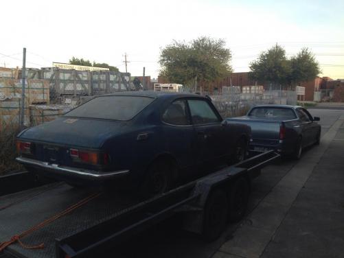

dpb Posted June 14, 2014 Report Posted June 14, 2014 So after idolising Dave (te278u) te27 for years and also numerous other friends having tricked up ke2x I had to have one. After buying 3 other cars off Dave (ke10 and 2 ke70 wagons) he mentioned thinking of selling a ke25 he had stowed away in the corner of his shed to wich I of course replied "I want it" sooo now to make it into something I can drive daily and still have some fun. When I picked her up And at her new home after some cleaning and disassembling for paint and panel Quote
.T. Posted June 14, 2014 Report Posted June 14, 2014 I thought that car looked familiar! I know that car had been stored outside for some time hopefully it does not have that much rust in it if is a update it has the wrong light garnishes in it - good luck finding the correct grill, under grill panel & the garnishes - took me nearly 4 years to find all those parts. I can help you out with the flares though good starting point though! Quote
parrot Posted June 14, 2014 Report Posted June 14, 2014 That's a nice 25. I'm surprised Dave sold it, though when you have 11ty billion cars.... Quote

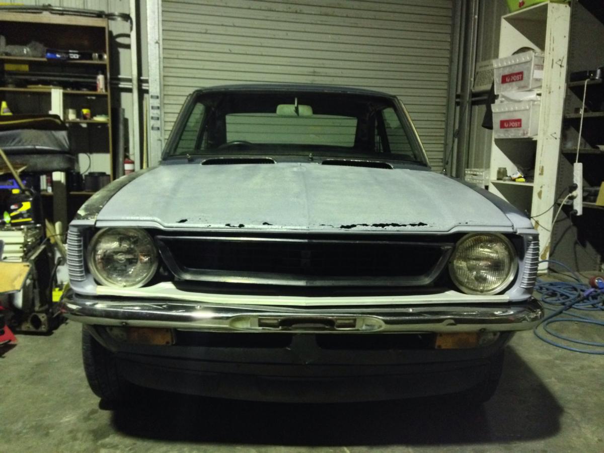

dpb Posted June 15, 2014 Author Report Posted June 15, 2014 Haha yes I was suprised too but definitely not complaining rust is minimal worst is the bottom of LH qtr window bottom of rear gaurds and the bonnet and bootlid, Dave is helping me out with a decent bonnet so have to find a decent bootlid or try repair the existing one and I have the grill and infill panel just need some headlight outer garnishes as it had ke20 ones on it and I'm keen on flares when the time comes 👍 Quote

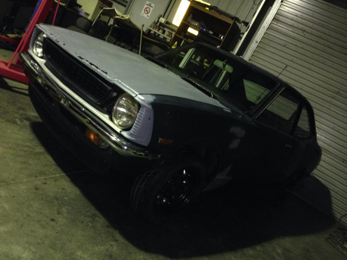

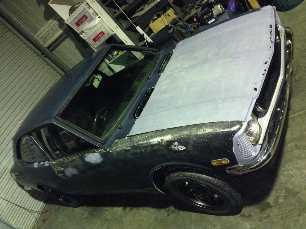

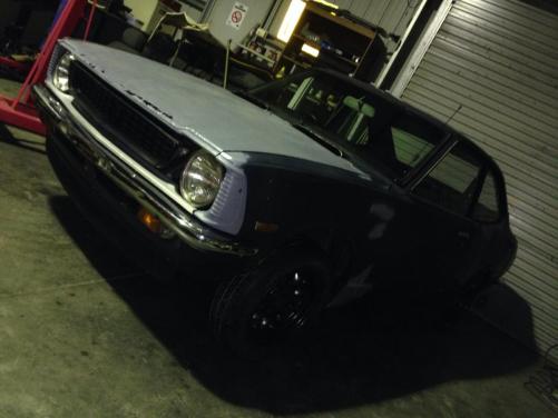

dpb Posted June 15, 2014 Author Report Posted June 15, 2014 That would be great thanks! I Got bored today after going to the tccav coffee cars and doughnuts meet this morning so I roughly slapped her together and chucked some Superlites on and one of my chin spoilers to give myself some motivation Quote
parrot Posted June 15, 2014 Report Posted June 15, 2014 I finally worked out who you are! The superlites look damn good on my AE86 too! But I'm glad this is where they are going. Let me know whenever your in a position to collect them. I'll try and strip the tyres off them later this week so they are ready for you. Quote
dpb Posted June 15, 2014 Author Report Posted June 15, 2014 Haha yep there for this rig to get her through Rwc with same size all round till I get some shortened ke 30 axles or get a t series under her bum Quote
parrot Posted June 15, 2014 Report Posted June 15, 2014 In that case, are you sure you want 114.3? They won't fit the ke25 until you change the pcd Quote
dpb Posted June 15, 2014 Author Report Posted June 15, 2014 Yeh the front is already 4x114.3 the rear is still 4x110 wich I already have a pair of 13" Superlites to suit. I have a pair of 14" ones on the front ATM il get some 14" for the back when it's 4x114.3 Quote
