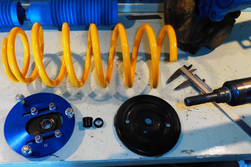

Then the next problem.. The bushes in the camber adjusters are for 15mm strut shafts, pretty usual, but Bilsteins are only 14mm, so it was awaiting new bushes to be made. The AE86 springs don't match any spring top, KE70, Corona or Celica, so we made custom ones there too.  Meh- forgot to photograph them, I'll do it this week.

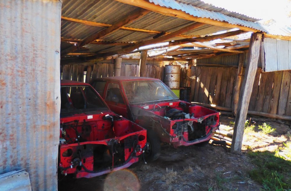

While I was away Steve had cleared out the storage/junk shed part of the woolshed and moved the two spare cars out to a new home. Now we need to re-roof this one too!

Well, another trip and yep, struts done...
Of course they don't fit!!  The Sigma LCAs give it such a camber angle that the LCA balljoint runs out of angle.  I assume people who use them ignore that and let the droop limit be the balljoint jamming.  Anyway, another little problem to solve later, we'll see how it all sits with a motor in.

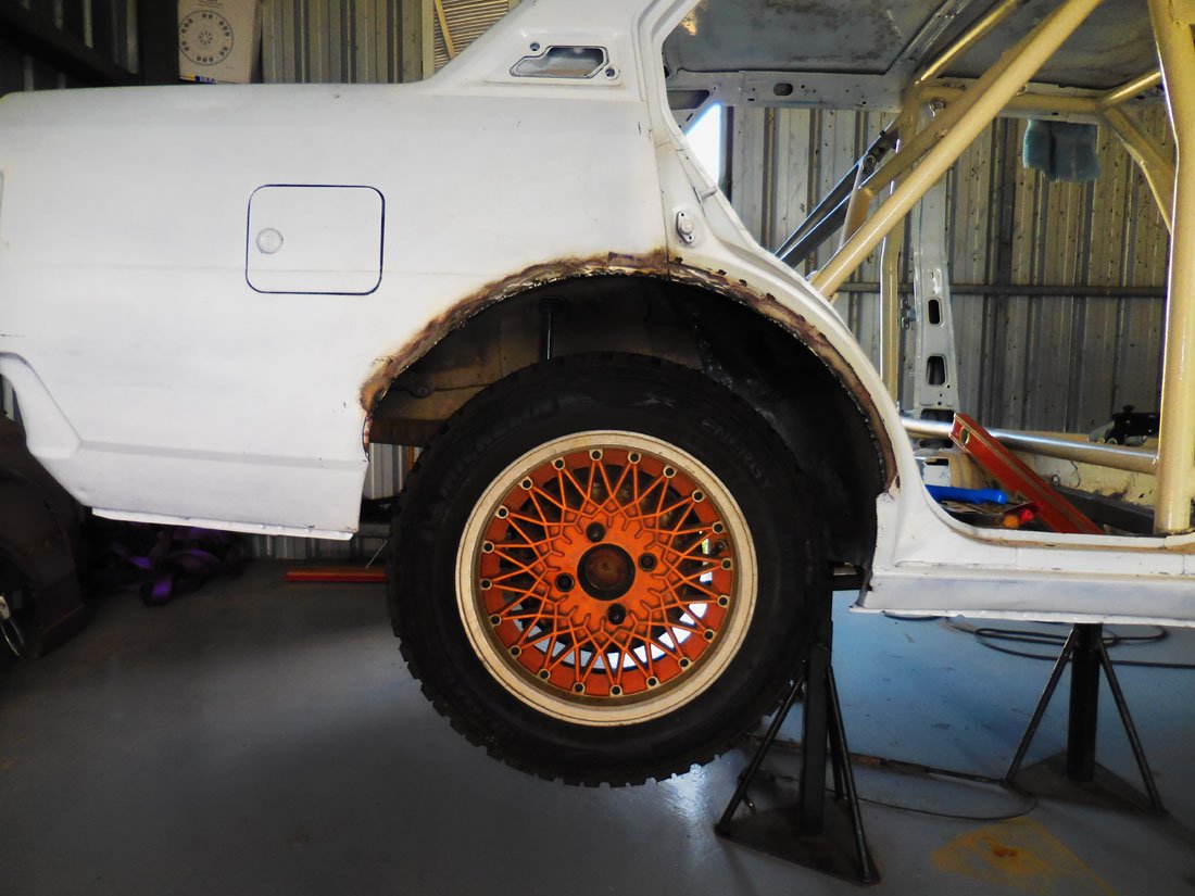

With the front suspension done we hit the rear arches. Without springs and shocks the axle goes right up and hits the body in several places at once, a wonderful design. With the 14" rims we needed to chop 75mm out of the top of the wheel arch and re-weld the inner and outer skins.
We cut the arches off the front guards of one of the paddock Coronas and made those fit. They aren't a dead copy of the KE70 shapes, but now that they are trimmed, riveted, bogged and painted they look fine!

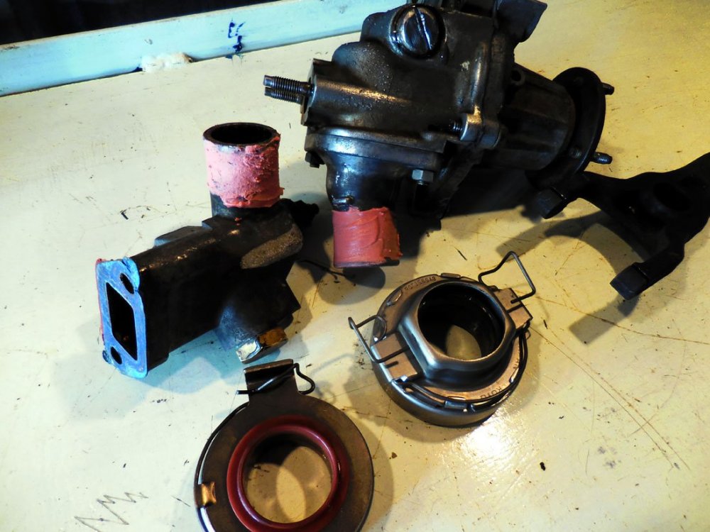

More shiny goodness from SamQ for the back of the head, although we only wanted one outlet and plugged the other 3.
We cut the steel bypass line to fit and cleaned all the water pump gear. The hose fittings were all corroded, but some bog tidied them up. Then we moved onto gearbox and thrust bearing problems..
The difference in the wire clips shown on those thrust bearings shows how different the Altezza J160 box is. No other Toyota seems to have the same clip system.

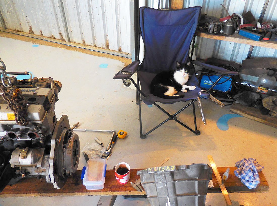

However it was one of several major problems involving the clutch stuff. Basically the Altezza crank sits about 14mm further out from the block, so on a 4AGE the gearbox input shaft doesn't go inside the spigot bearing, the thrust bearing carrier falls off the front of the input shaft tube, and the slave arm pivot can't stick out far enough to let the arm push the thrust bearing far enough forward.
We're currently looking at the best way to move those three components forward. We only found this out after buying a slave cylinder (off another Toyota) but on Ebay they can't be determined if they're left-hand or RH, and of course it is upside-down on the J160... so useless!
Meanwhile, the boss was there in my chair and wouldn't even let me have lunch!
