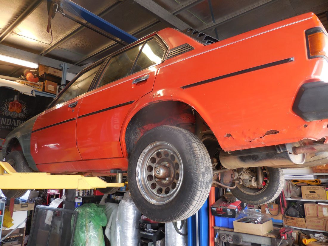

Steve's daily, Mao, had dropped the exhaust when he was a control on an AMSAG event down on the coast, so we put that on the hoist and re-made it all. The new sliders are great for tight spots in a workshop, I just need to modify them when I get time...

By then Louie had arrived to continue the battle with his KE70, he'd driven it into the ground and the list was long. The biggest was a blown head gasket & a completely collapsed rear uni in the driveshaft. A skim sorted the head out-
Then it was worth porting the intakes to match the gasket-
and we pulled the block out to tip it on its side and scrape all the rust & scale out. As usual, over half a cup of crap was blocking #4 water jacket.
The biggest problem was matching the manifolds to the head, the intake/exhausts were not flat and the manifold gasket wouldn't last long. We tried three manifolds, all of which destroyed the hotspot bolts when we tried to take them apart, and finally the 4th pair were OK. A couple of days and it was running, so now it awaits rust work.
