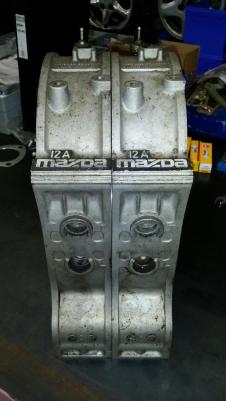

Old Man Butters Posted August 30, 2014 Author Report Posted August 30, 2014 Ok people, I know I have been pretty slack with this, but undergoing workers comp shit with a dodgy back < 2 failed ops > and heaps of painkillers make me a forgetful mother funter. I have relocated up to QLD, and am heading off next week to retrieve the corolla from Tassie and get it's mods underway. So far, the engine looks immaculate. The plates did not need machining, they were near perfect. Everything is cleaning up will, and Dave and I will set about spending moolah on all new seals and what have you in the coming weeks. The turbo has been decided, we are going to run a GT35R. Using a series II RX7 Auto gearbox, one with an auto valve body so that I can drive it normally, and one gearbox strengthened up for when Dave takes it down the strip. We have a mate in NSW that is a Hilux diff guru, so he will be handling that, and as for the general fitment of the engine, that will be up to Dave. He works for an auto engineer shop, and his boss is a racing enthusiast. We will be looking to him for strut/braking combos. As mentioned before, Dave will just be opening up the inlet valves on the 12a, nothing too hardcore. I am debating leaving the brown carpet and beige door trims, but i really want to retrim it all in grey man-made leather with mustard yellow inserts. Not bulky or stitched dash, just a straight retrim of the interior as it sits. I find the car remarkebly comfortable to ride in, and want to be able to maintain some aspect of that. Dave < my little brother > is a qualified rotary mechanic, so we are working on it together. Going to run a haltech engine management system by the looks of it, and series 4 inlet manifold. Have to wait for fitment before deciding on a cooler or radiator combo. I have a few pics of the housing cleaned up but that is it. Engine went off for dowling the other day, should have it back soon. I want to steer away from the yellow/silver engine bay theme. But here lies a dilemma for me. Being unable to polish anything very well because of physical aspects, I wanted to get all the chrome trims on the car, every single one, painted in a light grey 2pac paint. Then every thing else in the engine bay that can't go this colour was going to go a dark gun metal grey colour. Thoughts anyone? I am also wondering if i should switch to a fuel cell instead of the fuel tank??? not sure. Quote

indelible Posted August 30, 2014 Report Posted August 30, 2014 Quote opening up the inlet valves on the 12a, guessing you meant ports? Quote

Old Man Butters Posted August 31, 2014 Author Report Posted August 31, 2014 LMAO indelible..... hence why Dave is doing everything mechanical lol. Thank you for the correction though, and you are 100% correct, I meant ports not valves. I will see if Dave can get me a pic of the standard ports vs a na 12a. I believe they are smaller. Just a quick question, i posted pics on here before, how do i do it again? Things seem to have changed a little bit. However, and admin feel free to delete this if I am being naughty, here is a link to my folder on Facey https://www.facebook.com/media/set/?set=a.10153129563803642&type=1 Quote

Old Man Butters Posted September 20, 2014 Author Report Posted September 20, 2014 Oh you know it. Currently, my wife is headed down to tassie and she will be using BUTTRS while she is there, then I am flying down to drive it up here. Can't wait! Just picked up a TC Gemini Coupe as my daily driver whilst all the fun things happen with the rolla. Engine is back from being dowled, so now Dave is just ordering some parts and we will be ready to assemble it. Decided on a Silver and Gun Metal Grey colour scheme for the motor / engine bits / suspension bits and thingies. Getting close to engine build time!!! Quote
Old Man Butters Posted October 11, 2014 Author Report Posted October 11, 2014 Ok so I am back in Tassie, and while I was at the auto trimmers buying some carpet, I decided to book BUTTRS in for a retrim. New door panels and new seats. Dark grey vinyl on the back and sides, light grey vinyl on the top/sides, and currently a cloth insert in the middle. However, the more I think about it, the more I think I would just like a combo of light grey and yellow vinyl on the seats. There just doesn't seem to be much material that I like. Anyway, it goes ahead this wednesday, so I will talk to the trimmer then. I have also ordered some 15inch supalites from bob jane. Now I know that I will likely change wheels when I fit the hilux diff, however I really like supalites and I was feeling spendy. I am sure I could sell them no worries. Woo. On the rotor side of things, Dave is just starting to port it, so we will be putting it together soon. The corolla has taken a little bit of a backseat as of late, as we are fitting an ls3to my wifes lx torana, broom broom!!!! Should go quite nicely!!! Quote

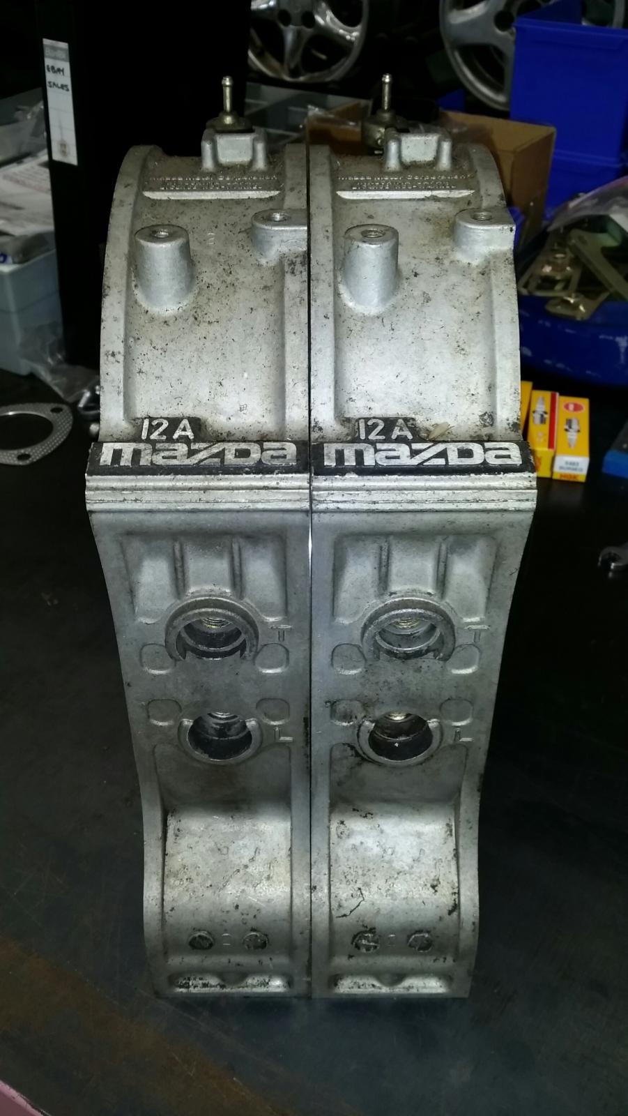

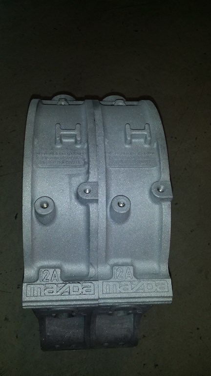

Old Man Butters Posted October 28, 2014 Author Report Posted October 28, 2014 Ok so the Supalites arrived a day before BUTTRS went to the trimmers. Other presents also arrived in Brisbane, where the car will end up. Check em out. Never mind the surface rust bubbling on the corner of the bonnet..... the bodywork shall be attacked in due time!!! painted in acrylic, will be repainted in acrylic. I bought 4lts of colour and 4lts of clear just the other day. We shall see how this turns out lol. And as promised, one of the presents that arrived in brisbane,,,, hopefully the haltech gets here soon. Also, we are nearly ready to build so it's a good thing i am up here at the moment. With this combo, we should see a lazy 350hp at the wheels, and are aiming for mid 11's. Dave has to do the strip work, I can't handle the stress on your body. I had an RX-7 S2 12aturbs that ran a flat 12, and when launching that hard, over and over again at a meet or test and tune.,, would spell disaster\. Plus, he is better at such things so it will be up to him :D Quote
