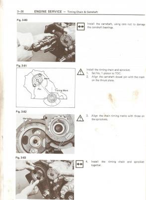

Kirill Posted March 1, 2014 Report Posted March 1, 2014 Hey guys. I just put in a new cam into 4k. Any advice how to set cam timing? There are no marks? Quote
B.L.Z.BUB Posted March 1, 2014 Report Posted March 1, 2014 If its a stock or reground cam they use the standard cam dowels to line it up. There are marks on both the crank and cam that need to line up. Quote

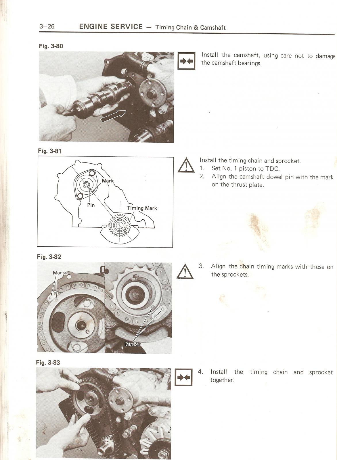

Banjo Posted March 1, 2014 Report Posted March 1, 2014 (edited) Hey Kirill, There definitely are marks. Here is a quick scan from the Toyota K Series Engine Repair Manual. Not real flash, but hope it assists. Cheers Banjo Edited March 1, 2014 by Banjo Quote

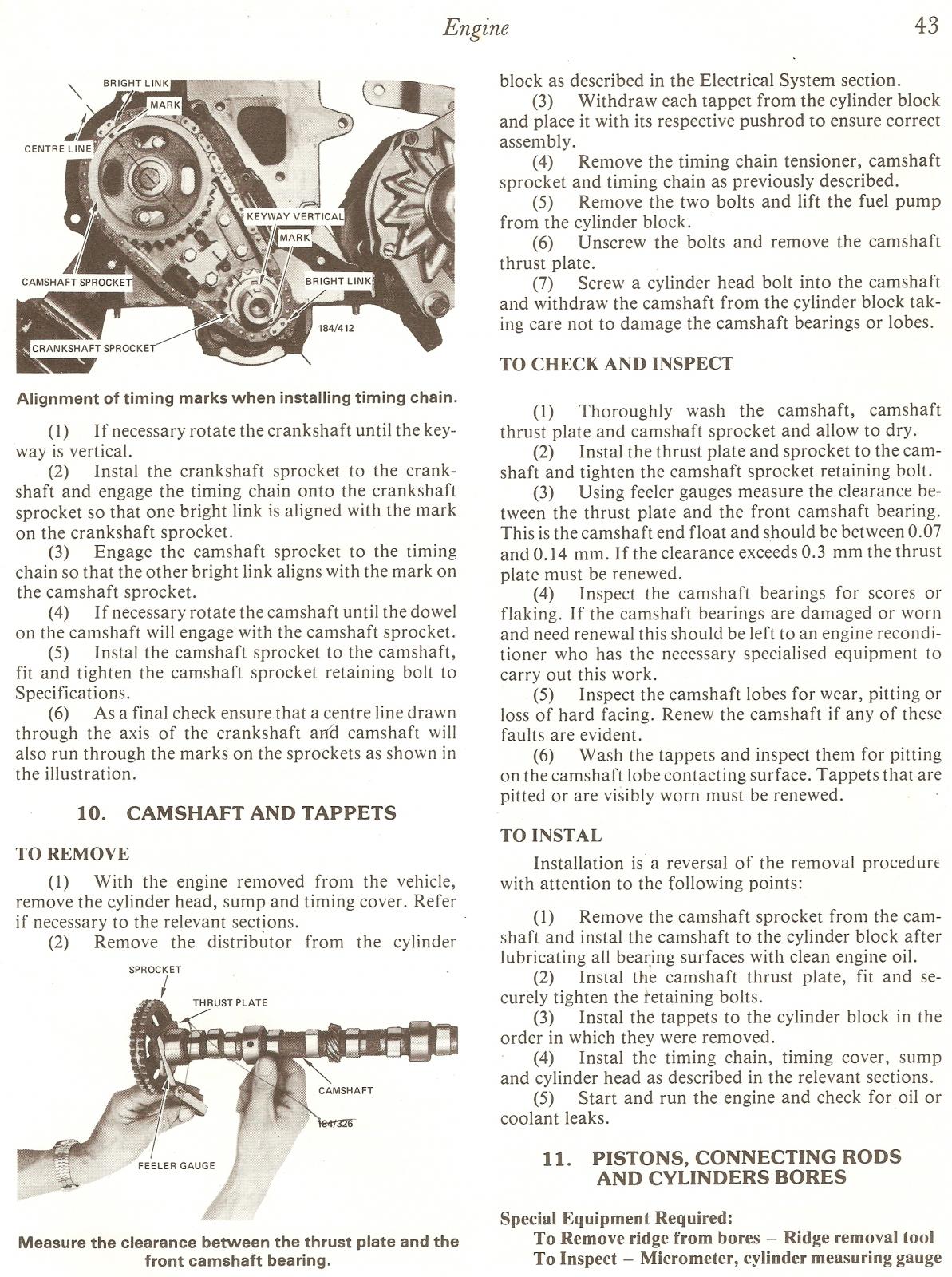

Banjo Posted March 1, 2014 Report Posted March 1, 2014 (edited) Hi Kirill, Just discoveed there is a better diagram/picture in the Gregorys Corolla manual. I'll see if I can't get a better scan of that & post it for you. Cheers Edited March 1, 2014 by Banjo Quote
Banjo Posted March 1, 2014 Report Posted March 1, 2014 Hi Kirill, Hope this is a little more clearer. Cheers Banjo Quote
