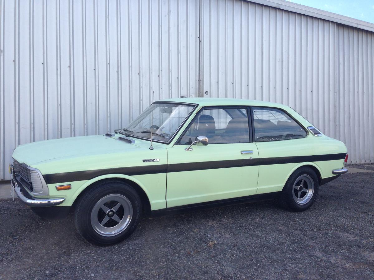

ke2020 Posted February 24, 2014 Report Posted February 24, 2014 Hay guys just got my ke20 project that I have started and I was looking underneath the car and by the looks of it there is not much room for a descent size tyre. Can anyone tell me how wide of a rear tyre can I go with out moving in the leafs. Or do I just bite the bullet and move them in now rather than later. Quote
