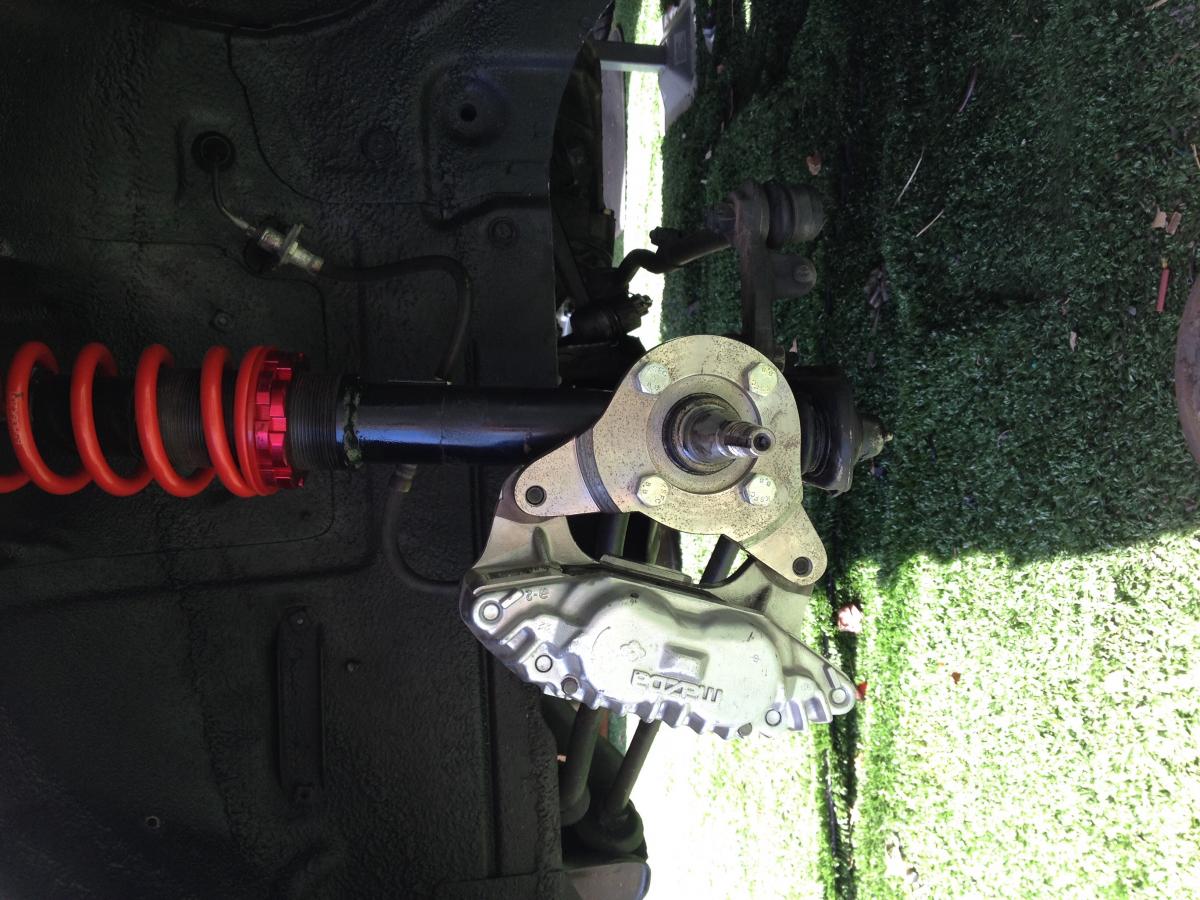

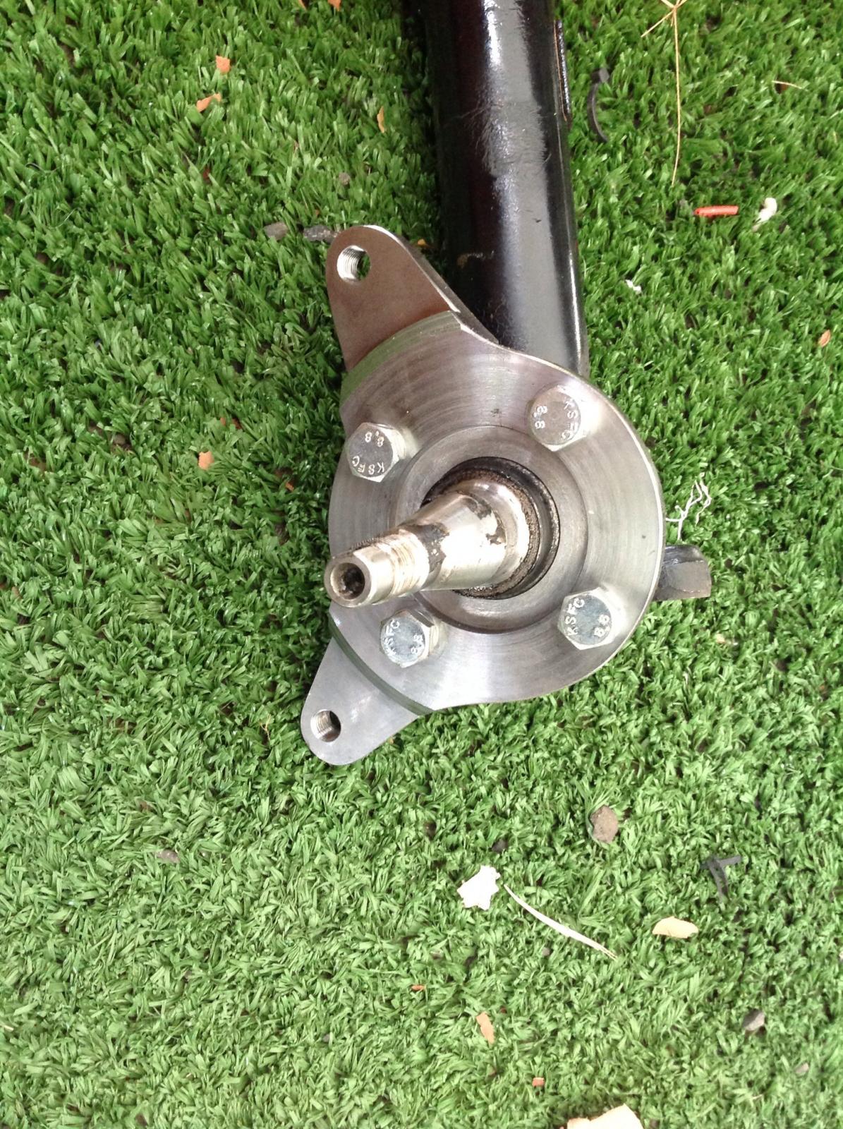

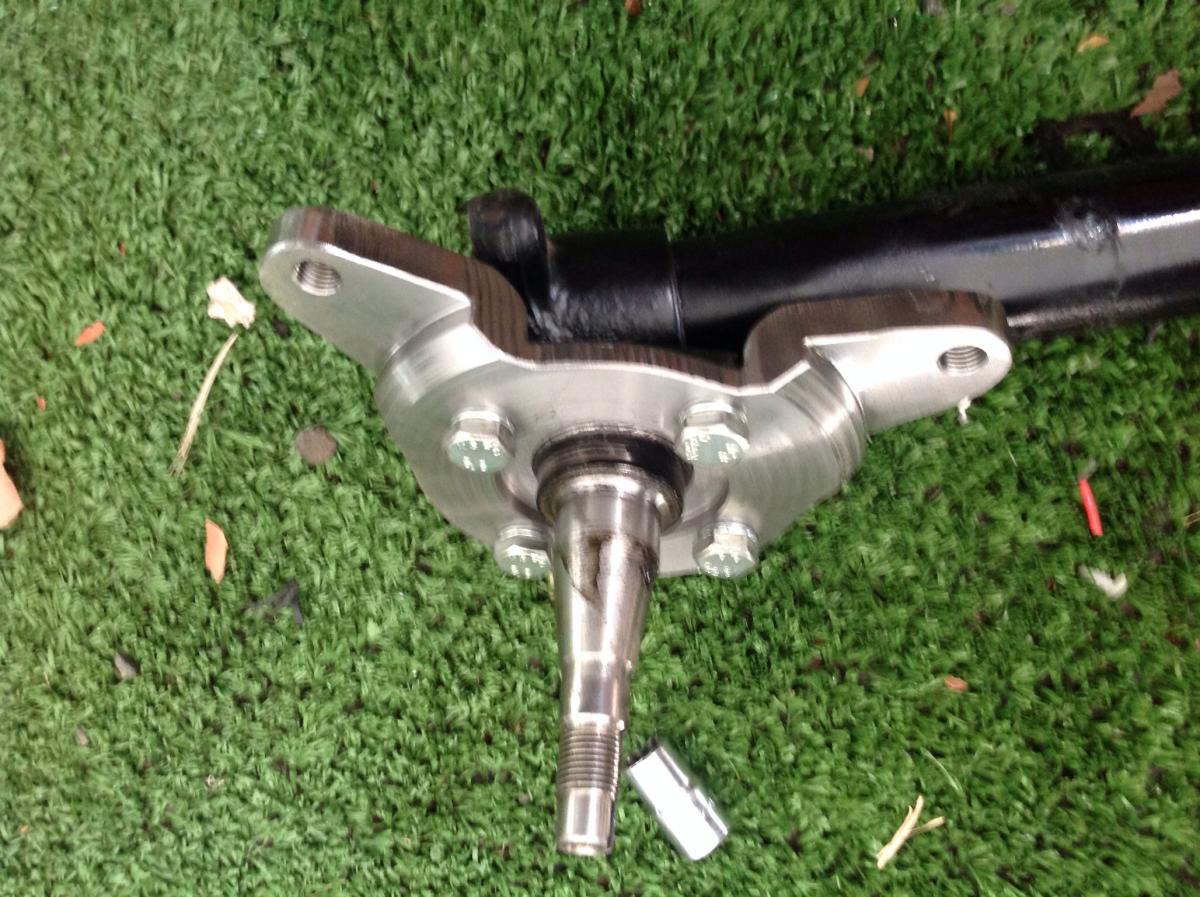

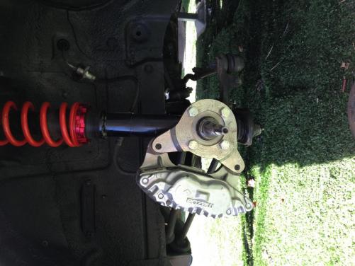

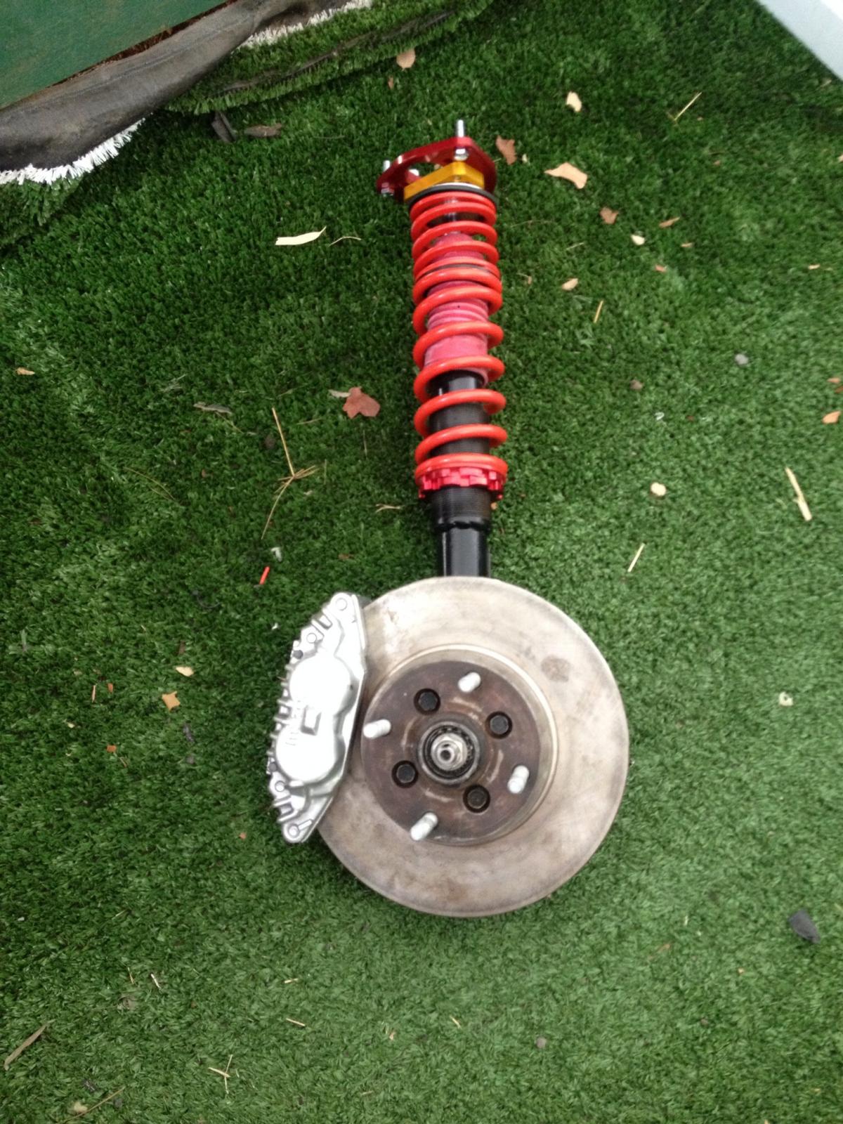

SR30 Posted March 23, 2014 Author Report Posted March 23, 2014 Few pics of the brake/suspension set up. Quote

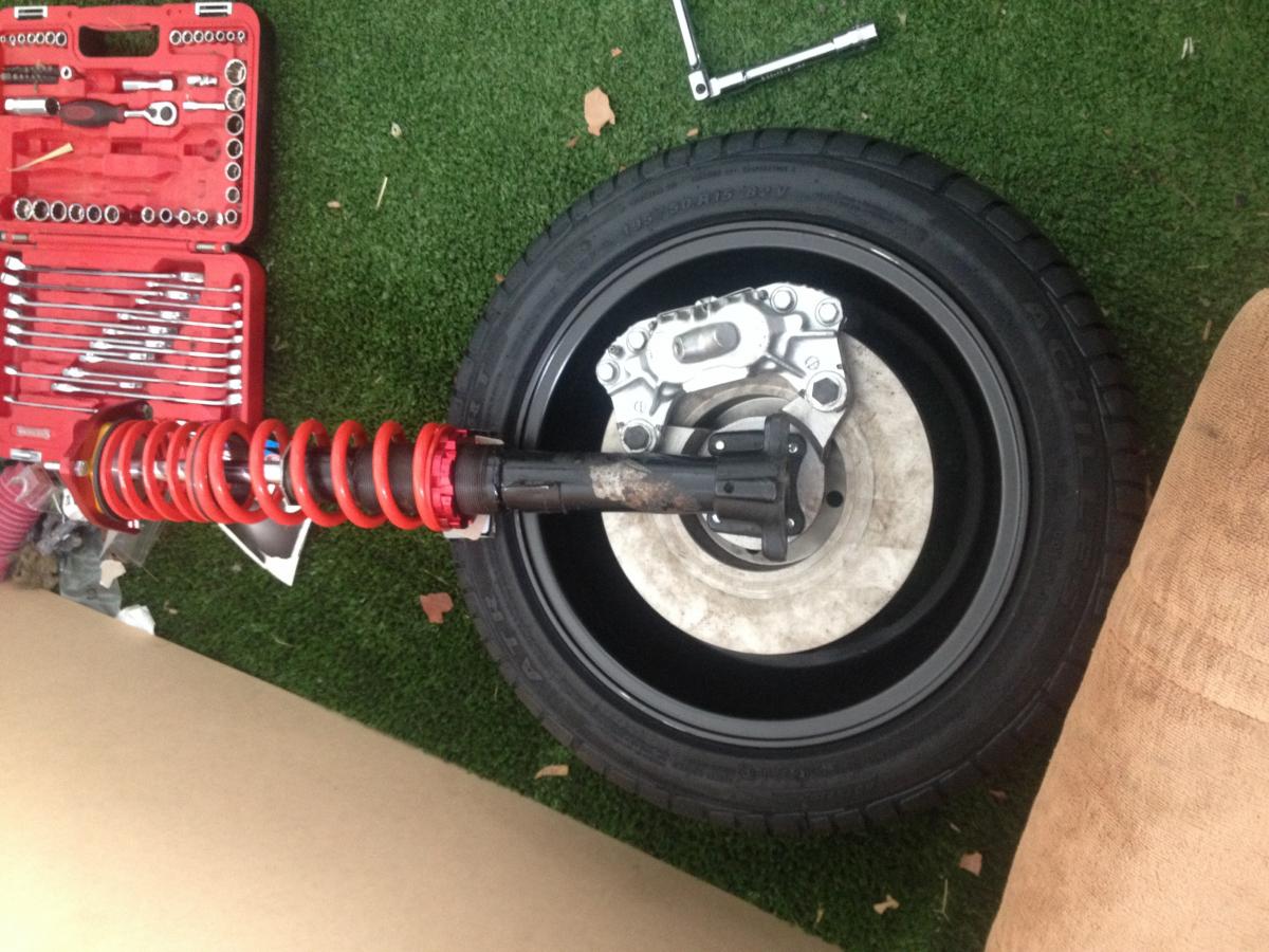

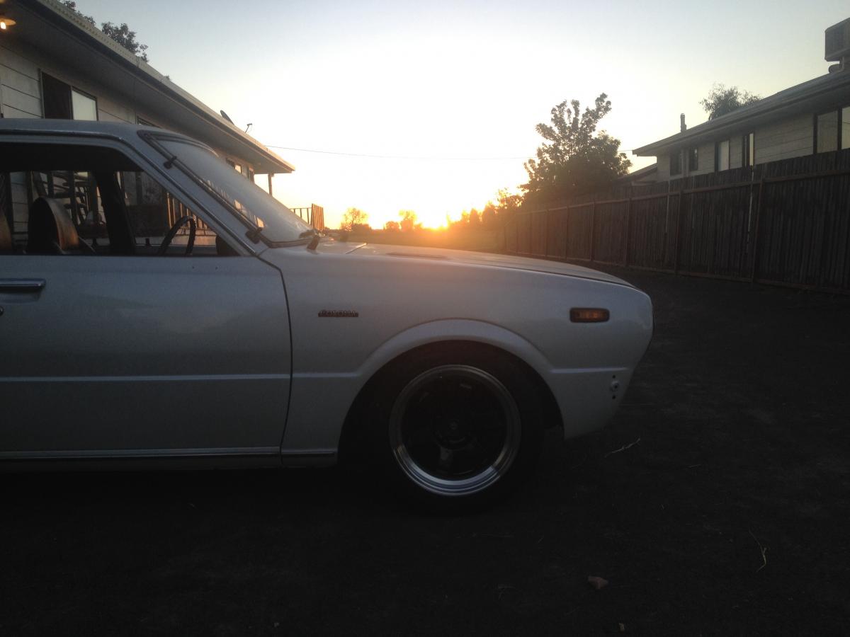

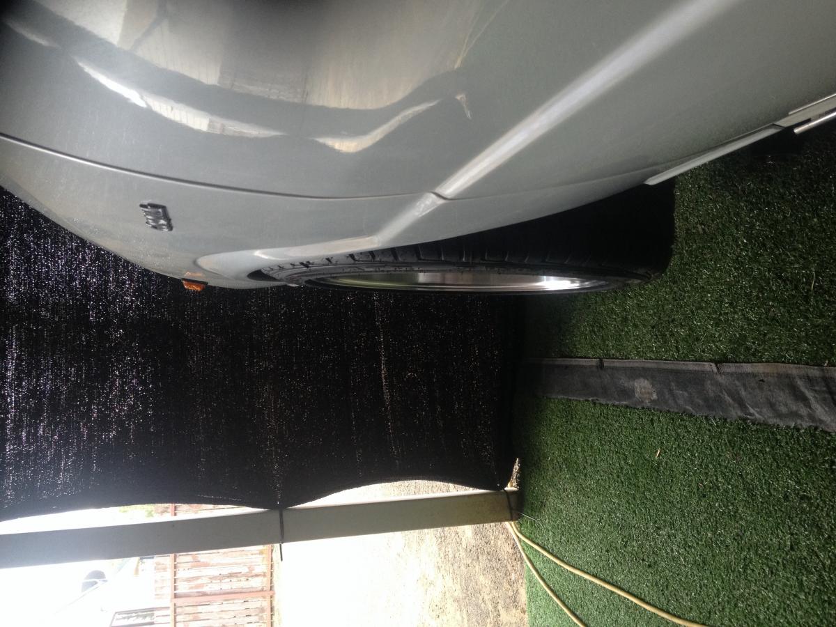

SR30 Posted April 13, 2014 Author Report Posted April 13, 2014 Wheels turned up this week, few more pics of brake calliper clearance and wheel fitment. Pretty stoked with the offset, have a little room to play with the camber adjustment too. Quote
cuzzo Posted April 13, 2014 Report Posted April 13, 2014 Details on brake caliper bracket ans strut used? Quote
SR30 Posted April 13, 2014 Author Report Posted April 13, 2014 It's the factory ke30 shortened strut with a custom brake calliper bracket to suit s4 rx7 caliper. Quote
cuzzo Posted April 13, 2014 Report Posted April 13, 2014 Cool, where'd you get the bracket from? Quote
SR30 Posted April 13, 2014 Author Report Posted April 13, 2014 I took the whole set up to a local engineer who created a CAD drawing to suit my parts. Quote

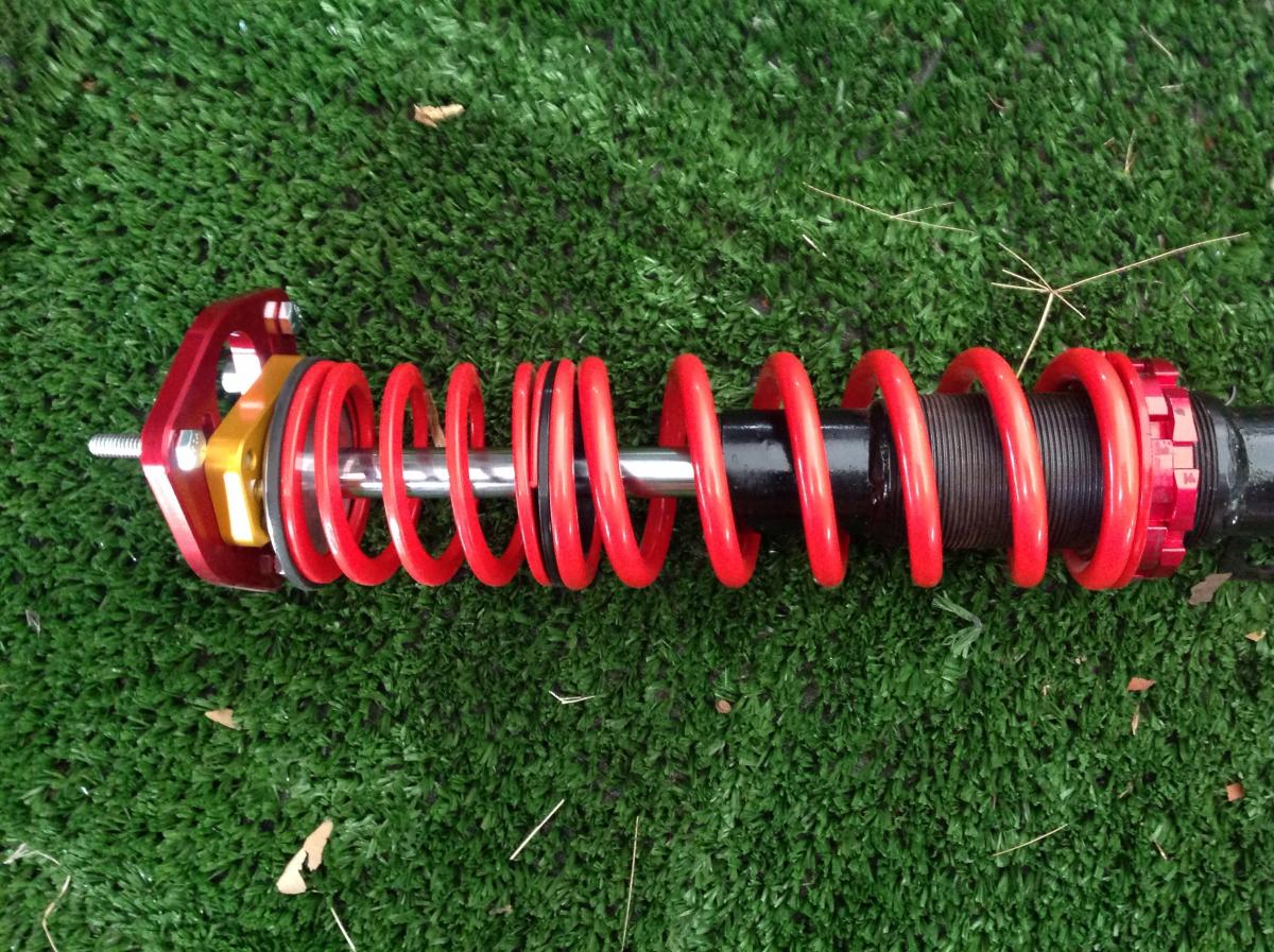

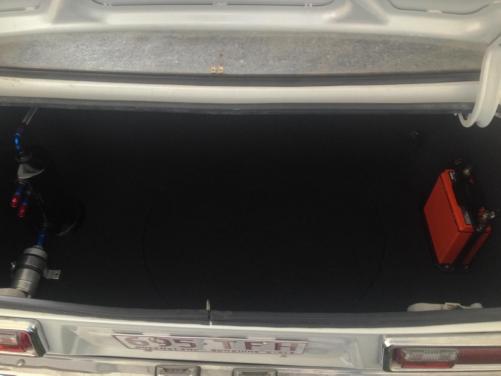

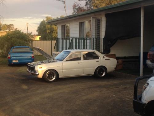

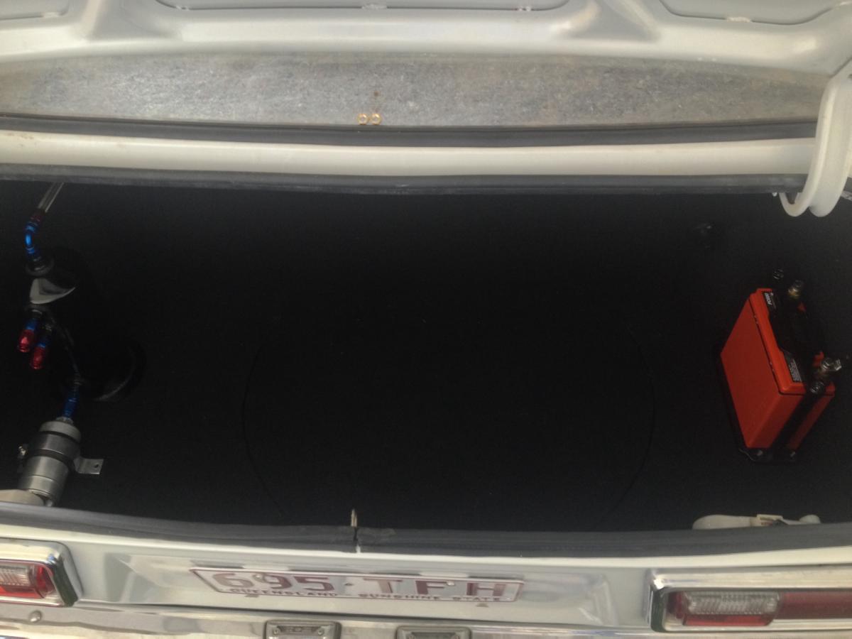

SR30 Posted April 17, 2014 Author Report Posted April 17, 2014 (edited) Have been playing around the last few weekends. Boxed and carpeted the boot, fitted wheels. Front has a little too much camber so looking towards adjustable LCAs. Rear still needs to come down an inch or so, diffs getting redone in the coming weeks. Edited April 20, 2014 by SR30 Quote

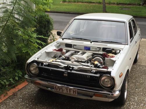

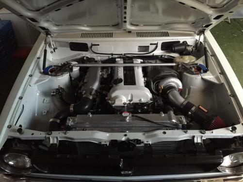

SR30 Posted June 28, 2014 Author Report Posted June 28, 2014 Engines pretty much finished for now..everything's all plumbed up and she's running. A few little cosmetic bits to go but they are going to wait til it's on the road. Have another photo of the brake set up as well. Diff is taking longer than expected due to other work on at the shop, should be finished this coming Friday. Fingers are crossed for that one!! Starting to get itchy feet, want to run it up on the dyno already. Quote

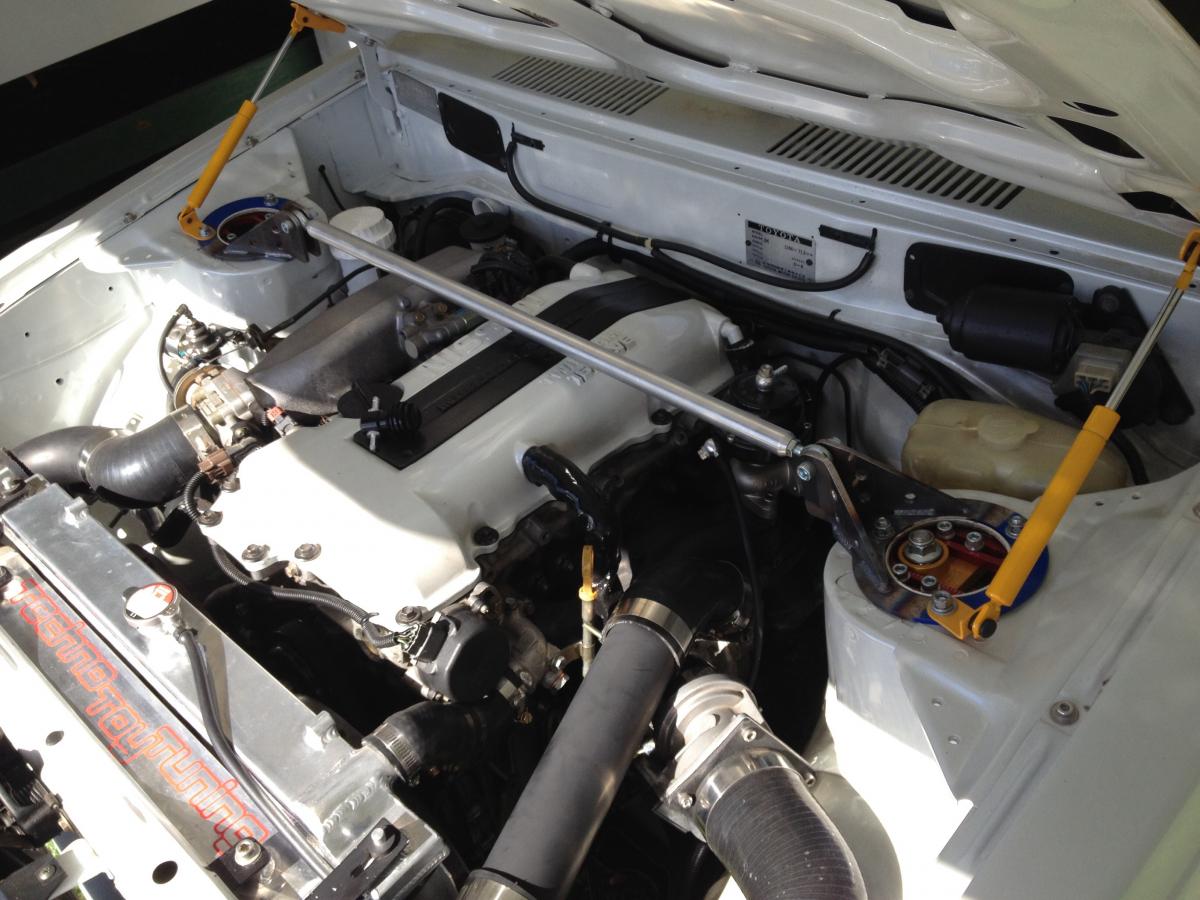

Sr20det ke30 rolla Posted July 19, 2014 Report Posted July 19, 2014 Hey man just a couple of questions! Where did you get your strut brace from? And how hard was it to convert clutch from cable to hydraulic? Quote
SR30 Posted July 20, 2014 Author Report Posted July 20, 2014 (edited) I brought the brace from techno toy tuning but it didn't fit over the engine, took it to the engineer and he made new higher base plates for me (you can see they still need painting). You could look at finding a brace with a bent bar to clear the engine. The hydraulic clutch is very easy. I just made up a template off the cylinder then drilled the holes into the firewall. My car was originally auto so didn't have any cable to begin with. Edited July 20, 2014 by SR30 Quote
