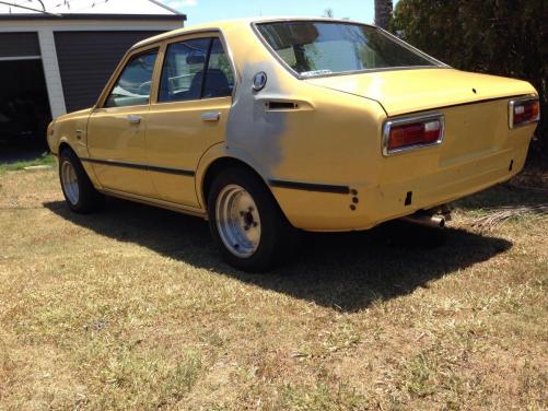

I'm looking to upgrade wheels on my ke30, currently have some Tarago steel wheels 14x5.5 +30 (measured offset myself so hopefully its accurate) on stock standard (AFAIK) suspension, and the outer edge of the front rims is about 20mm in from the guard (rears have plenty of space). According to this willtheyfit.com link, 14x7 +0 will stick out and extra 2 inches, which makes it seem that they will not fit well. Do you need to flair/roll the guards to fit this size rim, or have i missed something in my calculations?
I have also measured the stock ke30 wheel offset/size at 13x4 +40 meaning that 14x7 +0 would stick out an extra 78.1mm - does this sound right?

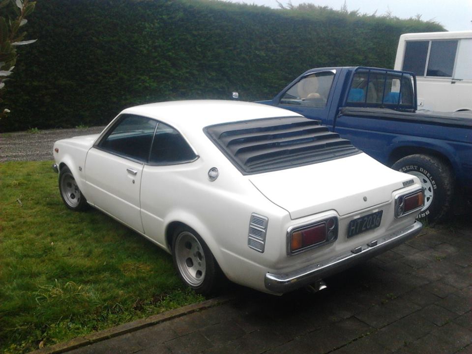

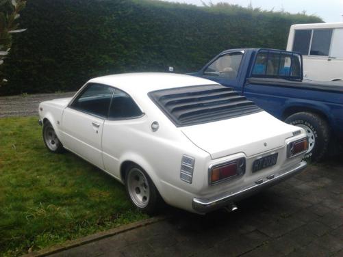

Check out Shiryos fitment on his 30.
- 14x7.5-6 front
- 14x8-3 rear
Personally I think he has got them spot on. Obviously you'd need camber plates for the front.
Thanks Reed.
Actually running 14x7.5 -9 front and 14x8 -8 rears now with slip on spacers.
Also extended LCA's as camber plates are maxed.
