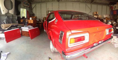

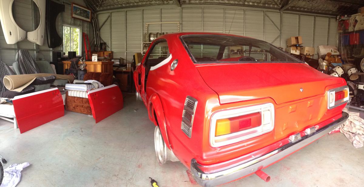

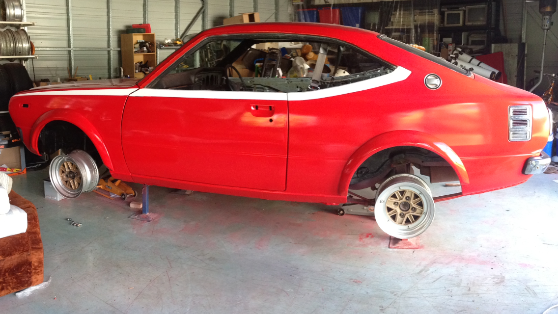

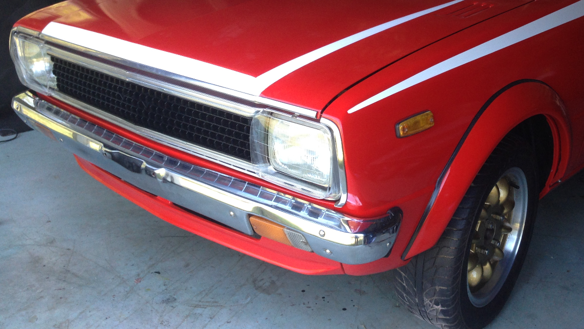

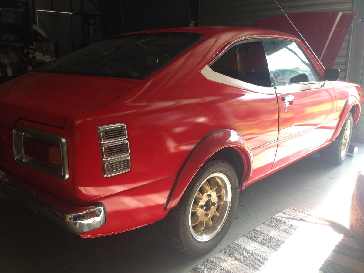

Mechanical Sympathy Posted December 20, 2015 Author Report Posted December 20, 2015 (edited) Doors and flares done. Need an extra pair of hands, but will likely get creative with some milk crates and cushions to hang these doors. Actually ʞ©$ɟ it, I'll go see Star Wars. edit; hung them loosely to see how bad my masking was. I'll fix that with a brush once the panels are on properly. Edited December 20, 2015 by Mechanical Sympathy Quote

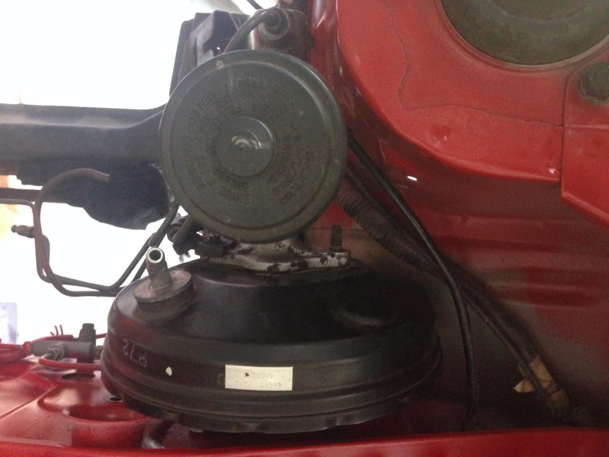

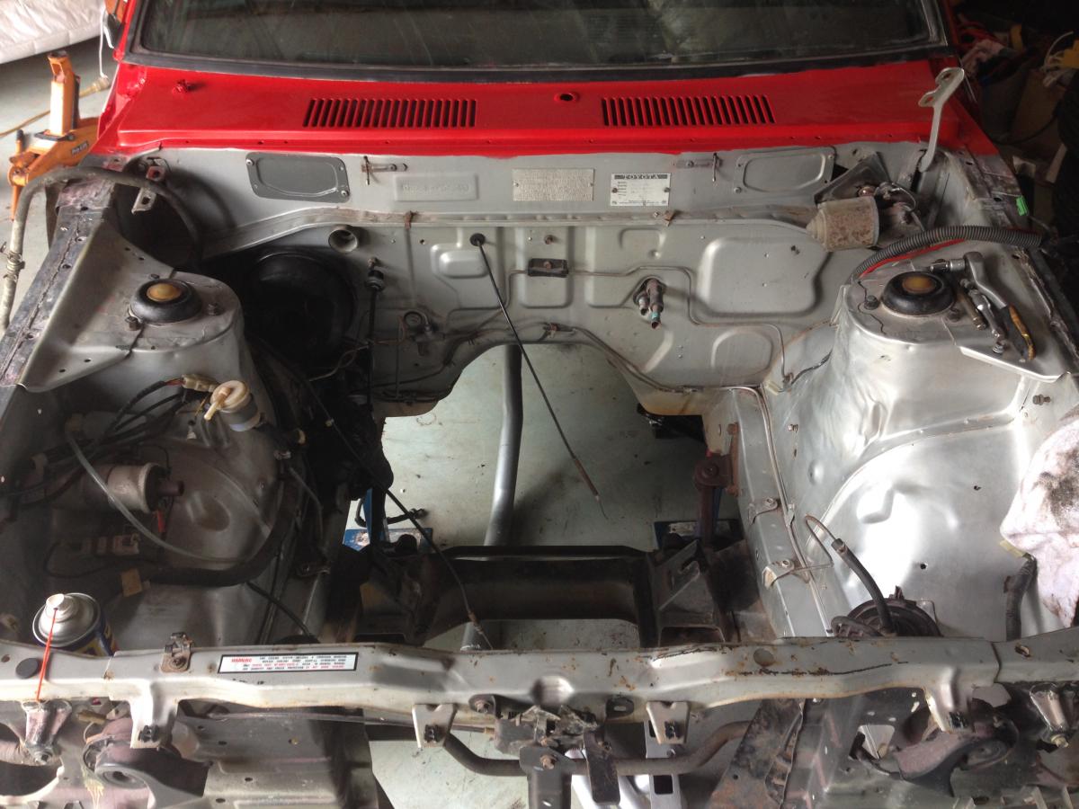

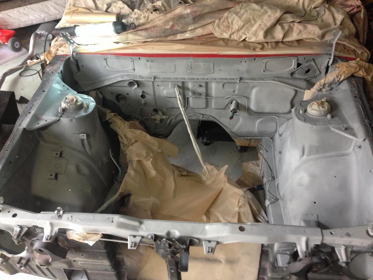

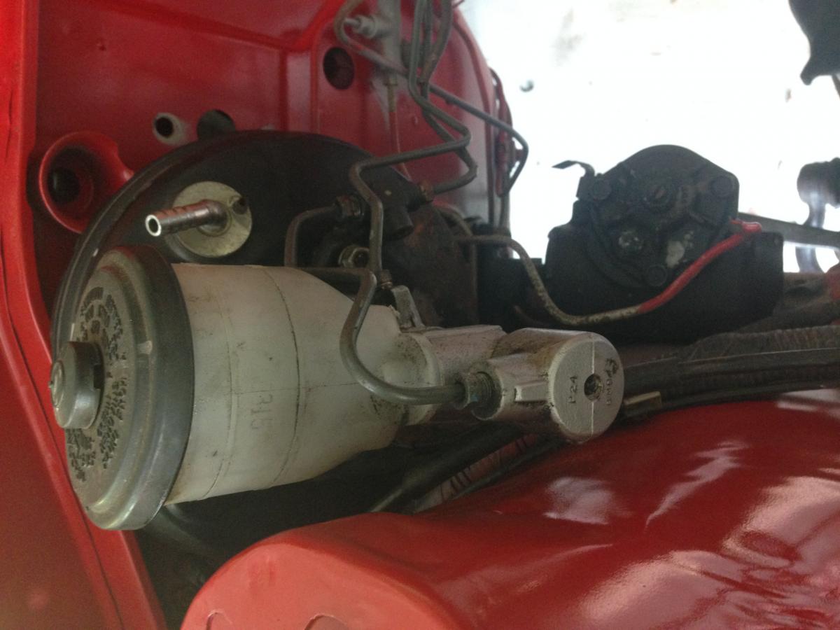

Mechanical Sympathy Posted January 6, 2016 Author Report Posted January 6, 2016 (edited) Drove it out the shed, turned it around and backed it in. Flipped out the 4K/K50, wiped down the engine bay and rattle-canned it red (I ran out of my initial 4 litres of red). Currently molesting my pedal box after wrestling it out. Feeling a bit anxious about how far the dash has been deconstructed to get it out so I'll try and wrap that up asap. Through that process, and trying to convert my brake master/booster to KE30 I've discovered that there might be two sizes of KE30 booster and I have the large one - or it's not a KE30 booster I was sold. So I'm on the hunt for a "small" KE30 booster. Edited January 6, 2016 by Mechanical Sympathy Quote
corollaart Posted January 6, 2016 Report Posted January 6, 2016 There is only one ke30 brake booster ,in aussie cars any way.Just been through this bit , ke 70 have the same bolt pattern but are a lot bigger There was talk of a starlet EP91 ??That was a bolt in but never tryed. The 55 had different master cylinder bolt pattern ( off set)to the 30 s. keep at it Rob 1 Quote
Mechanical Sympathy Posted January 6, 2016 Author Report Posted January 6, 2016 Thanks Rob, good to know - in that case I suspect I have been given a KE70 booster. Quote
Clapped out Posted January 6, 2016 Report Posted January 6, 2016 (edited) Unless it came from a late/update ke30, slightly bigger, so was the ke36 van. Not sure on what the 38 vans ran, 38 wagons were pbr. All 55's should be pbr. Edited January 6, 2016 by Clapped out 1 Quote
Mechanical Sympathy Posted January 9, 2016 Author Report Posted January 9, 2016 I can confirm an EP91 booster would make a great replacement for a KE70 booster. As a KE30/55 replacement it has the same issues as a KE70 booster - fouls on the inner guard (could massage), clutch cable flange (could trim) and the biggie, obscures the clutch master cylinder location. It is nice and short though. *iPhone upload rotator applied Quote

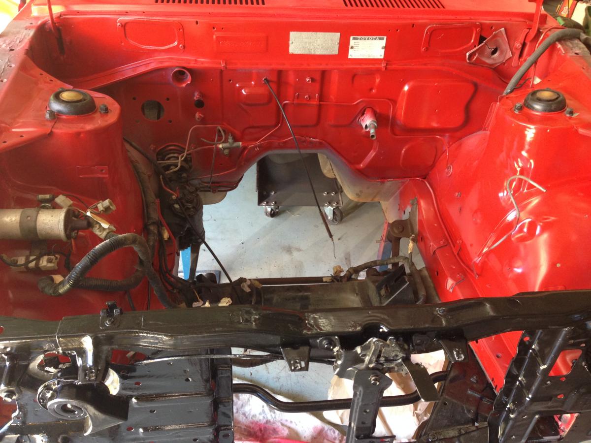

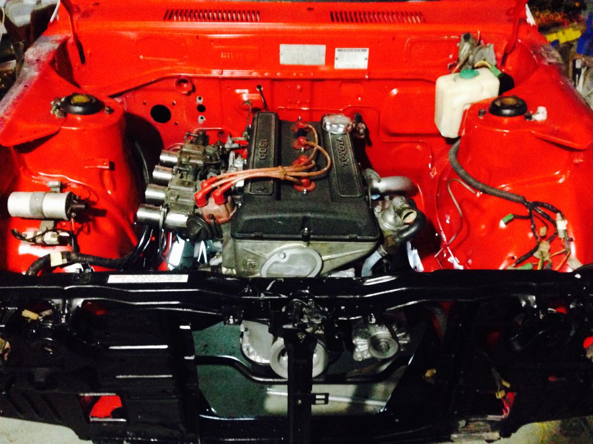

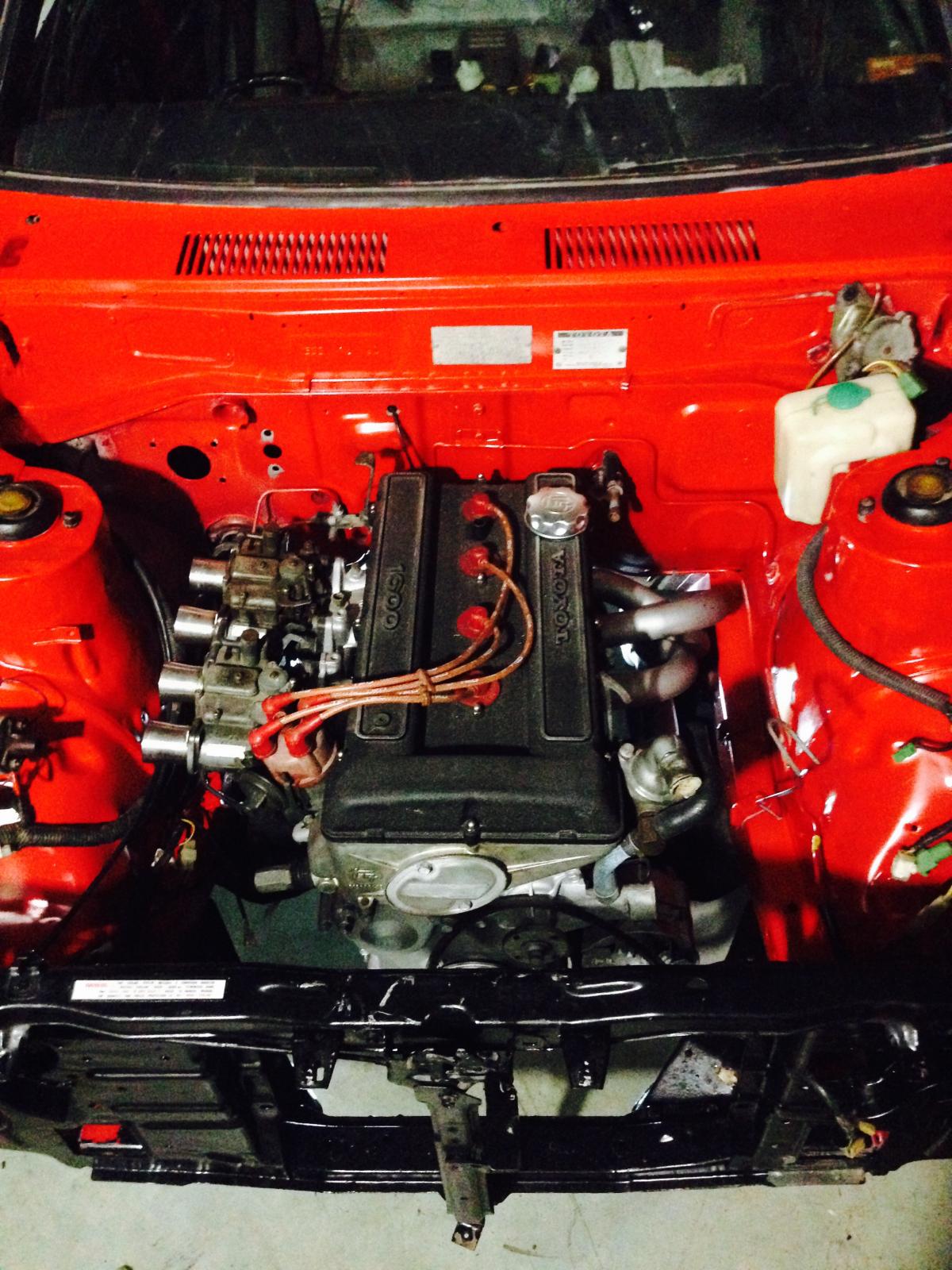

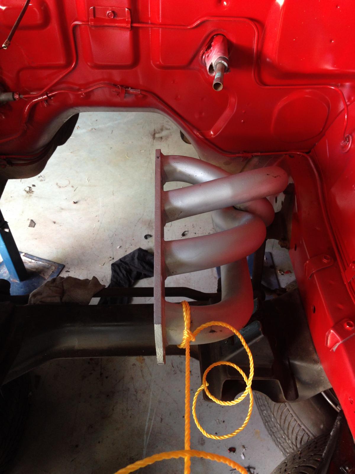

Mechanical Sympathy Posted January 11, 2016 Author Report Posted January 11, 2016 I got jacked off with the brake booster tom-foolery, so put it aside. The next big task I had to undertake prior to installing the engine was to fit the exhaust. I was lucky enough to get a complete exhaust system from extractors to tail-pipe with my engine, to suit a 2T(G) into a KE 3x/5x - saving me several hundreds of dollars. Unfortunately it has no bolted flanges along it's length so I had to drop the rear axle low enough to get it in. First I wirebrushed and painted the whole system in high temp enamel. While the diff was down I painted the entire underside of the car in black bituminous brush-on body deadener, and all over the rear axle and springs with gloss black rust-kill "reconditioning" enamel. Then bolted it all back together before I lost any bolts/nuts/split pins. Now there's really nothing holding me up from dropping in this motor except the need to go to work on weekdays.. It was a big mission (for me) to get this little pipe sitting there! Quote
caibs Posted January 11, 2016 Report Posted January 11, 2016 Very nice build mate, you are doing well 1 Quote
corollaart Posted January 11, 2016 Report Posted January 11, 2016 This going to be cool car ,love your work . Keep at it. rob 1 Quote
Mechanical Sympathy Posted January 11, 2016 Author Report Posted January 11, 2016 Thanks guys - I think the major tasks are just about done now.. Fiddly bits to go! Quote
Mechanical Sympathy Posted February 16, 2016 Author Report Posted February 16, 2016 Firm I worked for 10 years folded in Jan. Had a few weeks panic attack and stopped spending anything on this car but things are working out vocationally. In the meantime I've only really been doing reassembly things that cost practically zero. Interior is coming along but I'll post pics later. Things are taking shape, but need aligning. Passenger door is being awkward for example. Quote
Clapped out Posted February 16, 2016 Report Posted February 16, 2016 C'mon, there has to be more pics? Ha ha! Not good to hear about the job, hope you find something soon! Quote

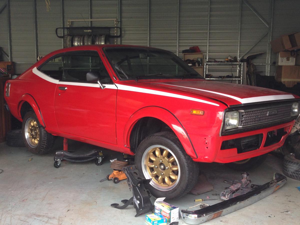

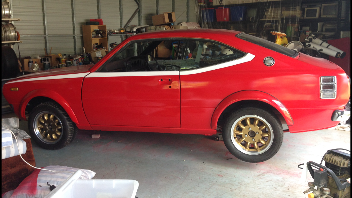

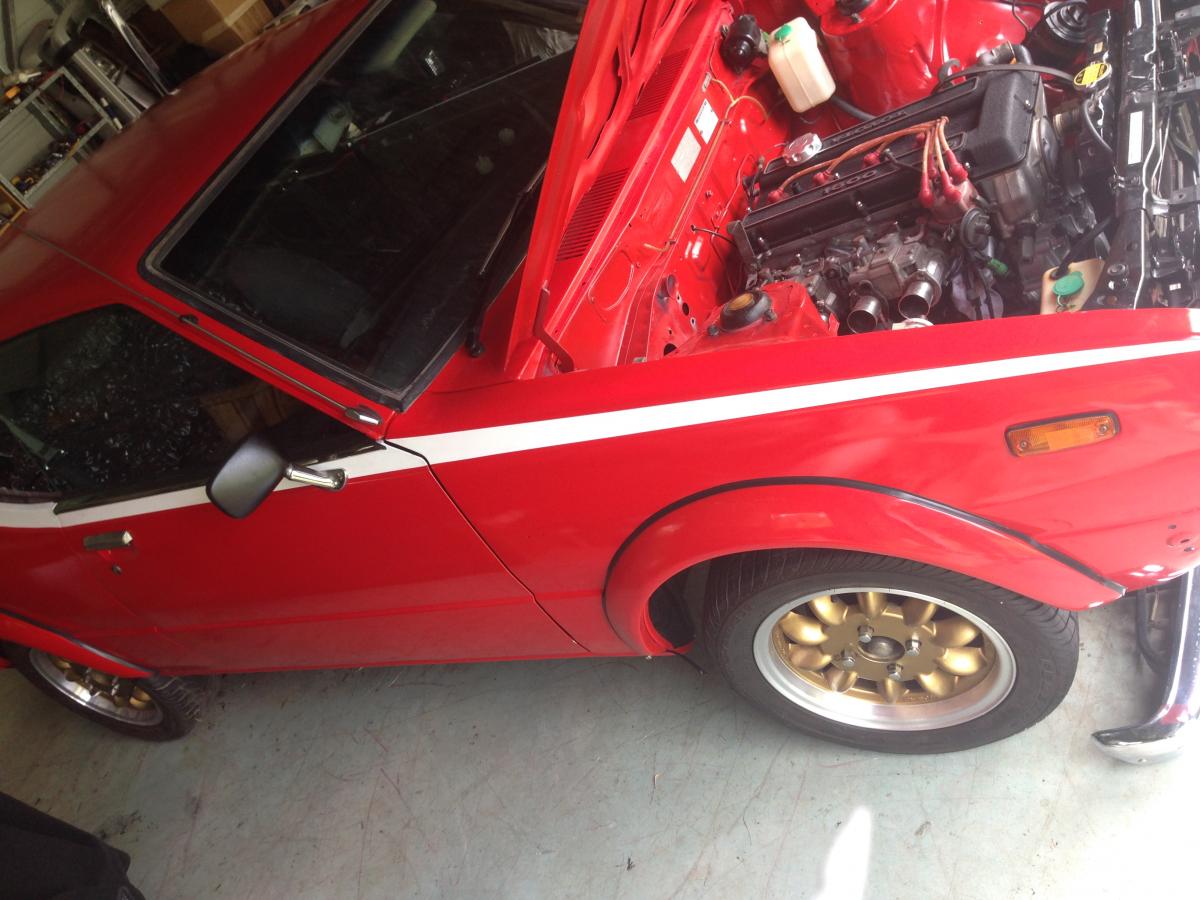

Mechanical Sympathy Posted February 16, 2016 Author Report Posted February 16, 2016 (edited) Thank Mat! Employees come first in liquidations these days and I started work today so silver lined clouds prompted me to put in this burst yesterday. But as far a pics, it's all out of shape - I have to drill out snapped bolts in the bonnet latch and adjust door hinges. One flare bolt doesn't quite work, therefore one window isn't in and I might pinstripe over paint lines pending door alignment blah blah hah. If I don't do it first, someone here will be thinking it! Looking forward to working through the finishing jobs now; radiator, carbs, interior, fuel supply, intake and PCV, brakes, cert & rego Edited February 16, 2016 by Mechanical Sympathy Quote

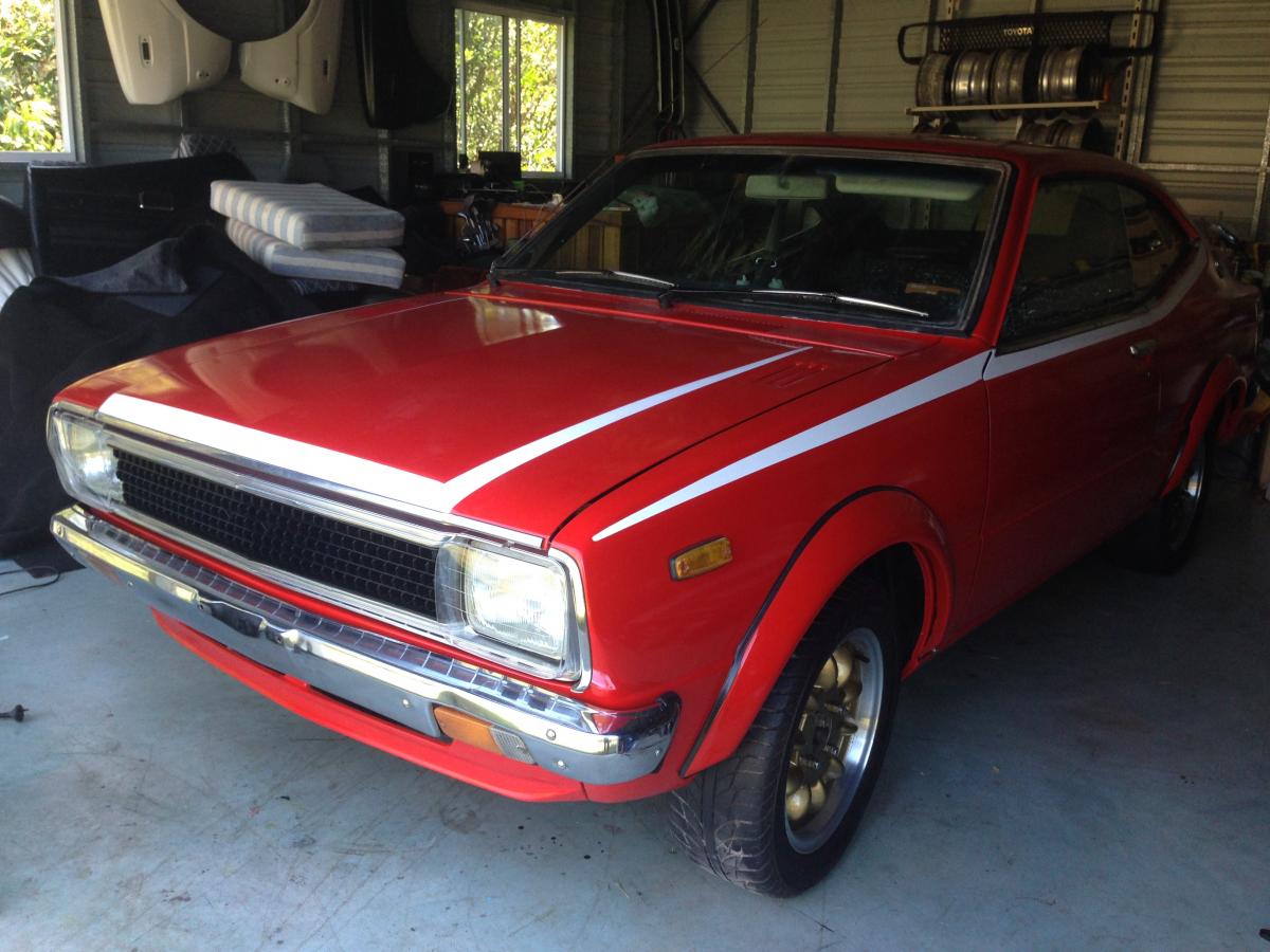

maccat01 Posted February 25, 2016 Report Posted February 25, 2016 Are those wheels original style performance superlights mate? Loving the fitment :-D What offset and width you running? I'm fitting 2 inch flares to my car shortly and I have been looking for pics of what a decent sized set of flares will look like. Your flares look the goods! Nice job :-) Quote
