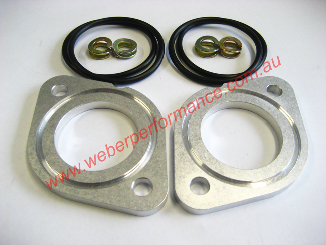

altezzaclub Posted November 23, 2017 Report Posted November 23, 2017 Soft mounts are tricky. They have to be tight enough to hold pressure on the rubber O-rings & seal, but loose enough to allow the engine vibrations to be absorbed. Hence the Thackery washers. The 20mm odd thick rubber ones are great, but the little thin one-piece O-ring types just fall apart after a year or two. If you don't have any there's a chance of the fuel in the bowl becoming a foam at certain revs, but that may never happen. 1 Quote
Mechanical Sympathy Posted November 23, 2017 Author Report Posted November 23, 2017 Foamy fuel is what I was worried about initially but it doesn't seem to be a problem so far. These ones would be next on my shopping list if that occurred. $120 though.. I'm done spending! https://www.weberperformance.com.au/product_info.php?cPath=115_101&products_id=236 Quote
