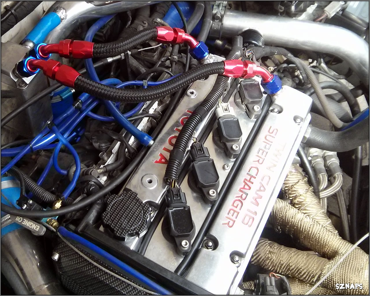

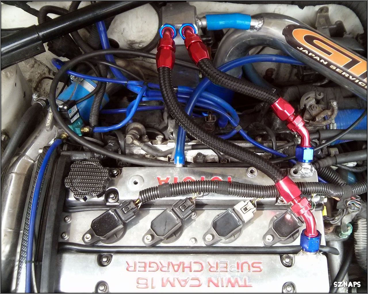

Sznaps Posted November 20, 2013 Author Report Posted November 20, 2013 one thing that is remaining to do is to increase engine vent. with 1.2b max boost I noticed after this season that my oil pan is sweating oil on seals after some harder riding. I have put fresh seal at the beginning of this year so my conclusion is that engine cannot vent itself efficiently enough and what I'm gonna do this year or at the beginning of next - I will bore existing vent and add another to second cam cover moreless like on this photo below. It does the job in cosworth escort so should also do the job here. How is the technical name for it in english? Is it crankcase breather vent? Quote

Sznaps Posted May 12, 2014 Author Report Posted May 12, 2014 (edited) ok last piece of puzzle installed (vents) and already tested. much better :-) Edited May 12, 2014 by Sznaps Quote

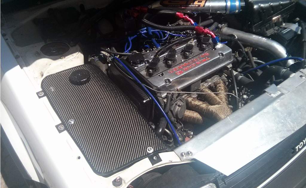

Sznaps Posted July 19, 2014 Author Report Posted July 19, 2014 just cosmetic added cover to hide second air filter (pics below) and small update regarding additional engine venting - works wonderful. no oil sweating. I say it should be done on 4age when pumping over 1bar - stock venting seems not enough then. Quote
