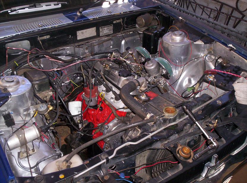

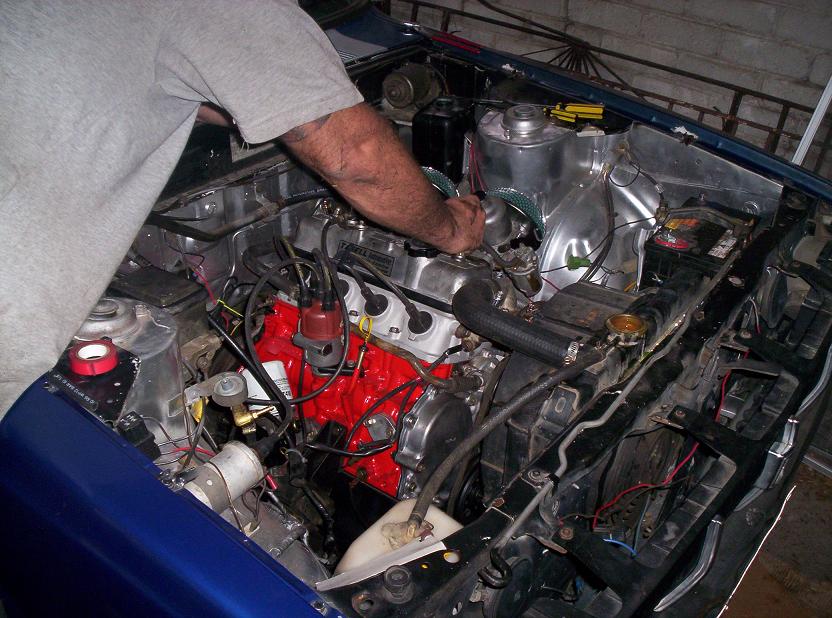

SLOTH Snr Posted March 20, 2006 Author Report Posted March 20, 2006 To run it in Craig has been told to drive between 2000 and 5000 rpm for the first six hundred kms. today he was complaining that he can't get out of third gear most of the time and is still waiting to use fifth. The guy who put it all together for us took it for a run yesterday to bed the pistons in. He hit 7000 in fourth and scared the absolute shit out of me. :D I'm use to having a big car around me at those sort of speeds. Carbies are leaking a little air so we will get them sorted as we run it in but all things look pretty positive. We will get it dyno'd in five or six weeks andthat will tell the tale. It is so ;) cool Quote

SLOTH Snr Posted March 21, 2006 Author Report Posted March 21, 2006 We're using a 3k sump. chev solid lifters,theres many a thread about the fact the stand GM solids fit perfectly in a K motor The E.F.I. was already gone when we bought it I'm using a Lynx manifold(direct from Lynx saved heaps) and I need to make extensions for the carbies as the 7K doesn't seem to lean over as far as the 4K's do. Quote
