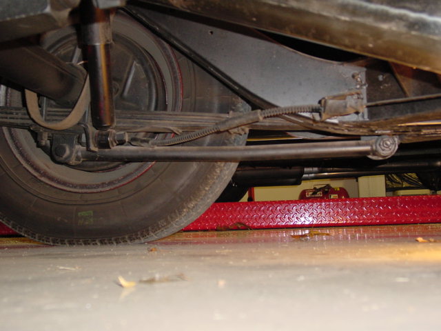

altezzaclub Posted April 12, 2016 Report Posted April 12, 2016 Do you think by seam welding the rear end will be enough to convert it to coil overs? nope- look in a KE70 and see how they re-inforced the body where the springs push the force to. Sme with the link arms, they need to spread the force into the floor so they don't tear out. Nce idea though. You wouldn't settle for just the bottom arms being fitted onto the leafs? Quote

altezzaclub Posted April 14, 2016 Report Posted April 14, 2016 Like this- They keep the leaf spring but locate it in place. Quote
styler Posted April 17, 2016 Report Posted April 17, 2016 Those arms above are caltrac bars which may go by a few other names but are essentially traction bars. To get lower in leaf spring setups you can invert the eye/eyes of the leaf springs and also reset the pack at a lower height. Remember the car is just a shell with no weight in the back at the moment, once assembled will drop in height as well. Quote
