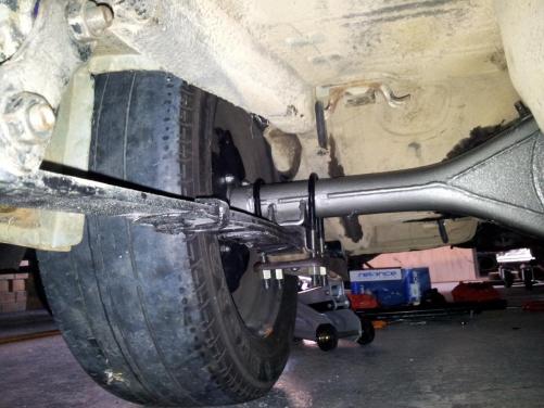

I got a 71 rn25 hilux diff in my car but am struggling to ft bf facon 16x8s on it (keeping in mind rn25 diff is the same width as the ke30 one). I got bout 10 mm tub clearance, bout 5mm leaf clearnace and 9mm guard clearance with the 35 offset falcon wheels, this is with 215/45r16. You gunna run flares?
Just think you being a little too ambitious with your wheel offsets unless you tub it. But give it a go anyway :)

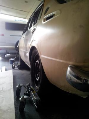

If you getting the diff cut down to identical size as ke30 dif then I can't see you running 12 offset. I posted above some pics and my measurements. When my discs are on the car thay will push the wheel out another 10mm caus of rotor mounting face so ill have to roll the guards and maybe flare them out a little. But that will give me an extra 10mm clearance to the tub and leaf springs. I'm pretty sure with the right offset wheel you'll get 9 inch tyres under the rear end :-D. Not real wide but with a good set of yokohama advans or similar should have plenty of grip.
The stock falcon tyres are on there atm so are a bit tall but are still a pretty good indication of clearance. My rear end is also dropped three inches as well which was a miscalculation on my part haha.
Edited by maccat01
I just checked your working on ya rear offset.
My wheels are 8 inches wide so check the above pics if your offset is 12 then youll deffo need to flare the guard as they will be 23mm out further then mine. And the above pic is without the discs mounted too. When its out the extra 10mm then the Guards will need rolling on my car. So if you go 13mm out pass that then youll need a small flare job. Although I recon they look good with the rear flared out abit as it matches the front better and gives it an extra line below the rear doors. Classly stuff :-)

If you want 0 offset and huge dish then your diff will need to be 35mm a side shorter then normal. Or flip side you can run 35mm flares. My rear is sitting flush with body at +35. If you want I can get some better pics for you to show clearance. Just let me know.
Are you measuring to the hub mounting surface inside the rim. I also made a mistake measuring first up but then measured rim width and halfed it then drew a line mid way around inside of wheel to see 0 offset. I did try 0 offset globe wheels off a bathurst gtho and couldnt lower the car over the wheels lolol. Would have needed two inch flares... like a torana slr hahaha
