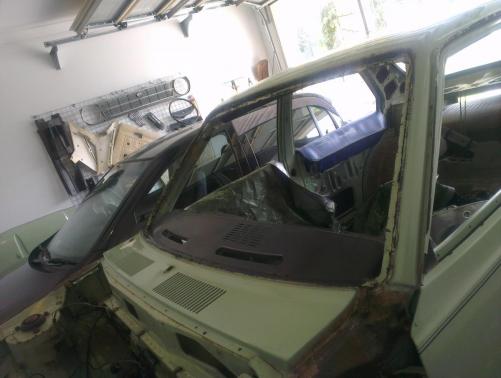

Small update on Betsy.

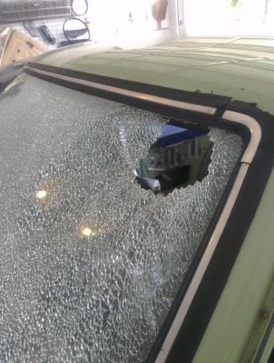

As you guys and gals are most likely aware, I had a small moment of insanity and put Betsy for sale both on here and on eBay. This was due to me doubting if it was even possible for me to continue let alone complete this build. This lapse was (I think) due to the new bubs being almost here, working unheard of hours at work, and then coming home to work on the house. However after talking tonight with another mate I soon received the reassurance I required.
Now all glass but the rear window is out. I tried to get the front window out in one piece but as you can see from the pictures I failed and the loud POP of the window made me jump. So I tarped the inside and out came the hammer of Thor to knock it in.
You need to take the locking trim out before you can remove the windscreen ( I know this is a bit late ) but now you will know for next time ;) the rear window will be the same , good luck with the build and keep at it :thumbsup: .
Cheers:- Stuart ( Thomas dad ) :wave:
Thanks for that Stuart, because I will be replacing all the seals in the whole car I actually cut the inside of the seal with a Stanley Knife, so that it was only the horrible tar like gunk that they use holding it in. Next time i know not to start at the corner of the windscreen for the weight and lack of flex in it was what made it go POP!!!
