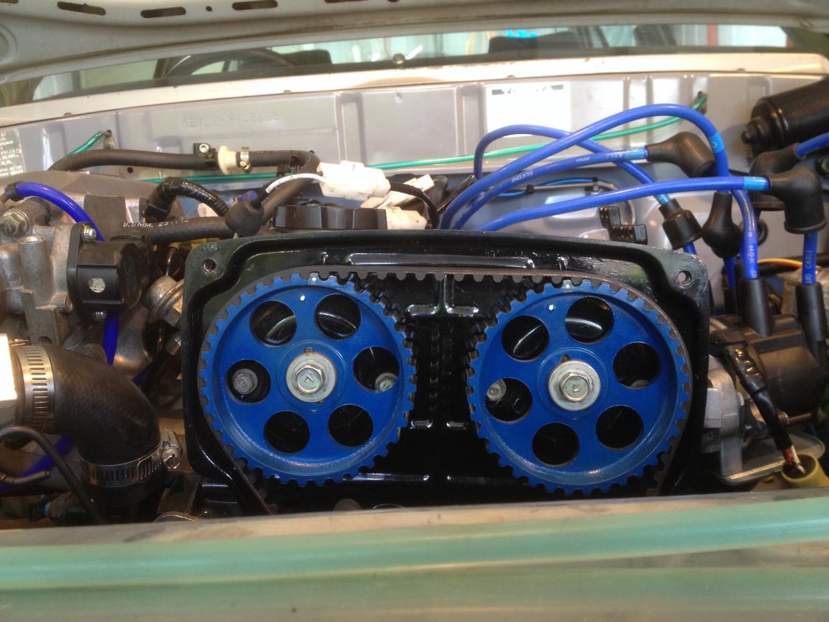

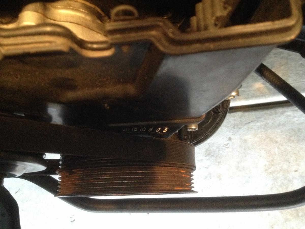

Anthony13 Posted November 10, 2013 Author Report Posted November 10, 2013 Update!! Okay so I put everything back together on my car and I installed an adjustable fuel pressure regulator with a gauge on it as I was told my issue of not idling could be a low fuel press issue! Put everything back and the car would turn over fine! But just it was like I was getting no spark i then managed to get the car to start and idle and it hold it's idle fine however it sounds like a tractor! I've tried two different map sensors and no luck there!! I checked my timing marks I set #1 piston to TDC and everything seems to line up okay but if someone can confirm that I've got everything set correctly that would be great thanks! Or if anyone has any ideas as to what's wrong with it now that would be good also! Quote
B.L.Z.BUB Posted November 10, 2013 Report Posted November 10, 2013 Check the crank timing marks by the sprocket instead of the plastic cam belt covers just in case. Where are you located? Quote
