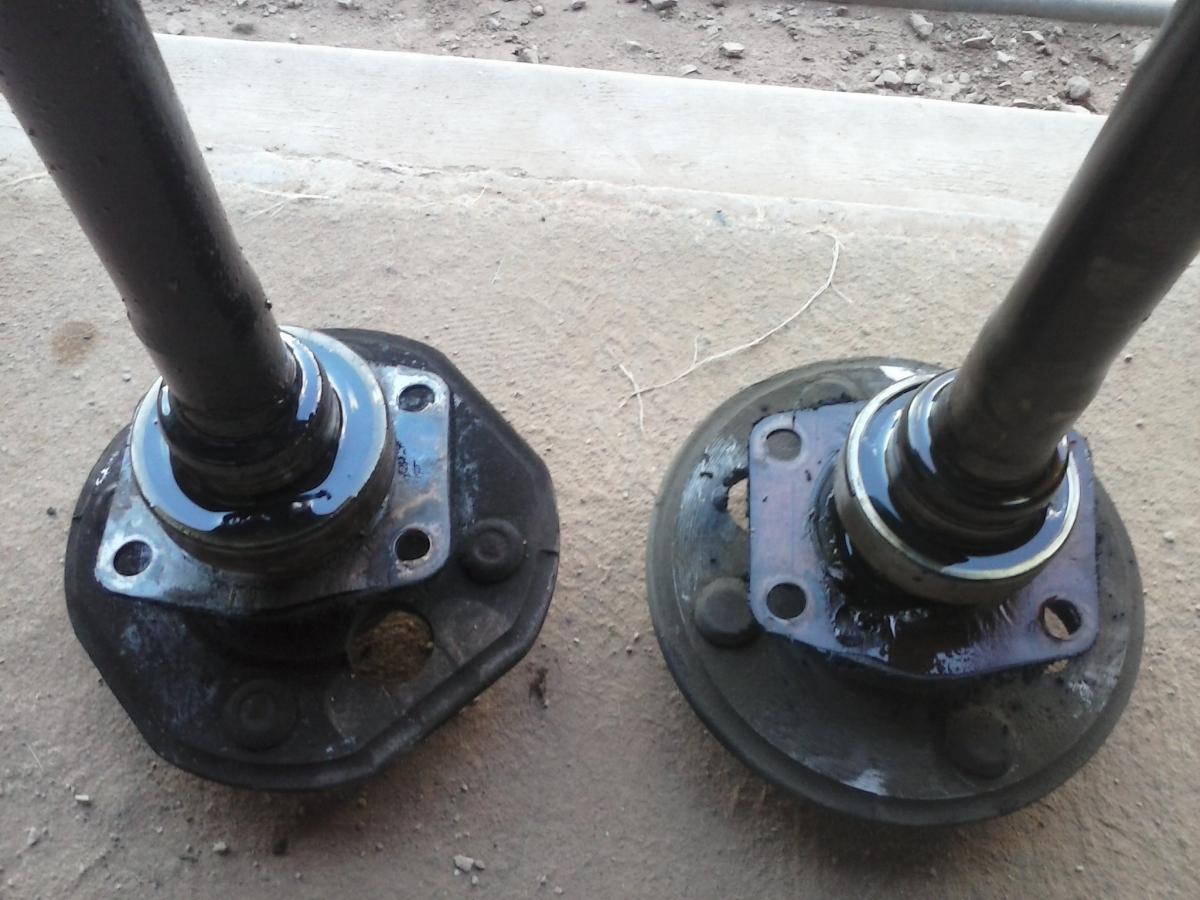

Angus_257 Posted January 28, 2014 Author Report Posted January 28, 2014 (edited) got the center off the adm ae86 and the axle compared to the panelvan length wise, seems the same (without measurements) but the 86 has a smaller OD on the bearing than the KE70 panelvan measurements. ADM AE86 62mm. JDM KE70 66mm, as the bearing on the 86 looks new i was going to swap them over BUT they are different. the axles both measure the same OD. Edited January 28, 2014 by Angus_257 Quote

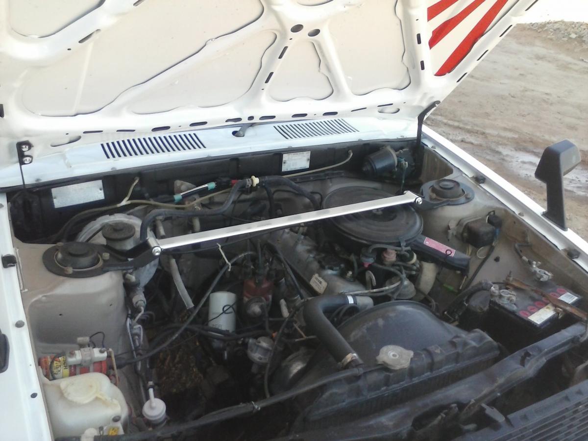

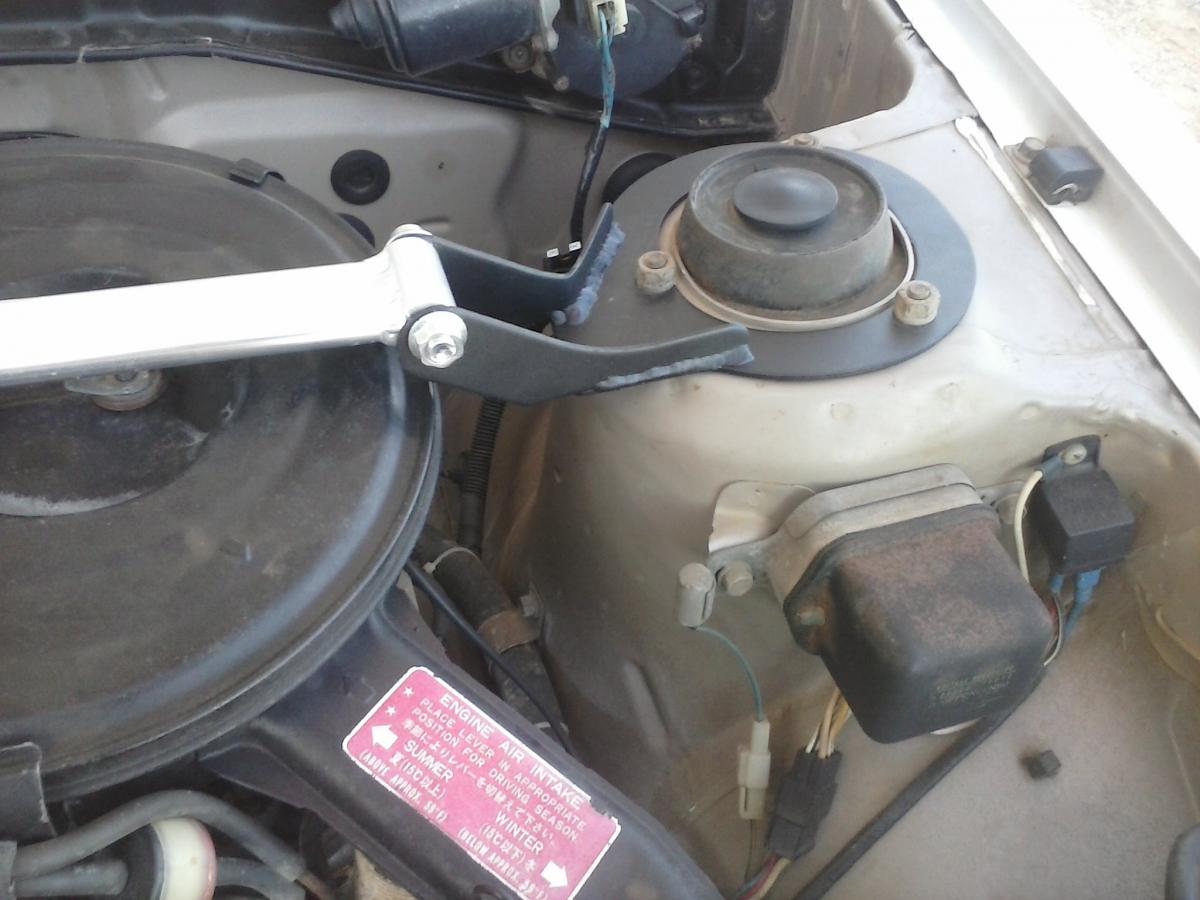

Angus_257 Posted January 29, 2014 Author Report Posted January 29, 2014 new strut brace ordered from Ebay arrived today, for an ae86 so had to elongate the holes a bit, but for 70 dollars you can't complain! and a picture of the 86 axle along side the ke70 axle..... Â Â and my most hated part about this car :fuzz: Quote
Angus_257 Posted January 29, 2014 Author Report Posted January 29, 2014 Ke70 is left, 86 is right ^^^^ Quote
