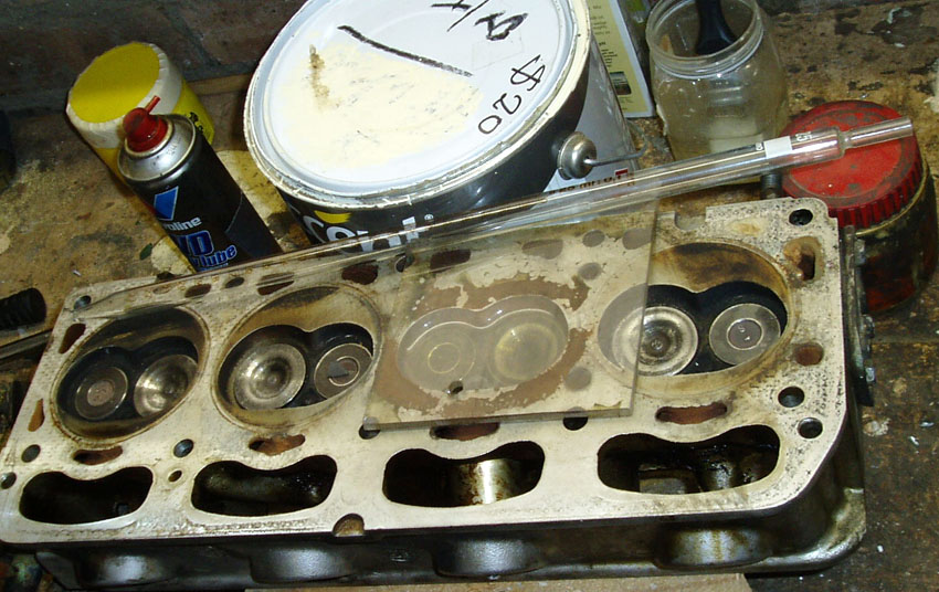

and i have to measure the cc tomorow... dunno how but I'm gonna try
Plastic sheet between 1mm and 3mm thick is easy to find, it just has to be big anough to cover one cyl. drill a 5mm hole through it & seal it with grease around the edge.
25ml graduated burette or pipette is best to measure the liquid, use kero or turps or similar. Each combustion chamber will take around 30cc,so you run in 25cc the refil the burette for the rest. Burettes have a tap on the bottom, so are expensive. A 25cc graduated pipette will also do, you release drops by turning it with your finger over the top.

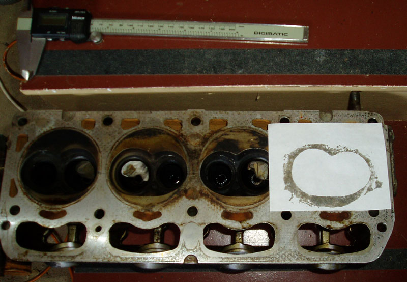

You calculate the amount to skim off by measuring the area with graph paper, then working out what size "column" to take off to get the ratio you want. Everythin else like cylinder volume and head gasket volume is known and fixed. Post up here if you want a lecture on it...

i tred my best... i filled it up with kerosene then sucked it up with a thingy and put in in a glass and brough it home.. measured 27milli liters... forgot to do the paper thingy... :(

here is a pic of when i checked the ML of the chamber.. its a little bit higher on one side ... so i think 27ml is a bit under what it really is, i migh have spilled while getting it out there aswell? i don't know?

27ml is less than I expect, unless its a 3K head (or one of the 5K variants). The sheet of plastic makes it much more accurate as it fill up evenly to the hole you make in it.
My 4K had 31cc and the graph paper added up to 30sqcm.
So for me-
Head volume 31ml
Gasket volume = Pi X radius X radius X thickness= 3.14x3.95x3.95x0.15= 7.35ml
Cylinder volume = 322ml
compression ratio 322+31+7.35 to 31+7.35 which is 9.4 to 1.
Skim 1mm off, you will remove (chamber area X 0.1)ml whch is 30Sqcmx0.1=3ml
Now you have 322+(31-3)+7.35 to (31-3)+7.35 which is 9.86 to 1.
So you can see how you use the head area from the graph paper to calculate how much to skim off to give you any compression ratio.
If you really have 27ml in the chamber your figures would be 322+27+7.35 to 27+7.35, which is 10.4 to 1, before you skim it!

OK, you just change the 4K stroke in the maths to your 3K stroke. So the cylinder volume is smaller, but the head gasket volume & the combustion chamber area stays the same. I would expect the combustion chamber volume to be about 27ml, I think that is what Richard got for his 3K head on the 345K we built. However, his 3K head had the whole combustion chamber sunk into the head a mm or so, giving a circular ridge all the way around where the head gasket sits. Maybe someone else on here can explain that.
I reckon 0.75mm off will give you 10.0 to 1 but you can check that using your cyl volume of 291ml and chamber of 27ml.

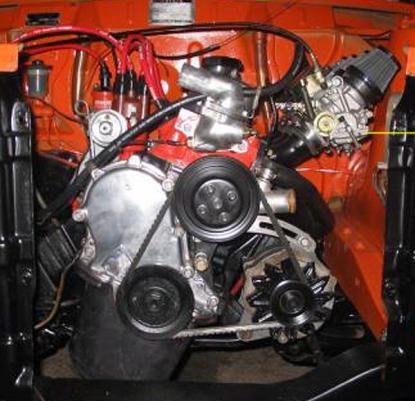

You can measure the Mikuni's diameter with calipers. They'll be somewhere between 36 and 40mm I expect. See the one slide that is not sitting equal with the others? Make sure they all move up and down in synchrony. Best thing is, search the net for everything you can, or find a mechanic locally who knows about them, and strip them down & clean them. Check the diaphrams and gaskets for leaks, the jets for dirt and see what can be lubricated..
The size of the carb exit into the manifold will tell you the manifold tube size to use, and that should match up with your inlet ports on the head. I'm sure they will work on your K motor, they just won't get fully exercised! You will need some curved manifold tube to allow for the sloping K motor, you want to end up with the Mikuni fuel bowl horizontal.

you sure about the carbs sitting horizontally? iv seen severals that got bike carbs at 45 degrees etc.. but ill do some research on my carbs to find out :)

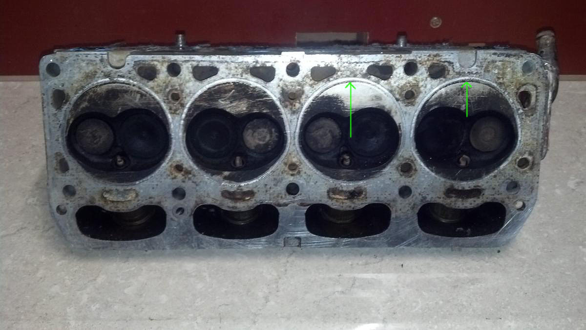

Here is a picture of what your ports should look like! The 3K bigport picture.
http://www.rollaclub...400#entry691400
With this photo note the way the combustion chamber is sunk into the head a little, maybe a mm or so. There is that ridge running around where the head gasket sits. It makes me wonder if your head is a 3K that has been skimmed, or not a 3K but a 4K, as they are a flat head. Do the liquid measure again carefully and see what you get.

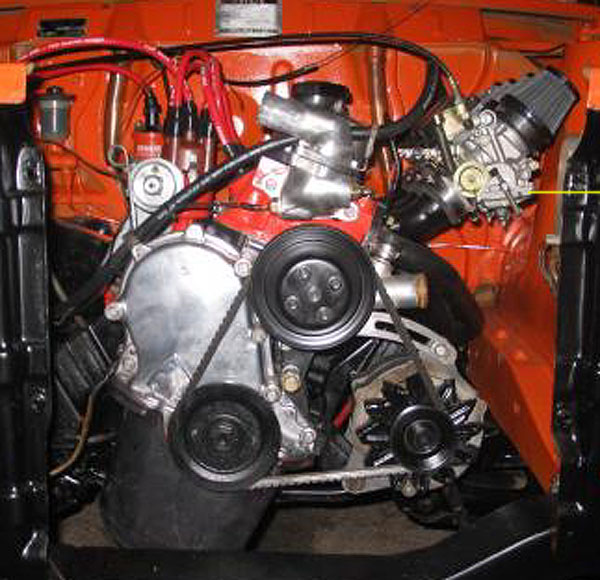

At least you have the Mikunis sorted, I thought your Dad would either know all about them or have a good mechanic locally. I think they sit with the seam of the float bowl horizontal, so the body still sticks upwards. I don't know how bad it is for mixture if they are at completely the wrong angle, but they were designed to be leaned over sideways and still work! This photo is from Tommy's car of the year- Anyway, find a set in a bike or something still factory-fitted and see how they hang.

Yeah LHD Corolla with k enigine is a pain in the arse! inlet, exhaust, starter brake and steering all in the same place, for e.g a turbo setup i think you would have to uppright the engine.. :P
