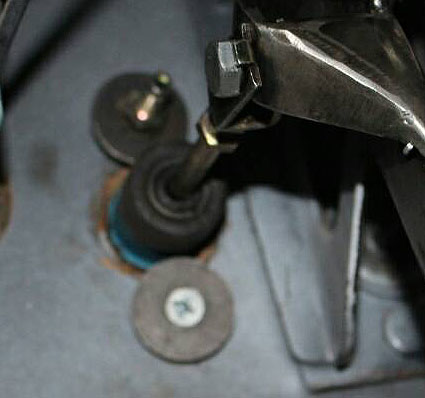

SM Hunter Posted June 17, 2015 Author Report Posted June 17, 2015 (edited) Thnks a lot for all the tips! assembled the engine but i need to tighten the head to toque specs :) installed a clutch pump... clucthpump in the middle test fitting engine Edited June 17, 2015 by SM Hunter Quote
altezzaclub Posted June 17, 2015 Report Posted June 17, 2015 Not a lot of room for air cleaners with the wide heads! Those clutch screws look pretty weak. Usually the are 8mm bolts. Quote
SM Hunter Posted June 18, 2015 Author Report Posted June 18, 2015 (edited) i have mesh filters ;) don't worry ... the upper one is orignal had to space out the lower mount of the pump to align it better with the pedal, the screws are big enough :) bad pic :) Edited June 18, 2015 by SM Hunter Quote

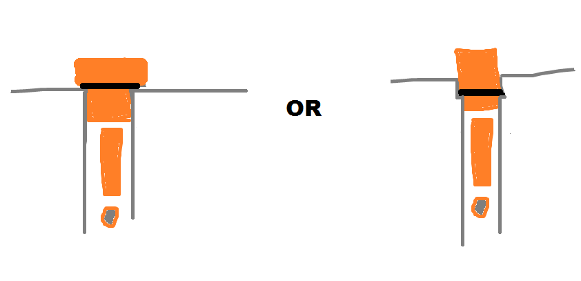

SM Hunter Posted July 15, 2015 Author Report Posted July 15, 2015 fund out its supposed to sit halfway up, but i know this question is pretty stupid but i just want to be sure... O-ring up or O ring down? i don't know if its sealing something in the chamber top or whaterever? Quote
altezzaclub Posted July 15, 2015 Report Posted July 15, 2015 Is that an air jet? If the top is wider than the thread, then the O-ring goes just under the top rim and seals against the carb body, like your left-hand picture. If the screw is straight-sided then the O-ring must seal under it, like your right-hand picture but right underneath the top screw. It should screw down firmly on something, not just sit somewhere without screwing in properly. I'm a Weber man unfortunately, so I haven't had Solexes apart. Quote
SM Hunter Posted July 15, 2015 Author Report Posted July 15, 2015 (edited) sorry for a really bad explanation but it studied the manual and found out how its suposed to be :) i think they are part of the accs pump assembly.. anyways, the accs pumps worked liek a dream! squirted like they should, atleast i think! got the carbs back on the engine.. 1 problem less! now i just need braided fuel hose to go with my fancy fuel lines Edited July 15, 2015 by SM Hunter Quote
