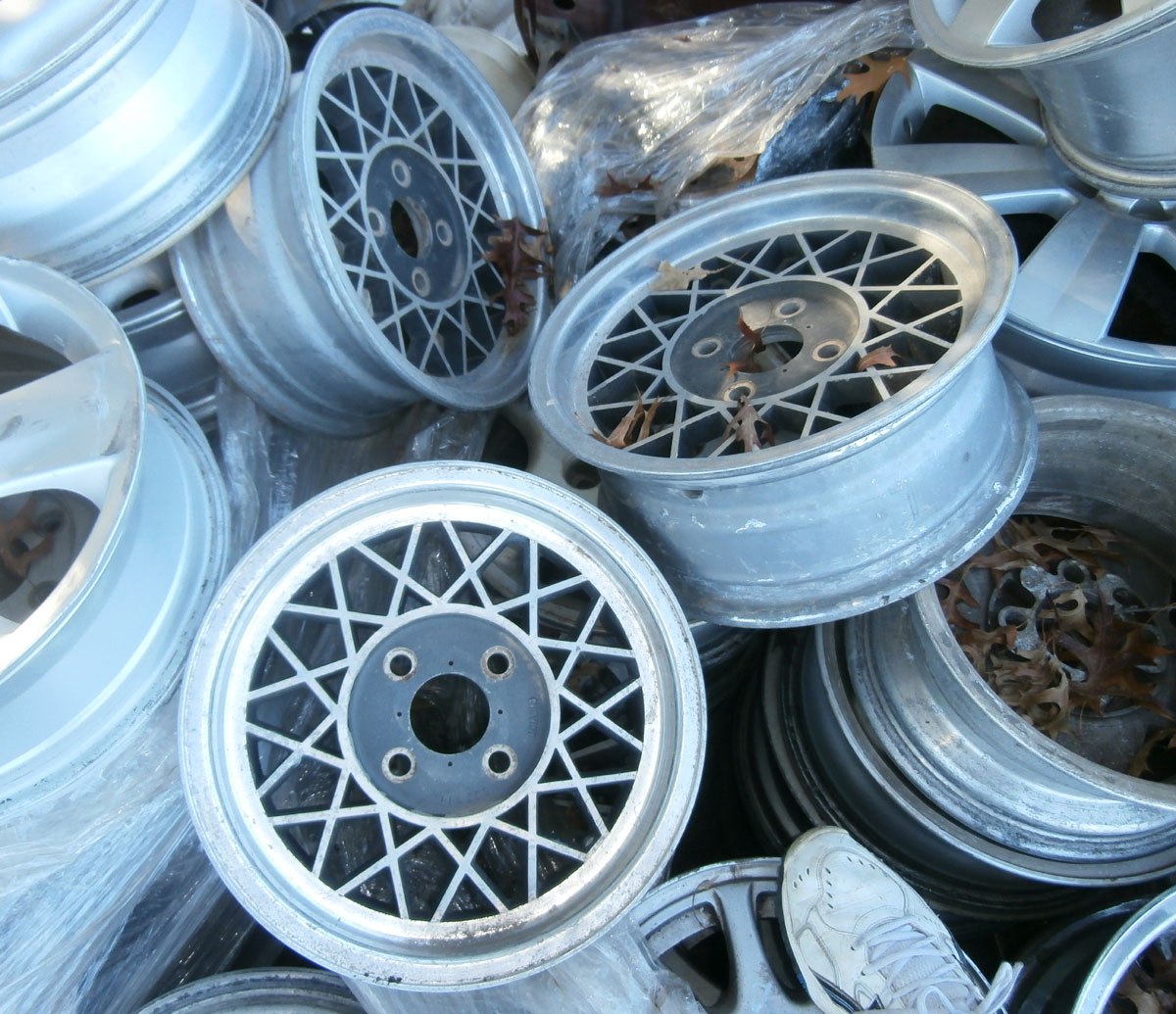

SM Hunter Posted May 3, 2015 Author Report Posted May 3, 2015 yeah, it sounds like its too lean :) are theese too big for a KE20? :) they are like 1/2 price... and yeah i know they are 4x108 but i can't find ANY 4x110 here... if they are too big I'm tinking about fitting escort MK2 fender flares, the boxy ones.. :) http://m.finn.no/bap/forsale/ad.html?finnkode=57844362&page=3&q=4x108&ref=fas Quote
altezzaclub Posted May 3, 2015 Report Posted May 3, 2015 I've got this set lying around if you want something more suitable for the period. They're 14x6 & fit Corollas, typical of the 70s and 80s rally cars. The freight from Aussie may be a killer though. Quote
SM Hunter Posted May 4, 2015 Author Report Posted May 4, 2015 ouch it hurts to see something that fits but i can't get hold of... i don't think its worth it shipping them all the way here... not going for the huge wheels i linked to but i want some new wheels! I'm thinking of trying some escort mk1/mk2 wheels, and going for som escort mk2 BDA fender widners... anyways, here is the internals of the engine... I'm going to put worked and the seized engine together and get one working engine WITH valve stem seals! so I'm going to take the head of the seized and put heavy duty springs on it, regrind the valves and mayyybe shim the head, but i don't think i have the money for that now... Quote

SM Hunter Posted May 12, 2015 Author Report Posted May 12, 2015 Got hold of 2 sets of Ford Escort RS rims. one of MK2 and one unnown but ill post pics this weekend :) a local photographer asked if he could take some photos of my old rolla... Painted the centers black rally quick , ill take them off this weekend and polish the lip and do some more painting :) Quote
altezzaclub Posted May 12, 2015 Report Posted May 12, 2015 You can make a tool to clean the ports in one minute. All you need is a length of steel rod about 5mm diameter, maybe 10mm long. Round one end and cut it down its length with a hacksaw for about 40mm. You put it in a drill and slot a length of sandpaper into it, and the spinning sandpaper will polish those ports up fine. or for a few bucks you can buy a sandpaper flapper wheel. Looks good with those wheels! Quote
