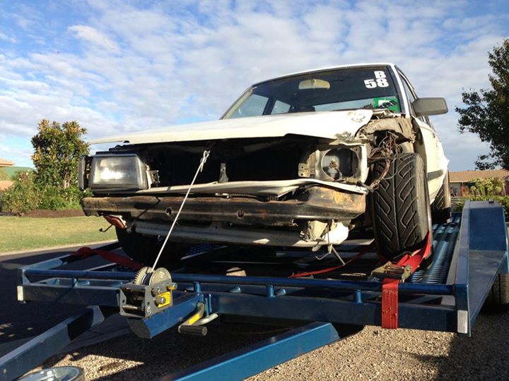

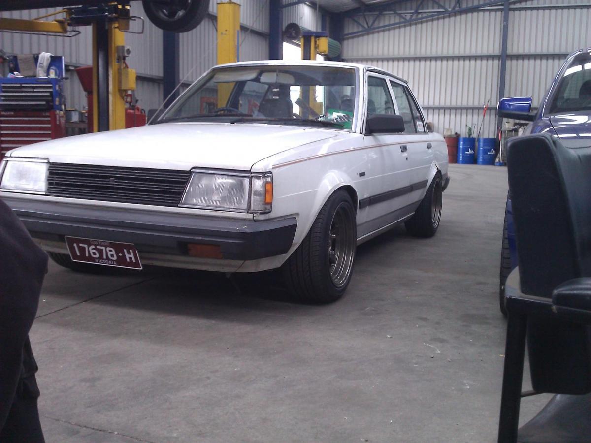

I started off buying a white slanty 4age ke70 from SA, left Melton at 5:30am, drove to the other side of adelaide and then drove this corolla back with no heater & a locked r/h/f strut for 7 hours at 4,200rpm.
It was standard bodied on 14 inch cressida steel wheels.

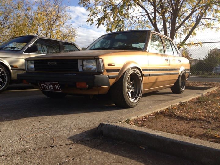

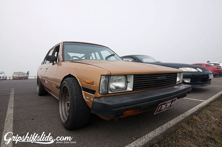

I cut the springs and fitted a set of rota grids & cheap china tyres then it looked like this.

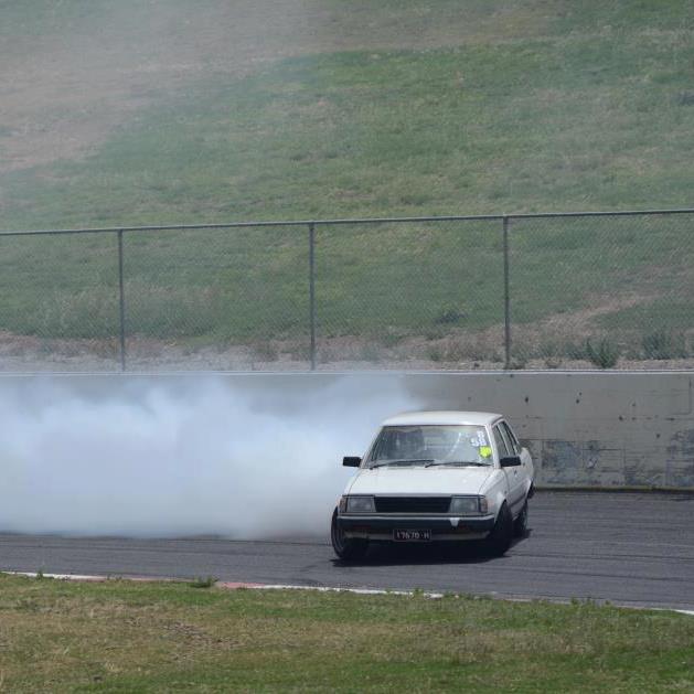

Went drifting with it

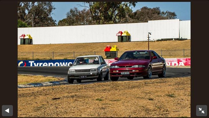

Decided I'd have a go running it around Winton with my friends in their r33 gtsts, Best time of the day first time ever on the track was 1:52.4

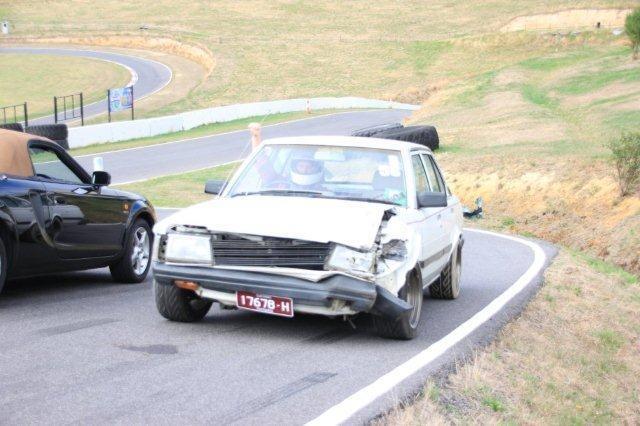

Third time taking the car out racing was at the Bryant park "haunted hills" hillclimb. Best time of the day was 61.8 seconds. I tried too hard after my 2nd timed run and managed to put it into a tractor tyre wall. Fair ʞ©$ɟed it too.

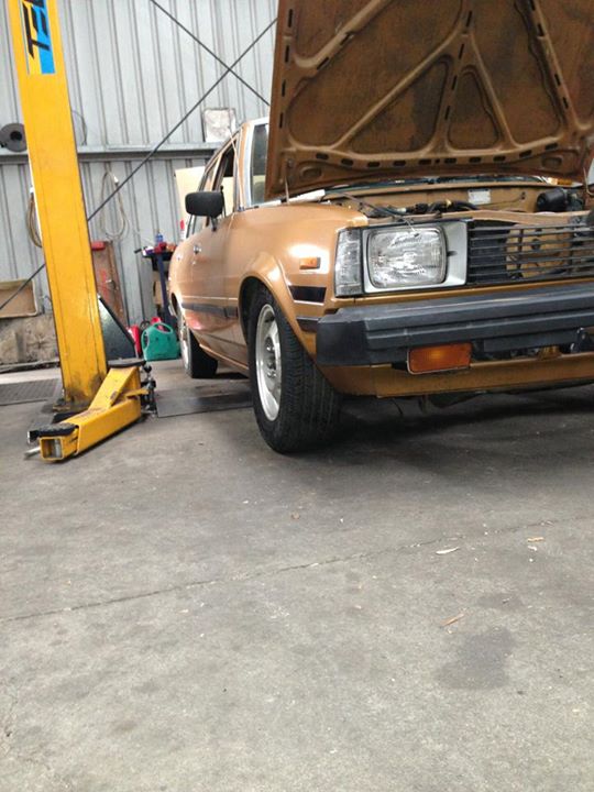

Add BC coilovers

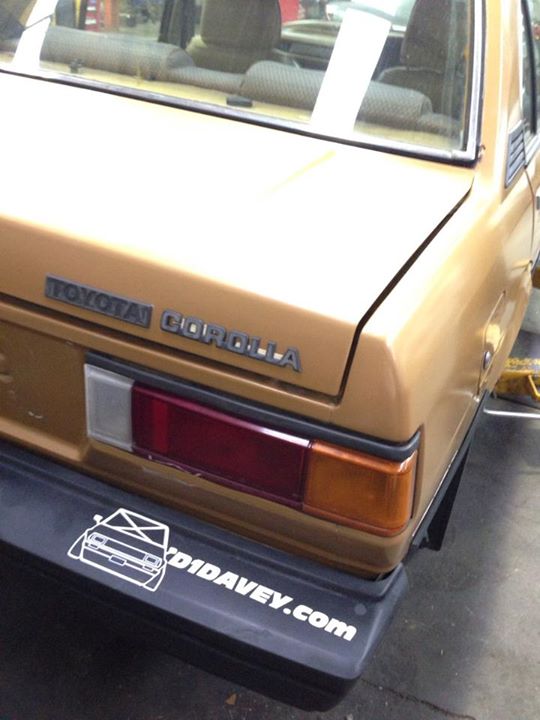

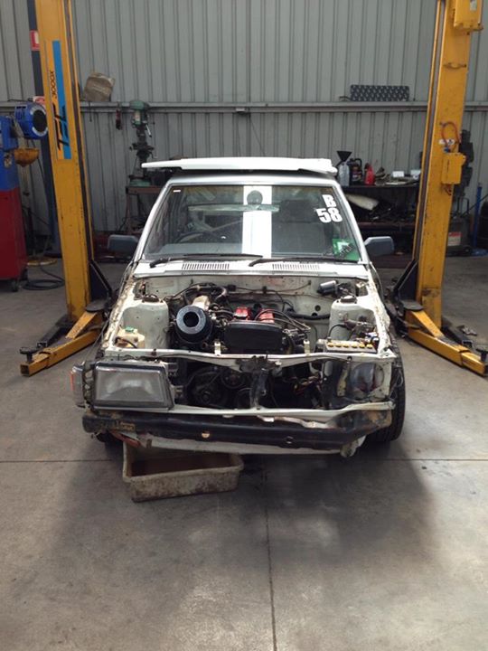

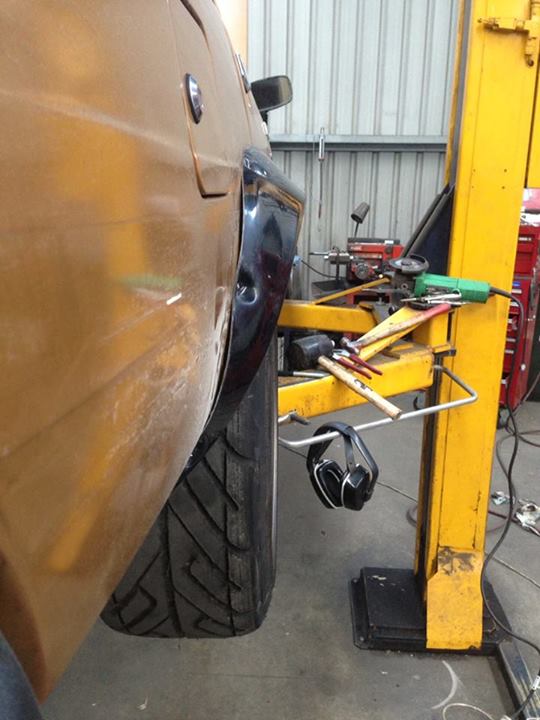

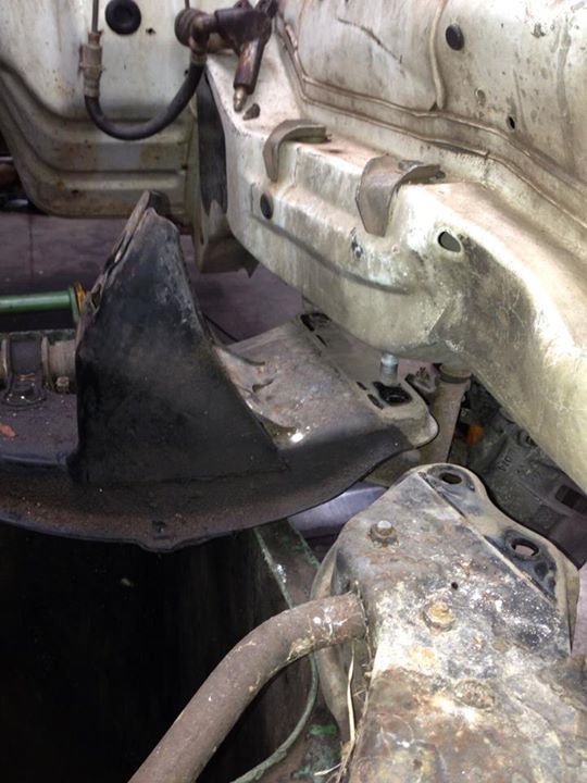

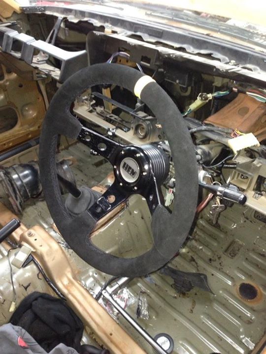

Reshell begins, hours and hours and hours of work.
post-13485-0-08513500-1374582224_thumb.jpgpost-13485-0-40936200-1374582232_thumb.jpgpost-13485-0-35998800-1374582239_thumb.jpgpost-13485-0-49025400-1374582247_thumb.jpgpost-13485-0-05751000-1374582259_thumb.jpg

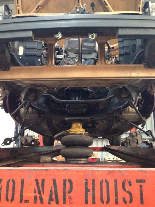

Check out how far that rail is pushed up!

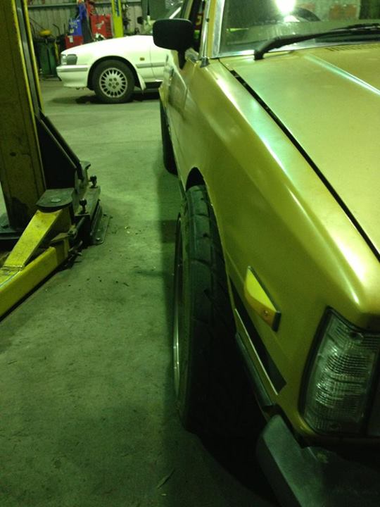

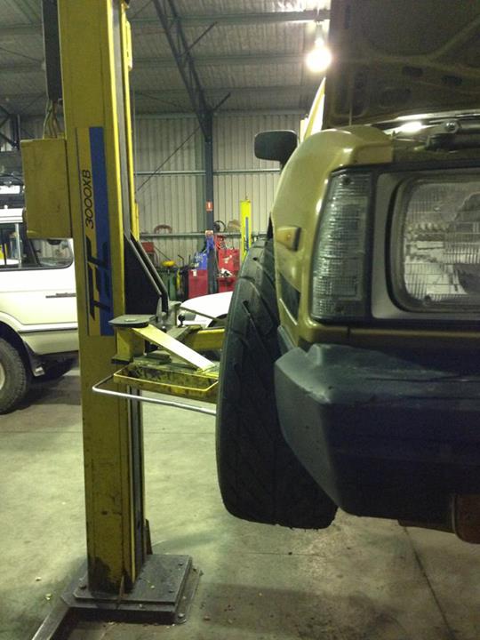

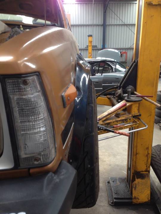

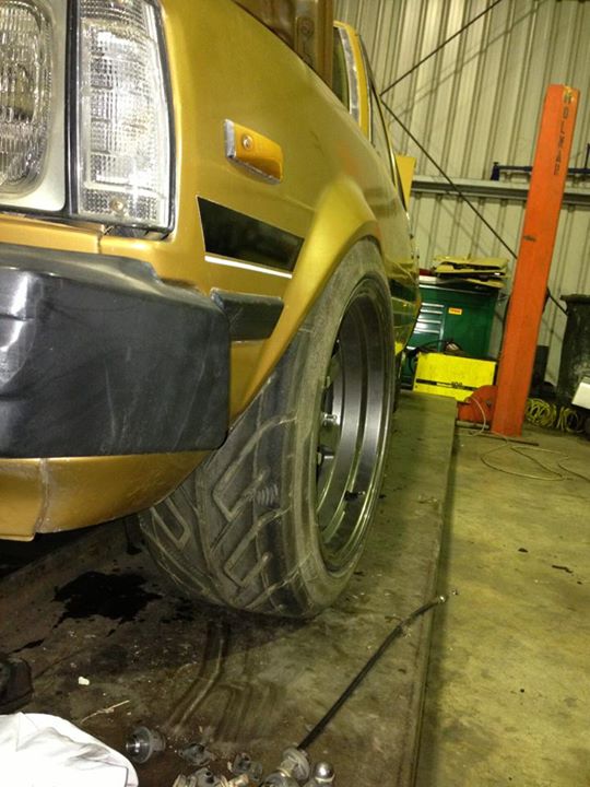

Ran out of guard clearance when I fitted my AJPS LCAs.

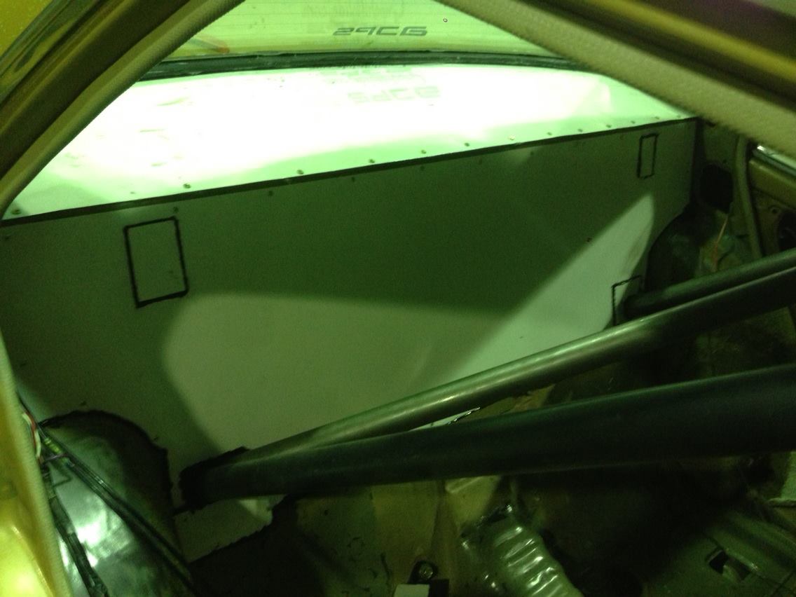

Got a full cage fitted (don't have a good photo of it) and patched up the rear firewall/parcel shelf to pass scruit at Winton.

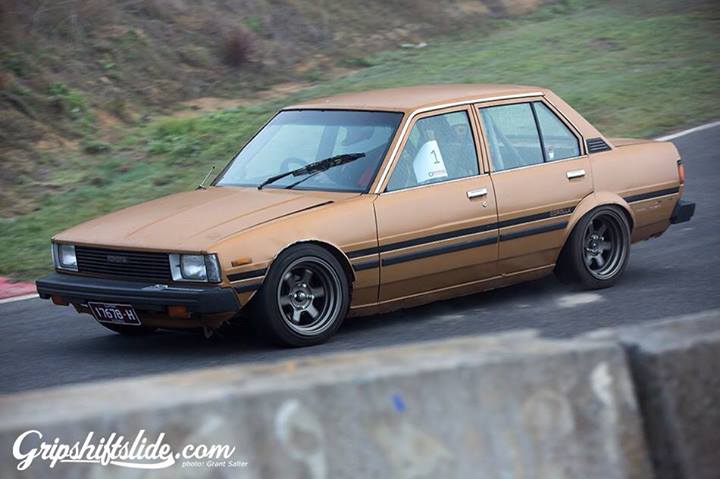

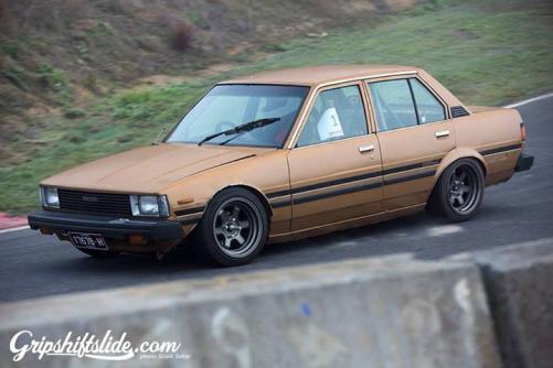

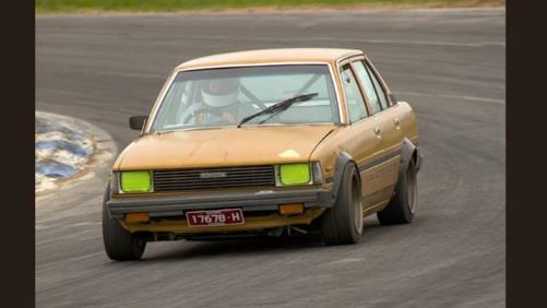

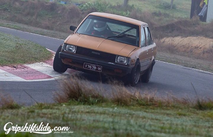

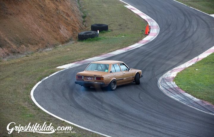

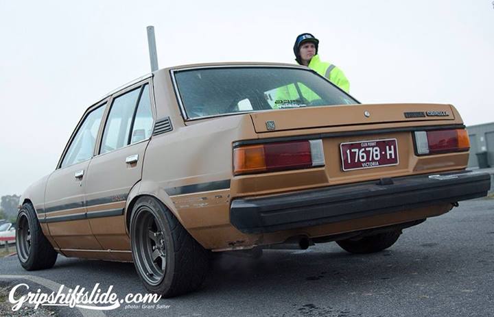

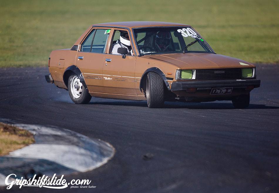

Ran the new car at Haunted hills again, didnt put it into the wall this time! yeeeeeee. Done a 60.72 lap with a mega ʞ©$ɟed alignment, 20 degrees toe in & over 5 degrees neg camber.
BIG thanks to Grant @ Gripshiftslide.com for the awesome photos.

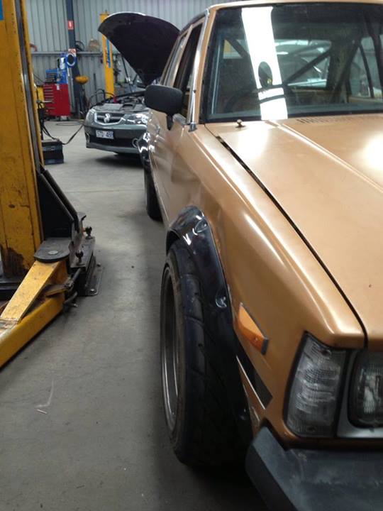

Sorted out the mangled guards just in time for my last outing at winton.

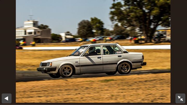

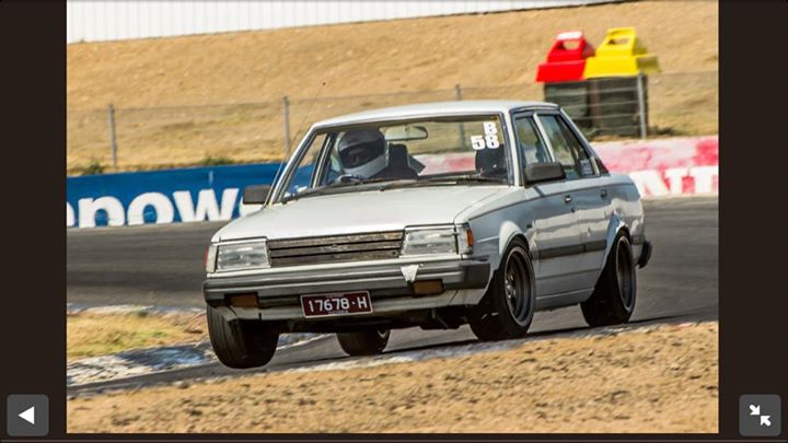

Went out on sunday to winton and run a PB with the new setup (LCA's and front swaybar + alignment) 1:44.2. I'll put up some more pics once I get them.

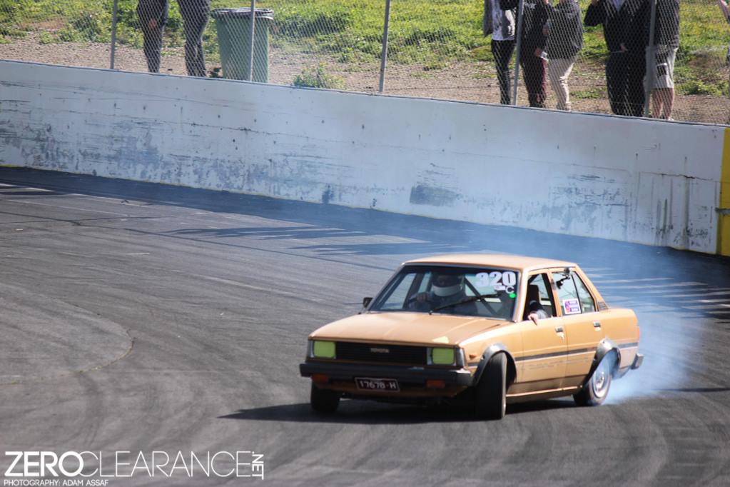

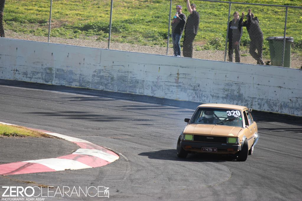

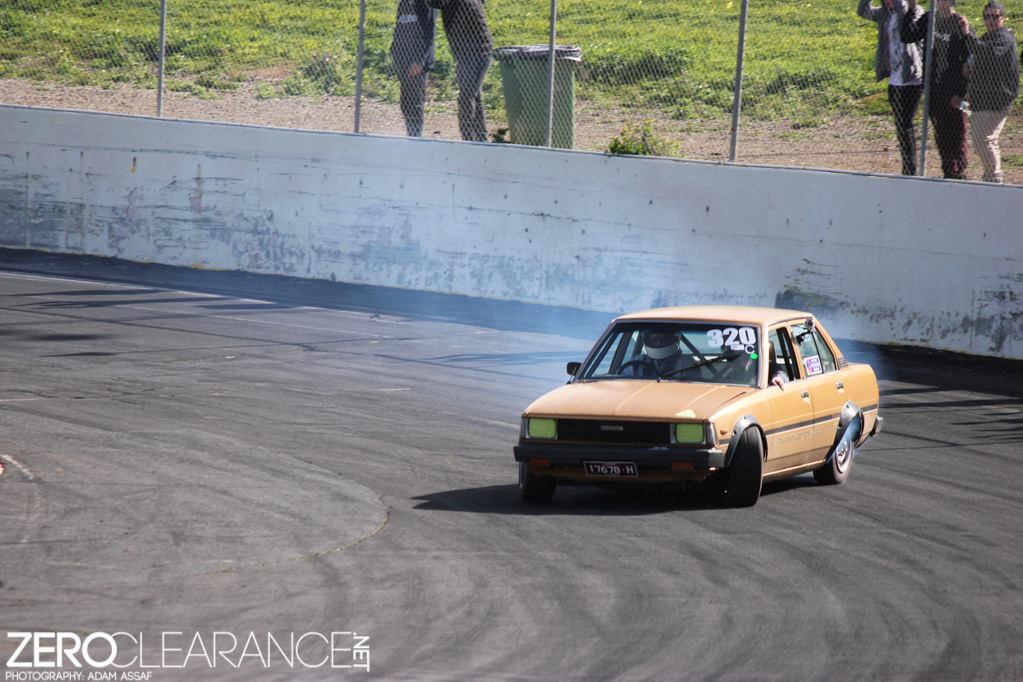

Update: Went drifting 10/08/13
Done fairly well, everyone loved the car.
