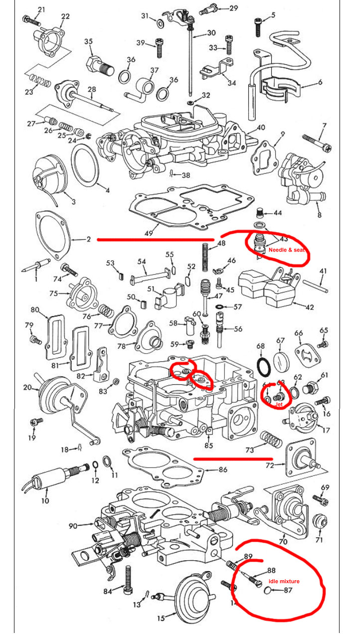

luk3333 Posted July 2, 2013 Author Report Posted July 2, 2013 Yeah, its drivable, I just prefer to know it's working right. I pulled the jets out to blow them out, and basically just had a look at all the parts and tried to get some idea of it worked. I'm not sure exactly which is the idle jet still. A video I watched referred to a long thin one next to the accelerator pump as a "slow jet", is that it? Quote
altezzaclub Posted July 2, 2013 Report Posted July 2, 2013 Here- Drawn on for another thread, but those are the jets. Quote
