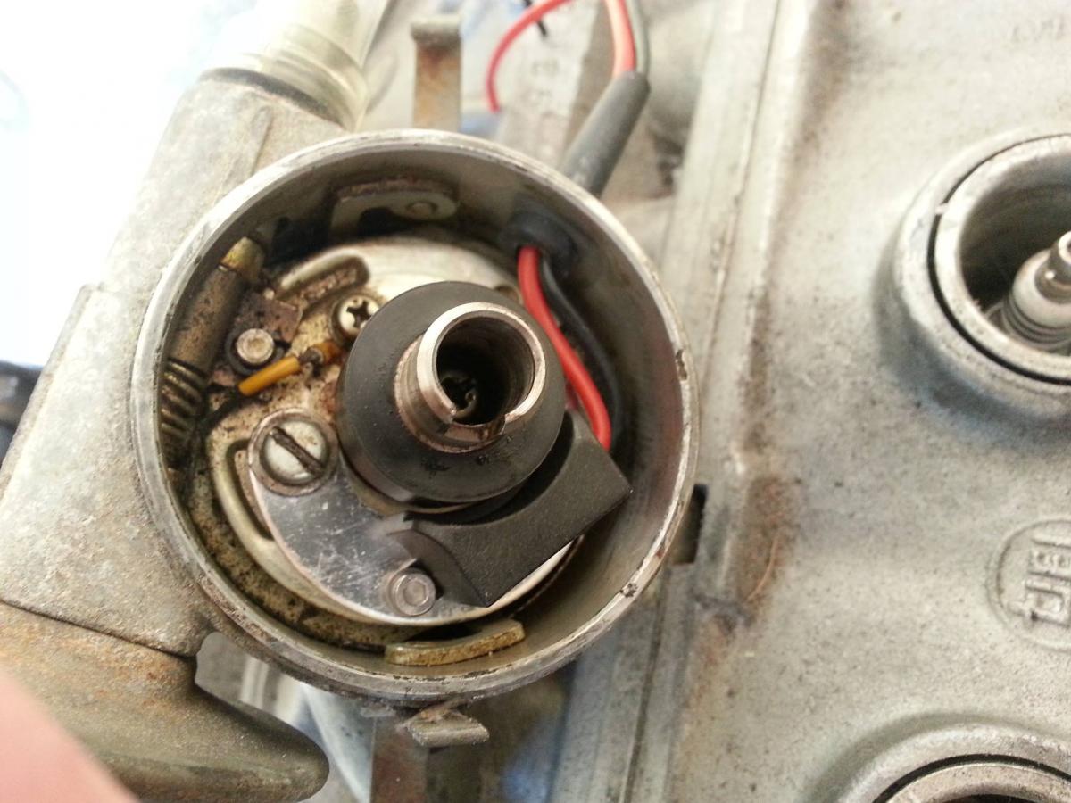

jay_howie Posted July 22, 2013 Author Report Posted July 22, 2013 (edited) I went with the accu version. And from what I can tell is uses a magnet to deliver the pulse, much like a hall effect sensor. My only issue is that the rotor no longer fits on over this sensor, may have to chop the bottom off it Edit: Its probably easier to describe with a photo! Edited July 23, 2013 by jay_howie Quote
jay_howie Posted July 23, 2013 Author Report Posted July 23, 2013 Except the locating dowel doesnt reach! So it just spins and now the cap doesnt go on! Quote
