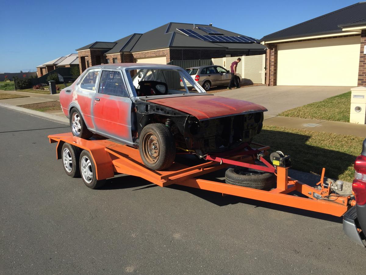

Tough_little_ke20 Posted June 26, 2016 Author Report Posted June 26, 2016 Alrighty. My appologies for dropping off for so long. Yesterday she came back home and today my brothers car went back to his place until spring when we get some nicer painting weather. So now I'm ready to get back into it 1 Quote

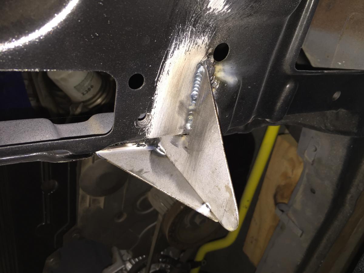

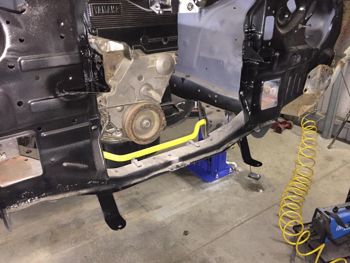

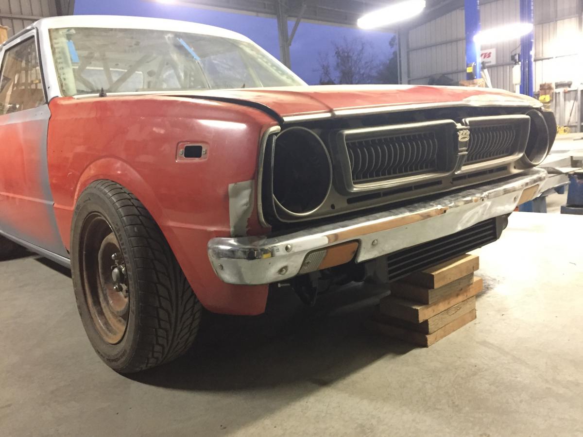

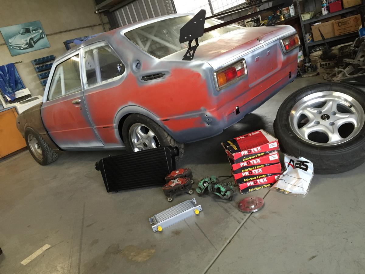

Tough_little_ke20 Posted June 27, 2016 Author Report Posted June 27, 2016 (edited) So straight into the car getting the cooler mounted and I run out of argon, great. Got a start though. Got carried away and started playing with the spliter design too Edited June 28, 2016 by Tough_little_ke20 Quote
Tough_little_ke20 Posted June 28, 2016 Author Report Posted June 28, 2016 Are you as excited as me haha. Got some gas. I'll do the bottom mounts tomorrow Quote

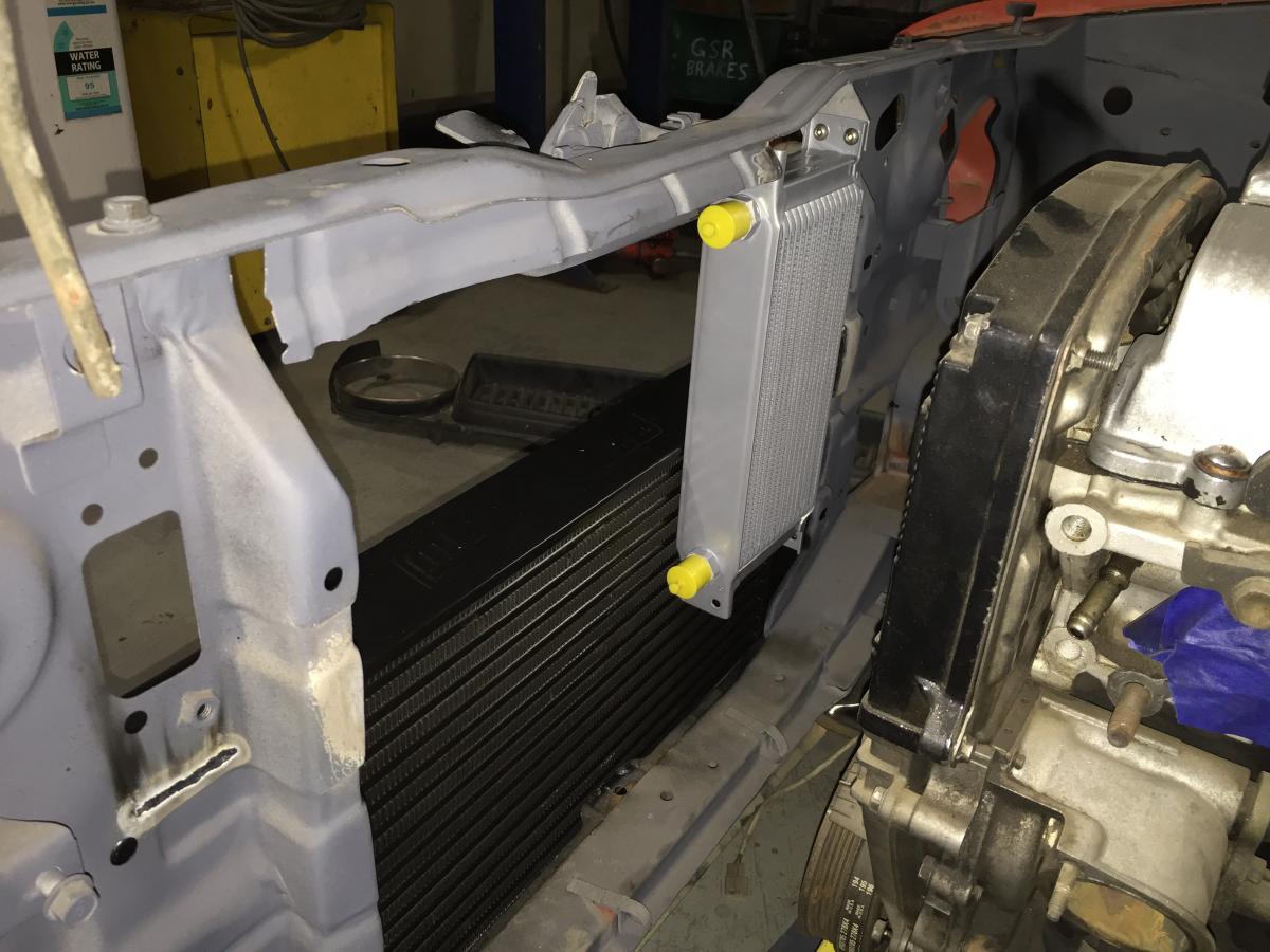

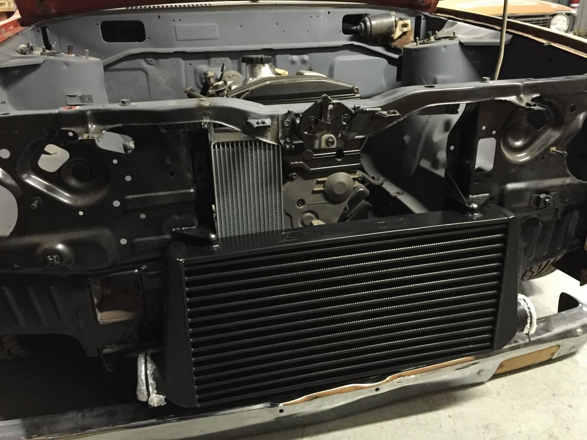

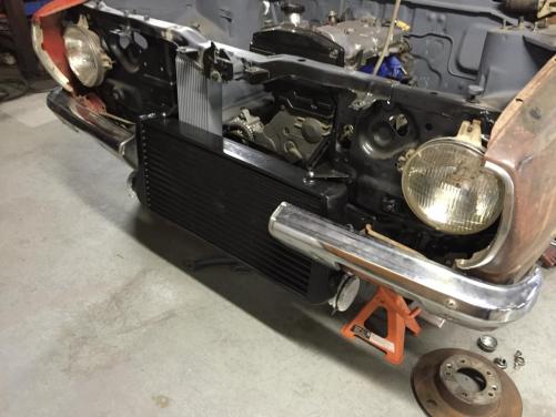

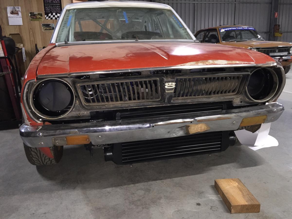

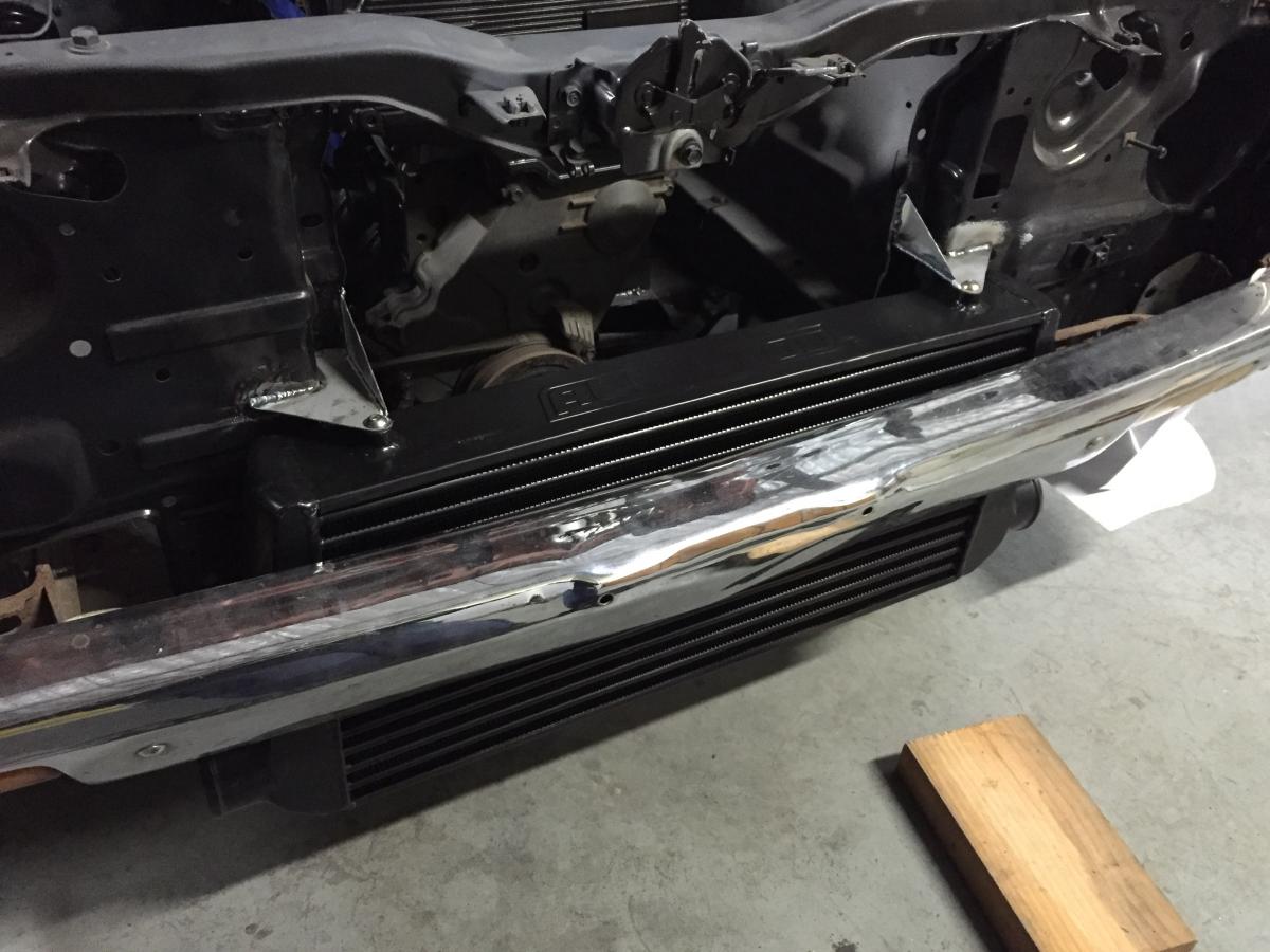

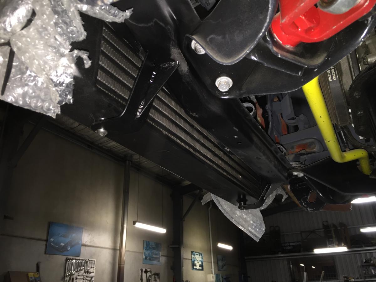

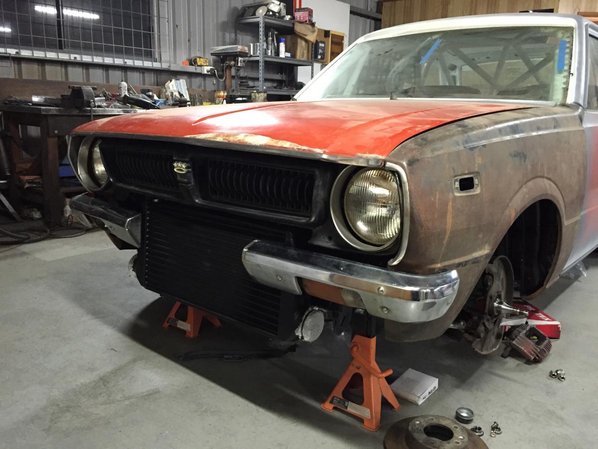

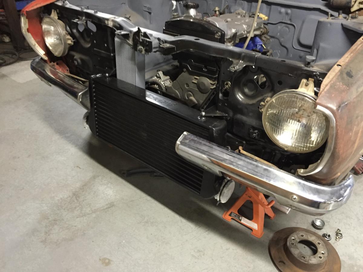

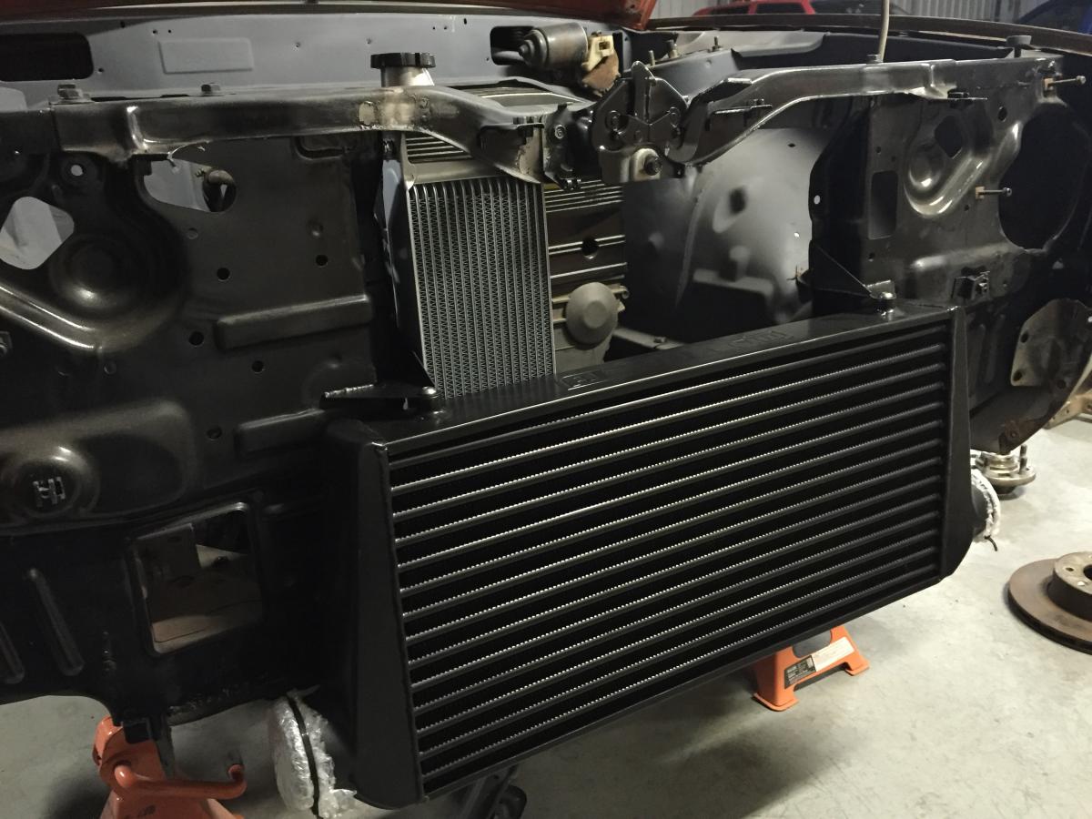

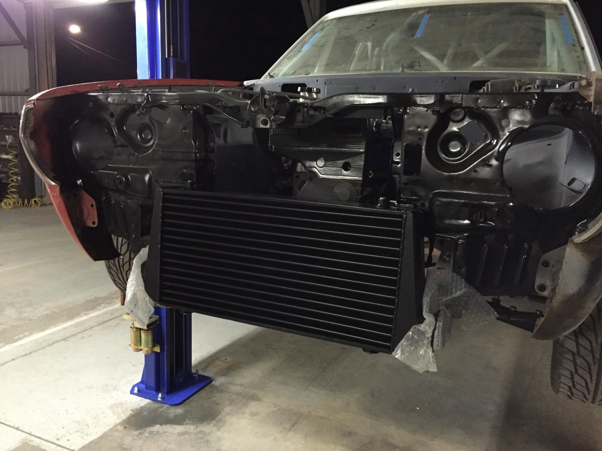

Tough_little_ke20 Posted June 29, 2016 Author Report Posted June 29, 2016 Do it  Intercooler is mounted, oil cooler next Quote
greenmac80 Posted June 29, 2016 Report Posted June 29, 2016 yeah right lol. my crowns are plenty enough for the moment. maybe in another 4 yrs or so i might look at another ke  cooler mounts look good. Quote

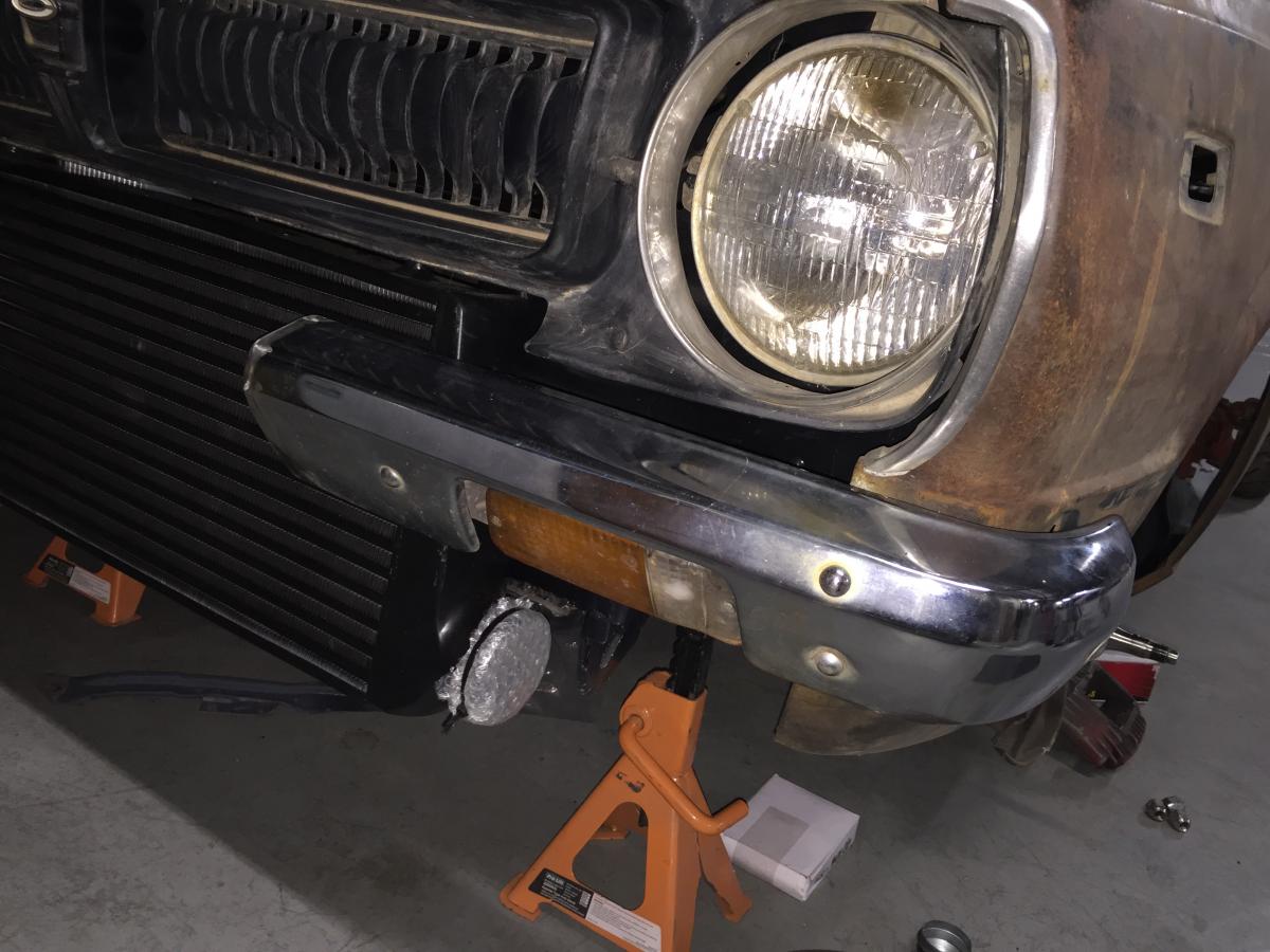

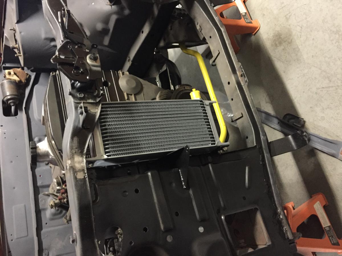

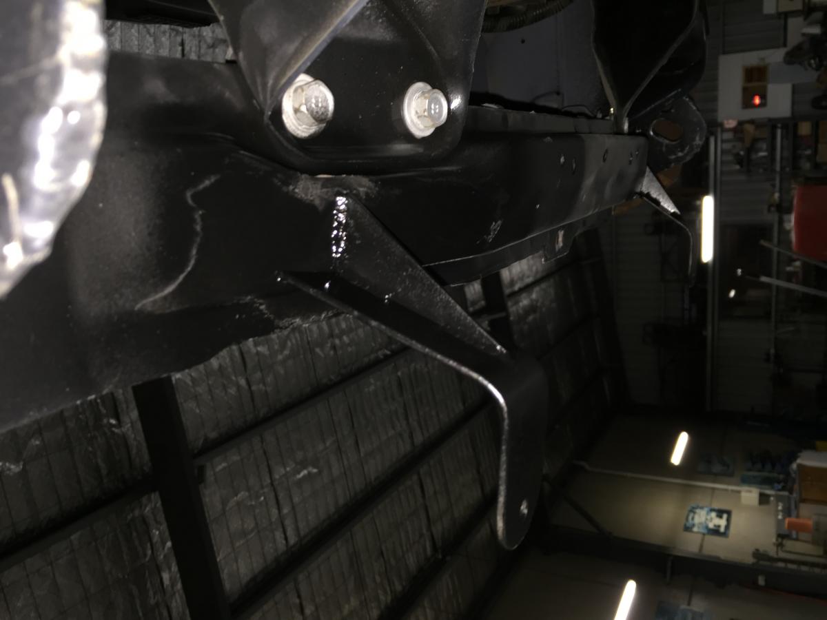

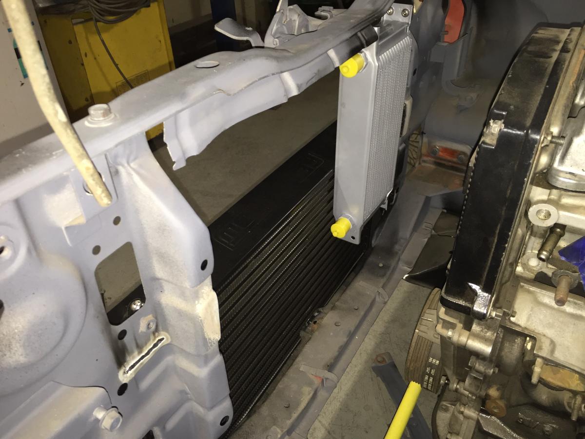

Tough_little_ke20 Posted June 30, 2016 Author Report Posted June 30, 2016 Sounds good  Oil cooler half mounted Quote

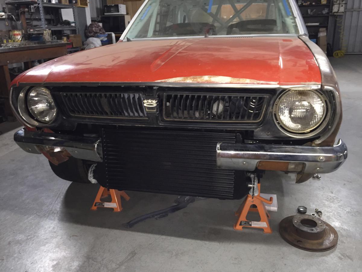

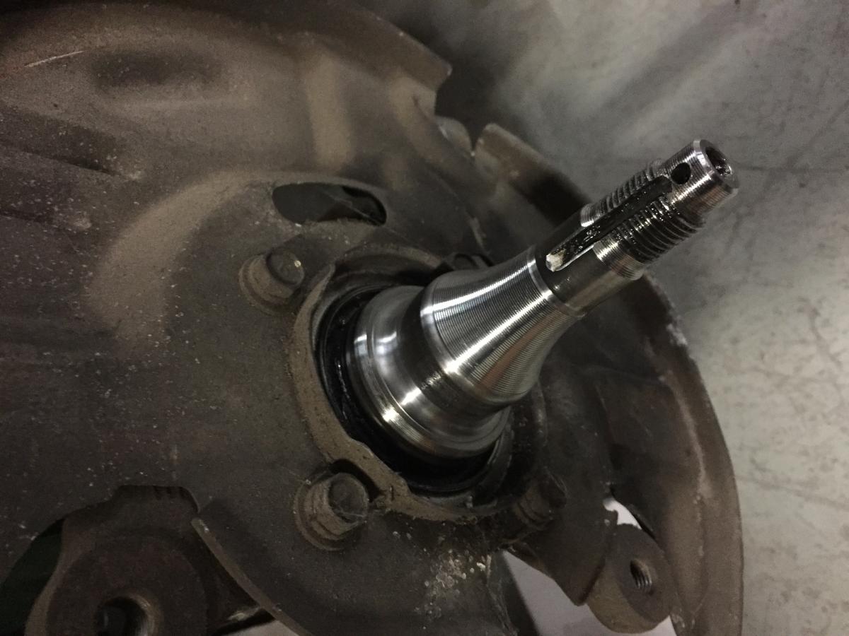

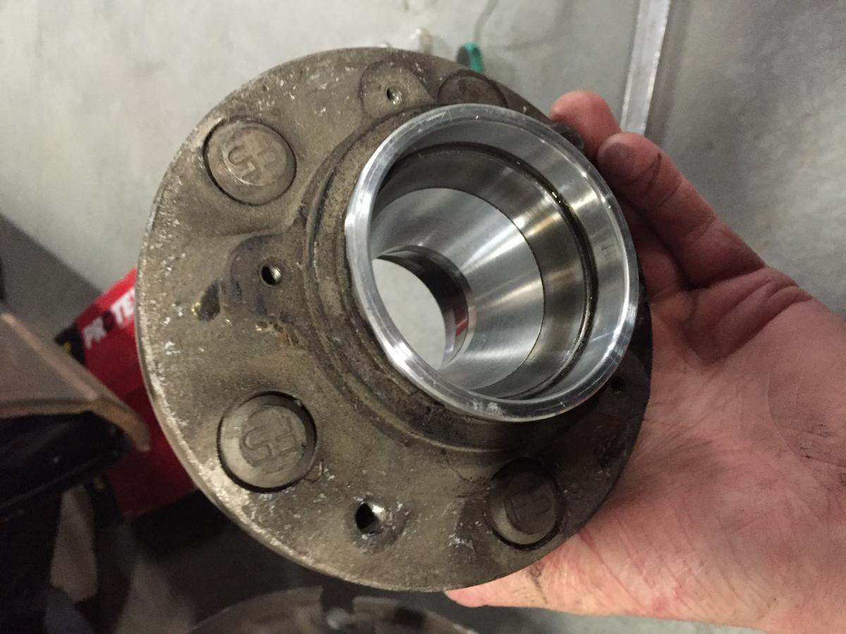

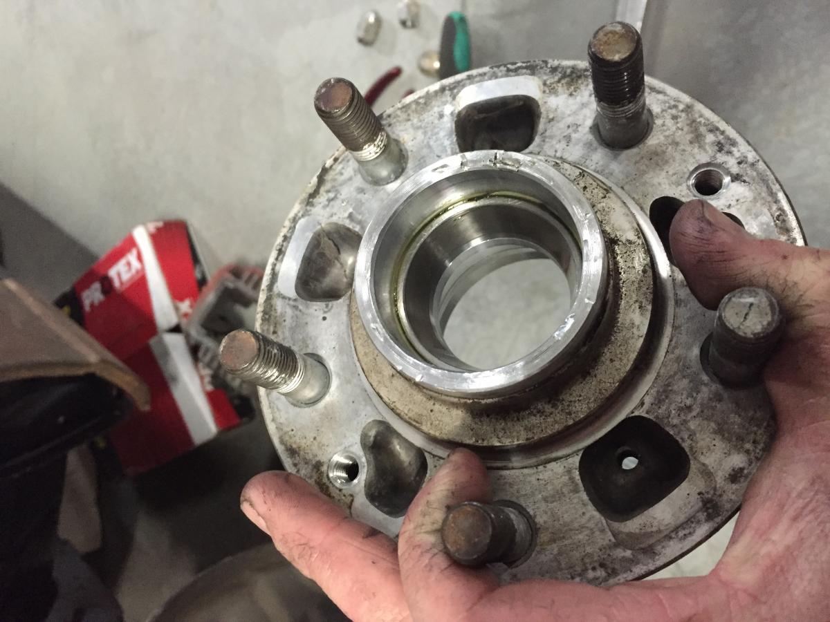

Tough_little_ke20 Posted July 6, 2016 Author Report Posted July 6, 2016 Oil cooler mounted, onto the front hubs, I can't redrill them to a 4 stud as you can see from the photos so I have to make new ones Quote

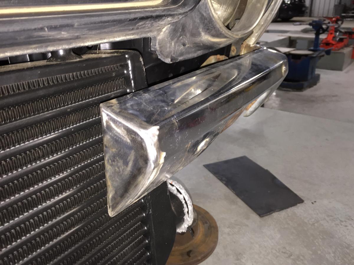

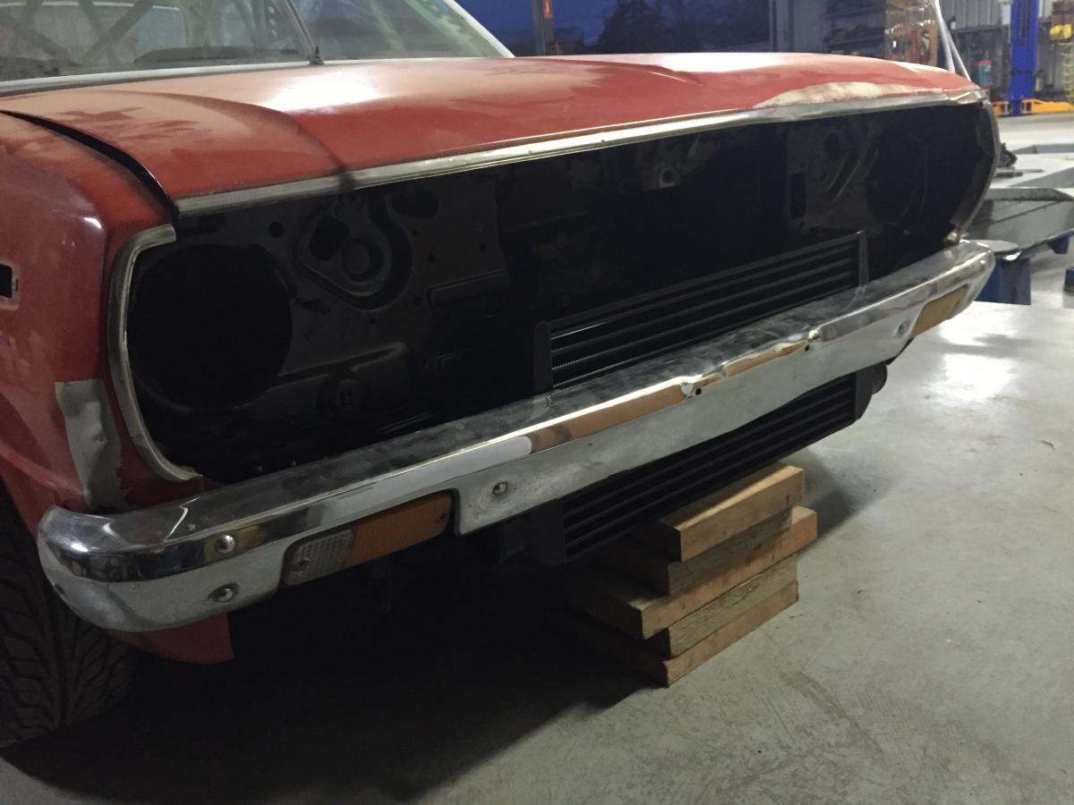

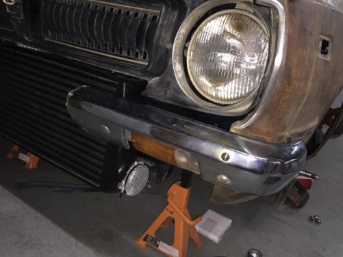

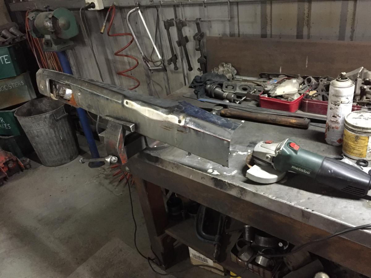

Tough_little_ke20 Posted July 7, 2016 Author Report Posted July 7, 2016 Made my bumperets tonight, came up pretty good Quote
greenmac80 Posted July 7, 2016 Report Posted July 7, 2016 bumperettes are pretty cool. gonna get em filed and re chromed? Quote
LittleRedSpirit Posted July 8, 2016 Report Posted July 8, 2016 Thats a creative take on it, cool. Quote
ke70dave Posted July 8, 2016 Report Posted July 8, 2016 Those bumper things look super cool. Nice one. Quote

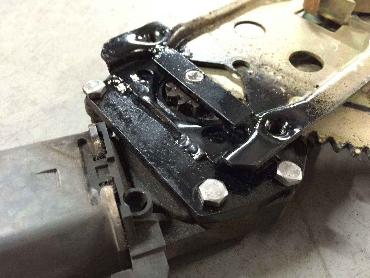

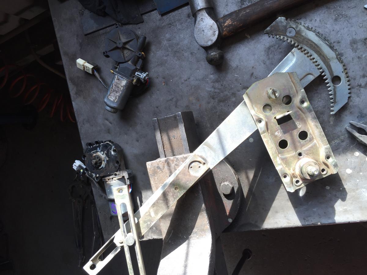

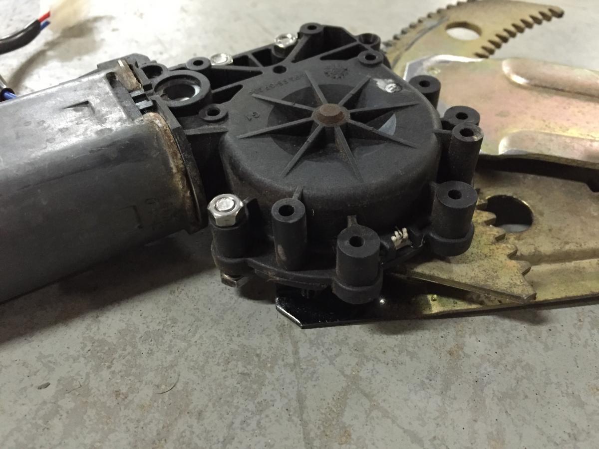

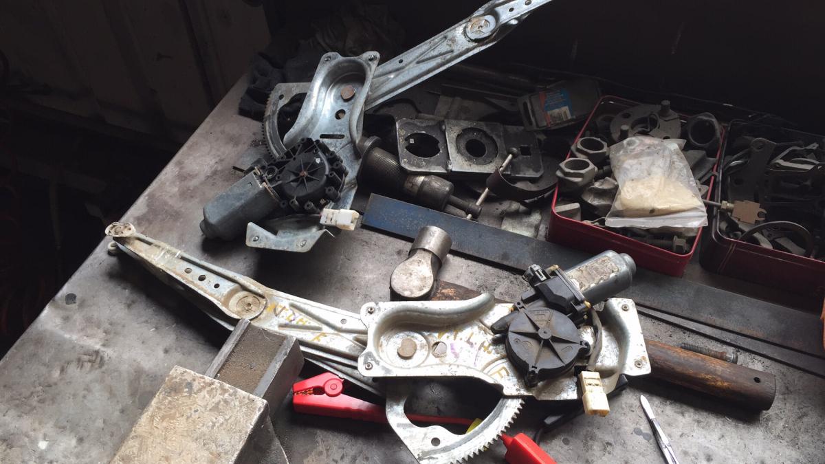

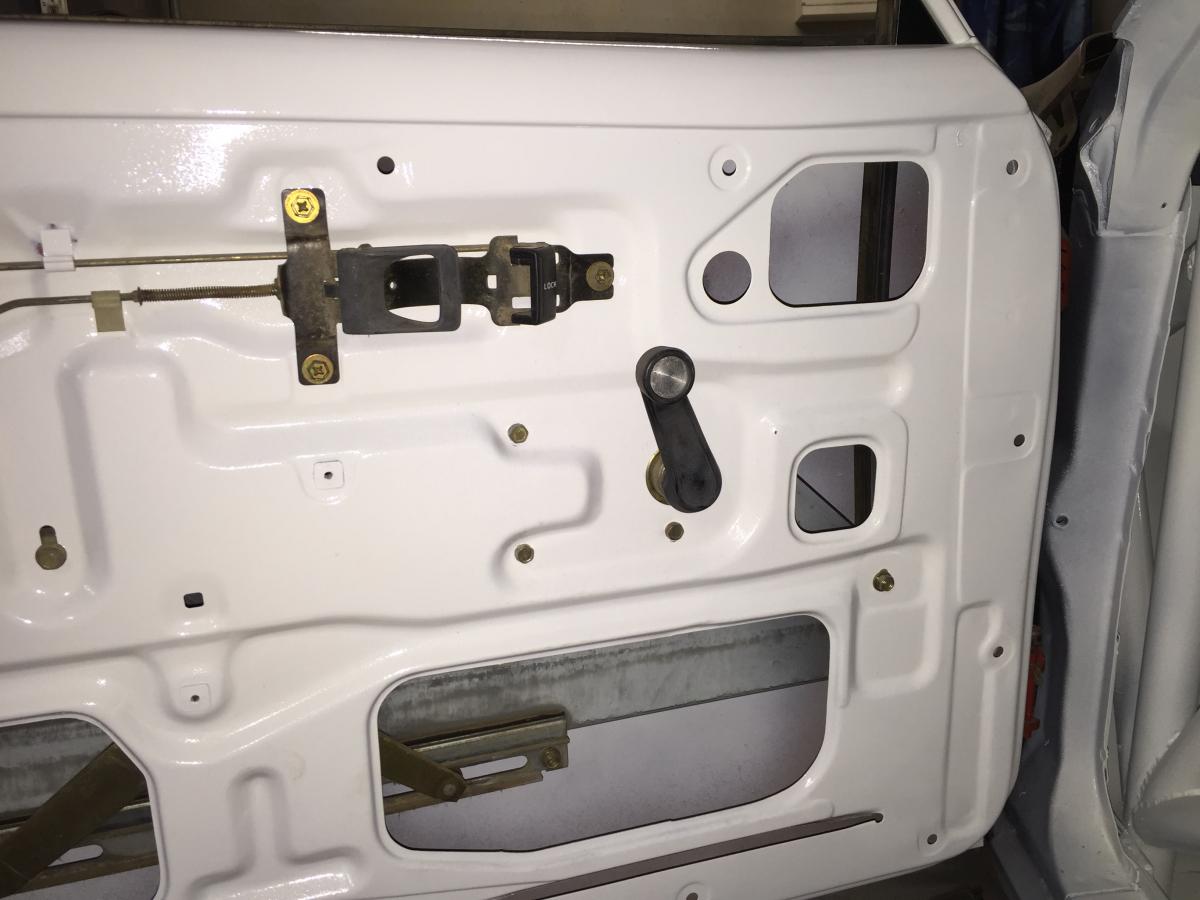

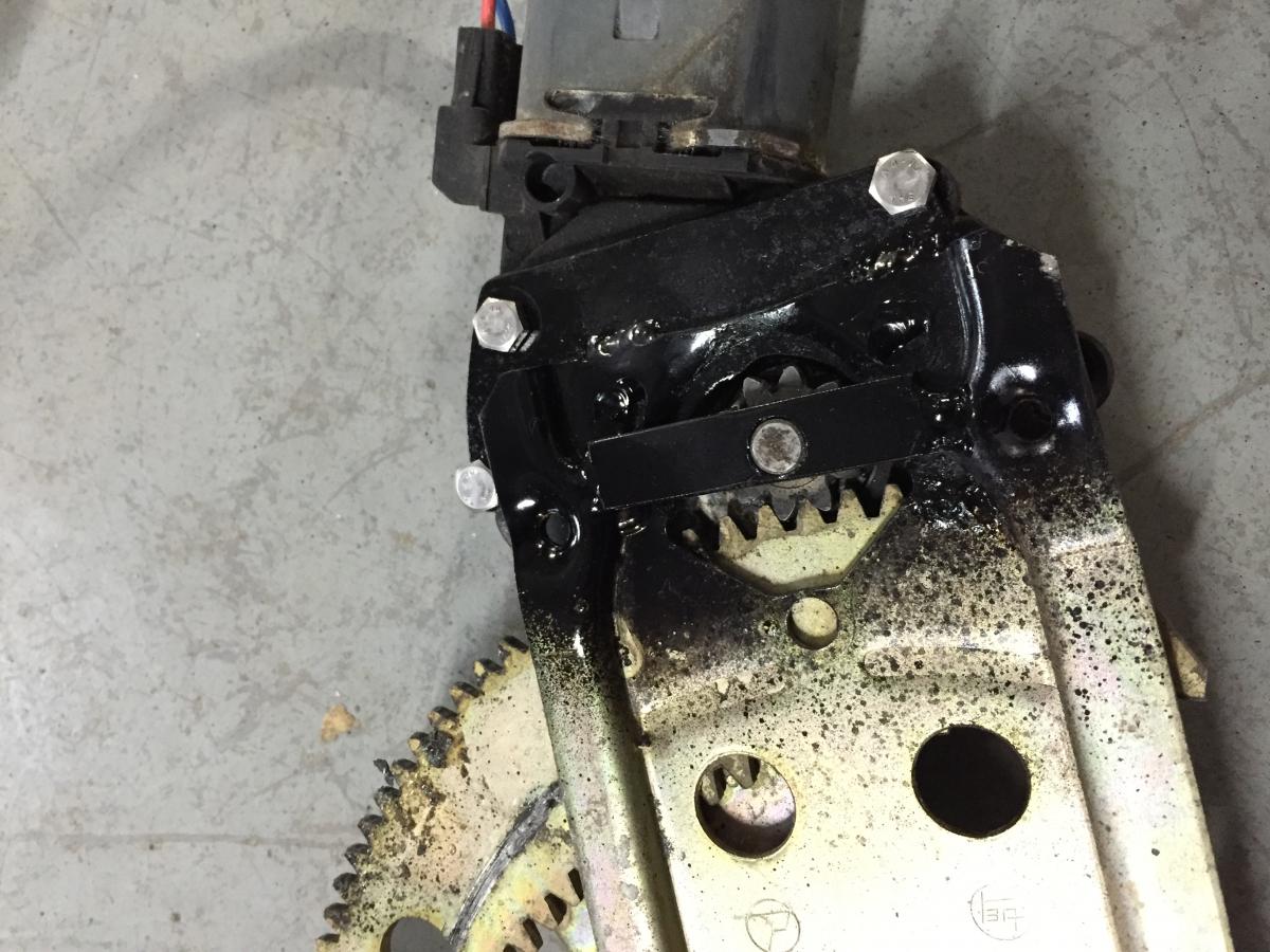

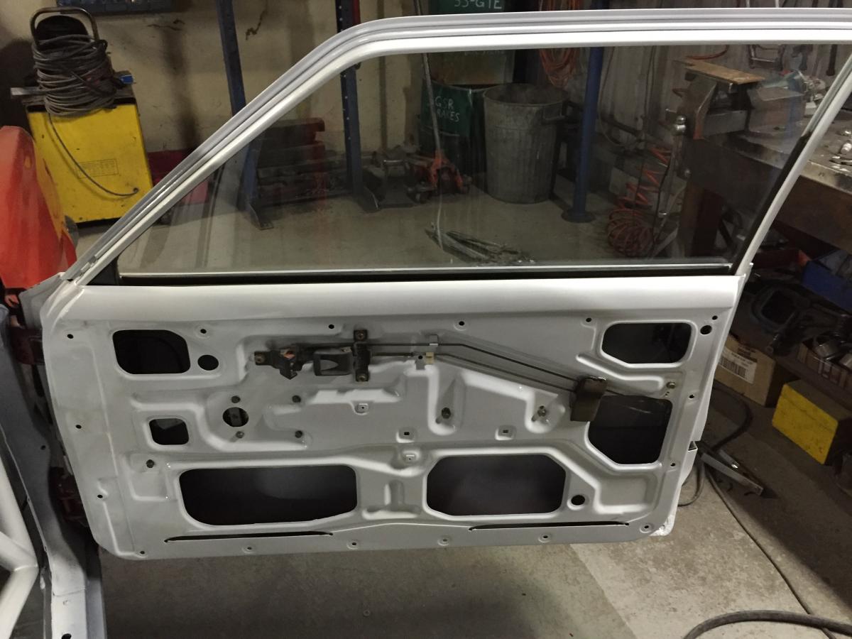

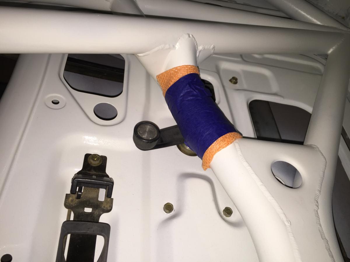

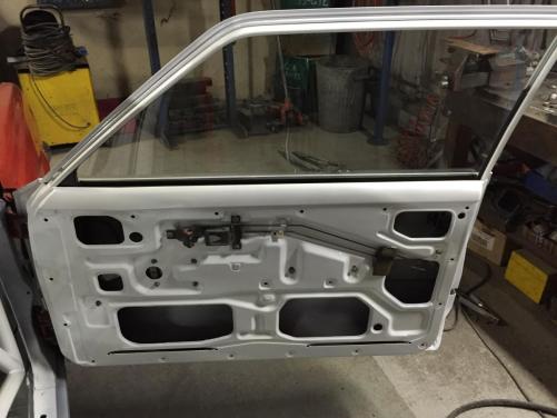

Tough_little_ke20 Posted July 9, 2016 Author Report Posted July 9, 2016 (edited) Thanks guys, yep I'll smooth up a few little gouges in them and when the cars closer to finished I'll get them and the rear bumper rechromed. Got some vt window winders today and created electric windows, driver side is done, I got it from Ke78rolla's post http://www.rollaclub.com/board/topic/59933-making-a-power-window-ke30/ I tweaked it a little, but a brace over the top with a hole to brace the center pin, also welded and bolted it rather than pop rivets. The reason I went electric on a racecar is simply no matter where I ran the. Intrusion bar it was going to clash with the winder so I just put it where I wanted it which worked out right on the shaft and ditch the winder by going electric. Plenty of people said go with Perspex riveted in or side sliding Perspex but I like glass even though it's a little heavier it's nicer. Also with the seat so far back it's a fair reach to the winder so with the harness done up unless your elasto man, your not winding the window. I have a video on my Instagram of the window working if anyone wants to see it my profile is ke_addict36 Edited July 9, 2016 by Tough_little_ke20 Quote

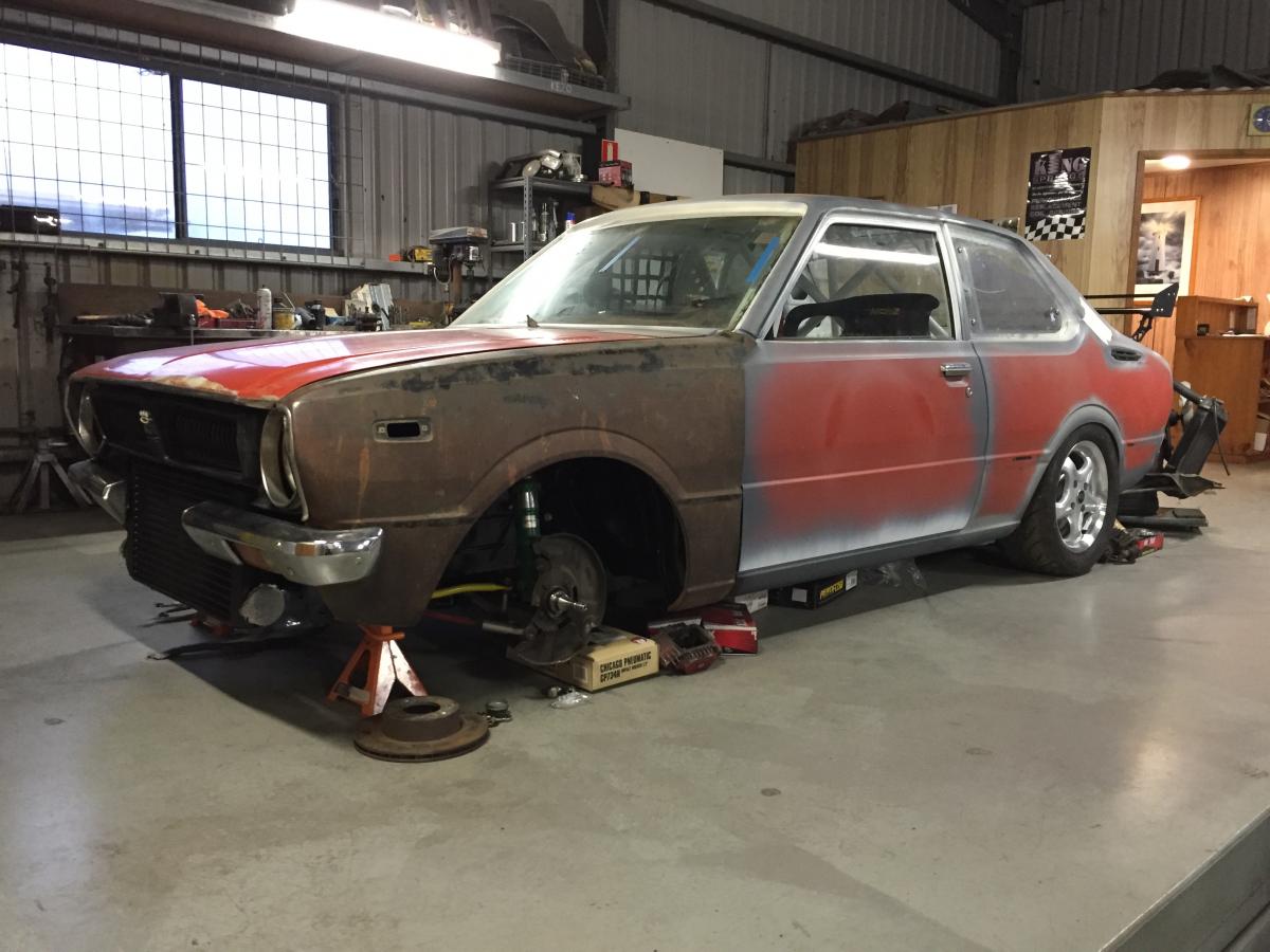

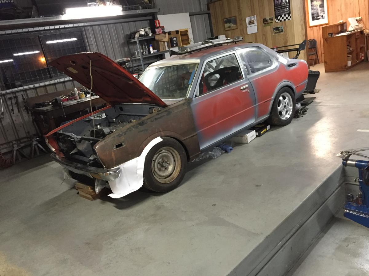

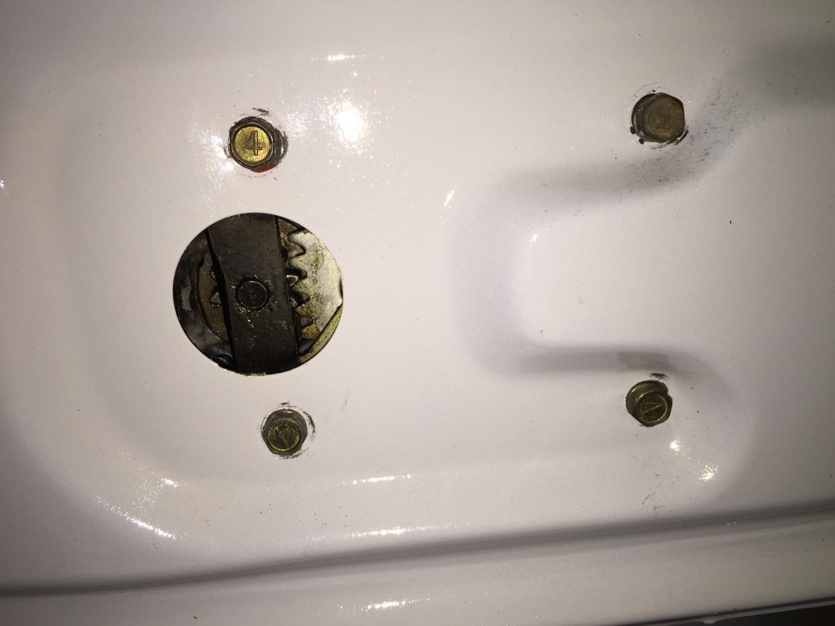

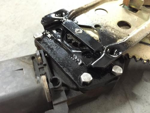

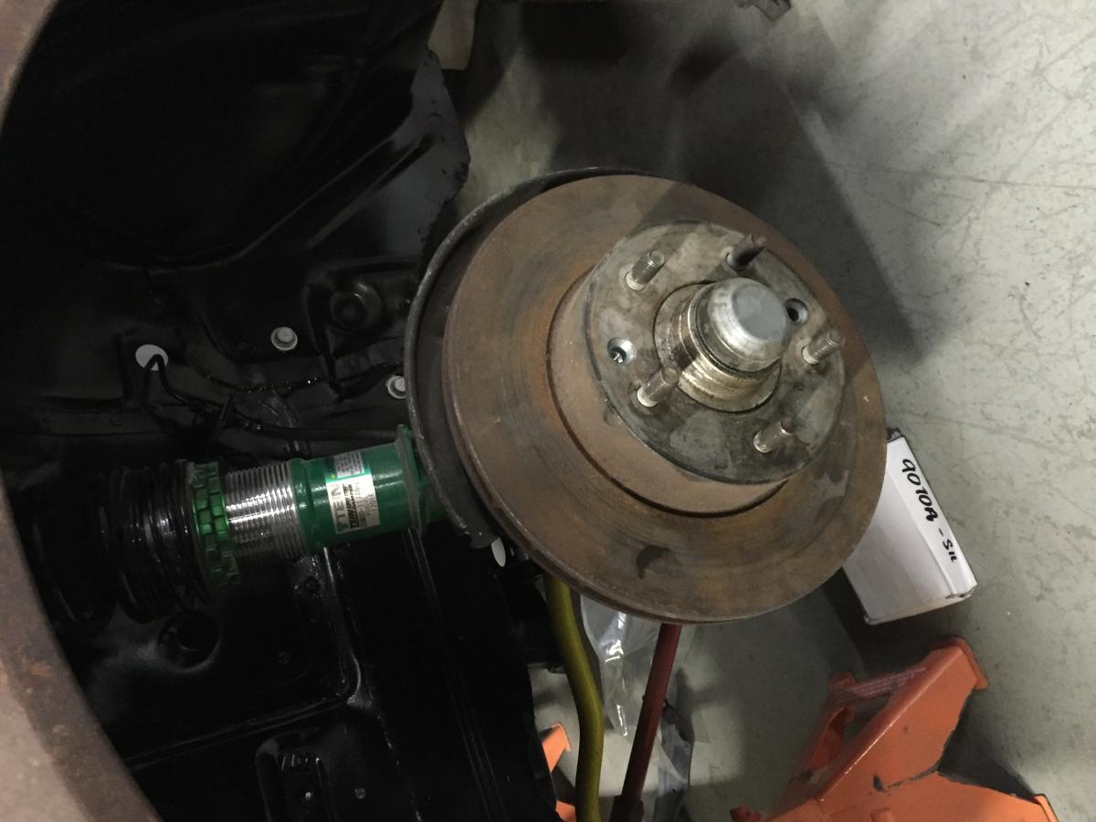

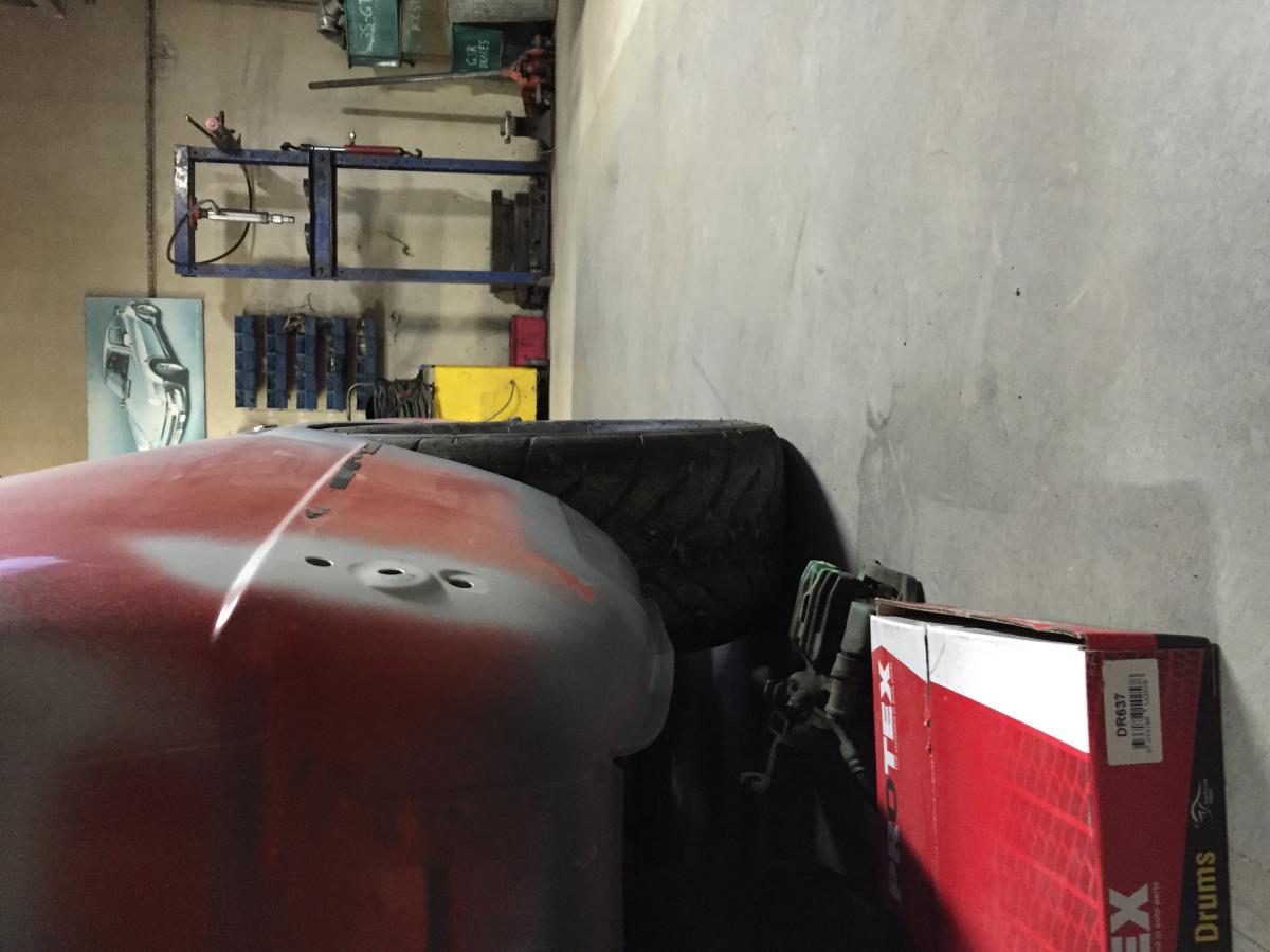

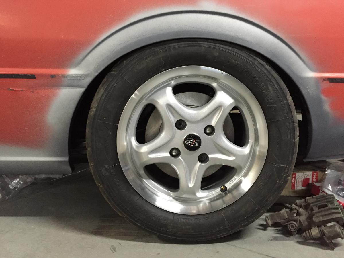

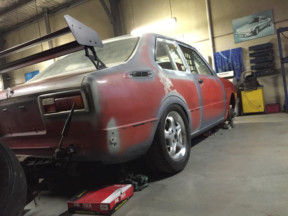

Tough_little_ke20 Posted July 10, 2016 Author Report Posted July 10, 2016 (edited) Went racing today, after 2.5 hours of traveling rain stopped play so I turned around and came home, so it wasn't planned but I got more done on the car. The other door now has electric windows, thought I'd take some photos of the bracket this time, also drilled the rear rotors and fitted them aswell as chopping the rock hard rear springs that wouldn't compress so I could get the car sitting at the right height, when the car is don't I'll get softer springs that will actually move Edited July 10, 2016 by Tough_little_ke20 Quote
