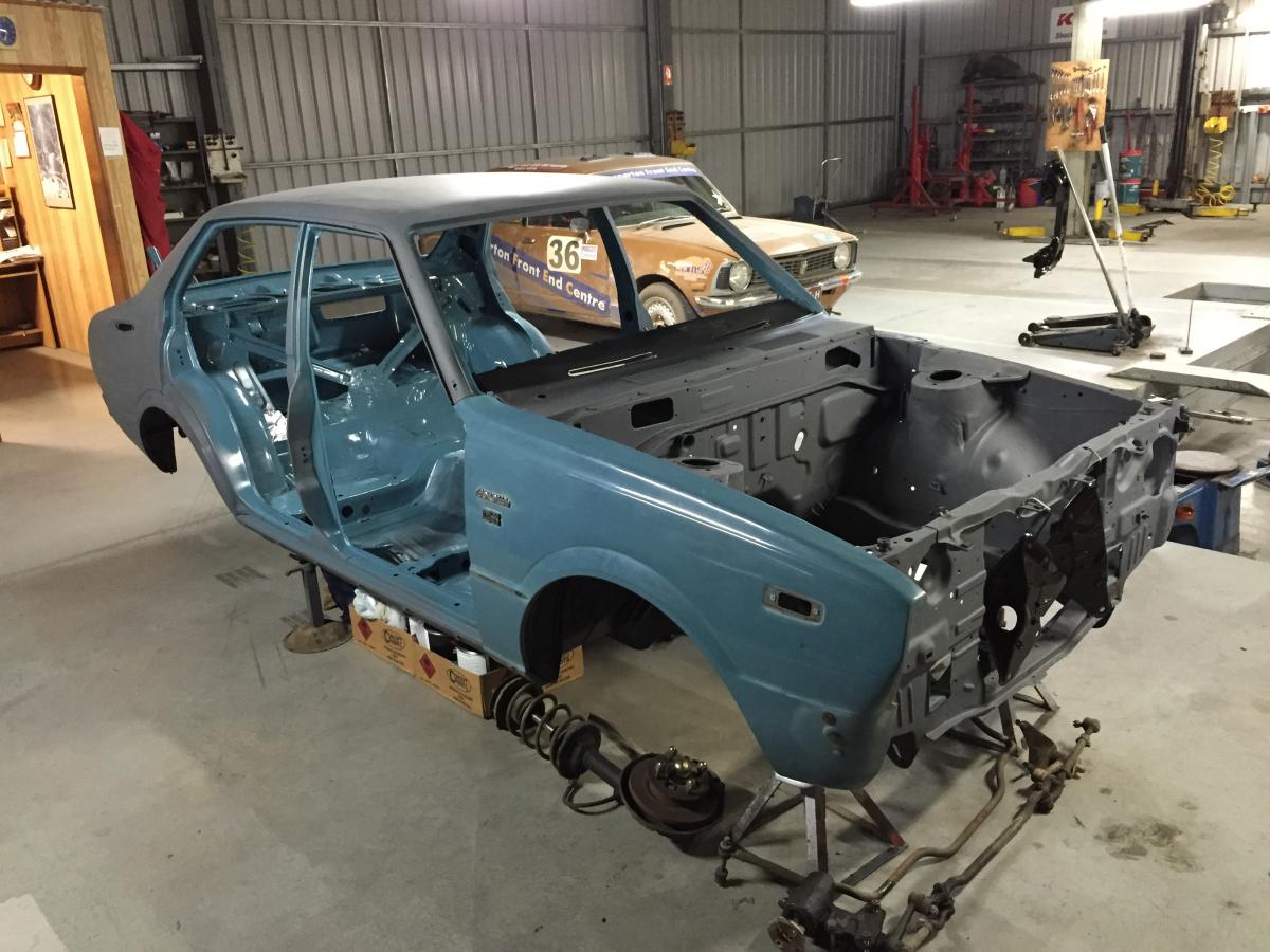

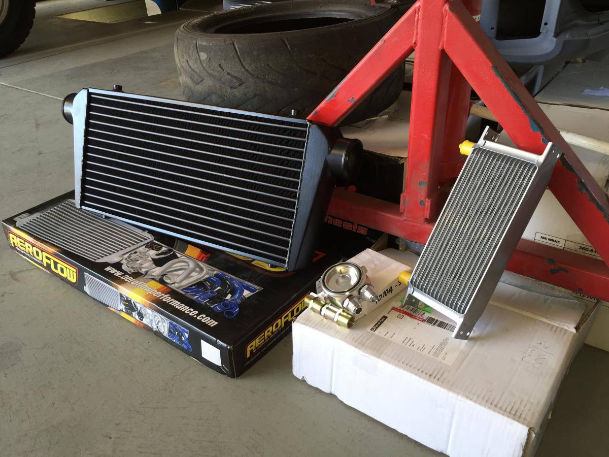

Tough_little_ke20 Posted February 22, 2016 Author Report Posted February 22, 2016 (edited) Wheels have turned up, waiting on material for my plenum and ordering intercooler, oil cooler, radiator and a rear wing, once the intercoolers in I can make my entire plenum, need the intercooler in so I know where to point the throttle body, then I can fit up some tires to the rims, make new alloy front hubs for the rx7 stubs but in a 4 stud and then with them and the cooler I'll be ready to start making up the plugs for my fibreglass moulds. But first I need to get my brothers car out of the shed, that means rust repairs, paint and reco the diff and front end then back to his place and I'll get my car back. Hopefully it won't be too long Edited February 23, 2016 by Tough_little_ke20 1 Quote

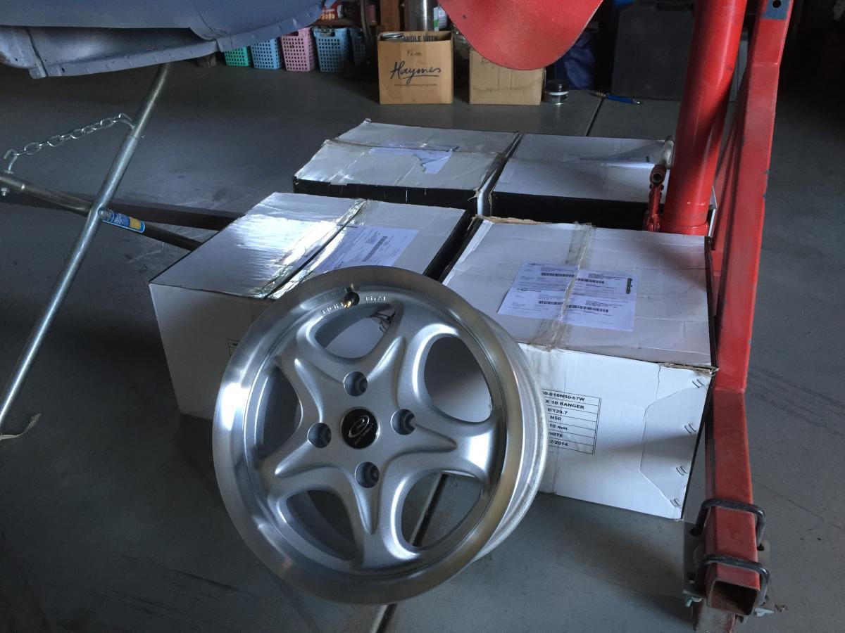

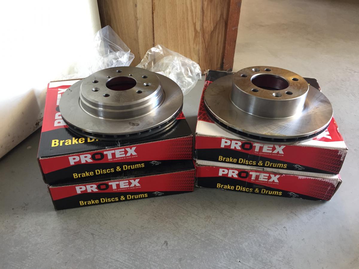

Tough_little_ke20 Posted March 1, 2016 Author Report Posted March 1, 2016 Presents turned up today, just like Christmas day Quote

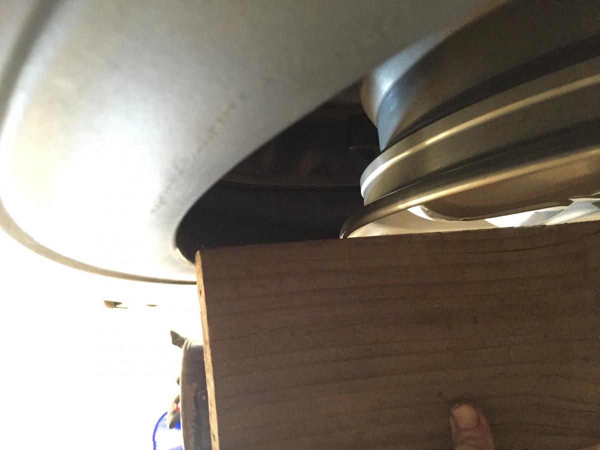

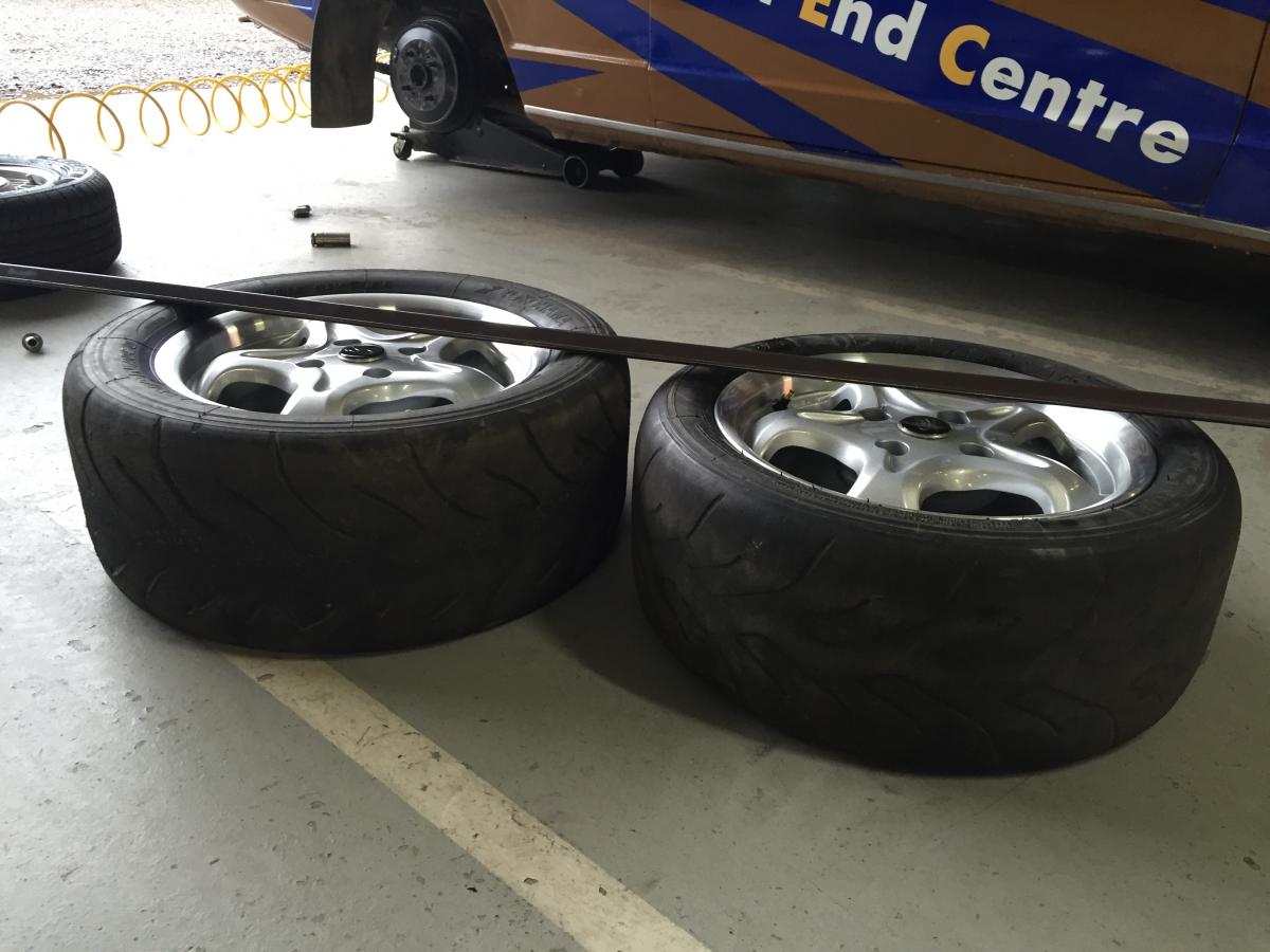

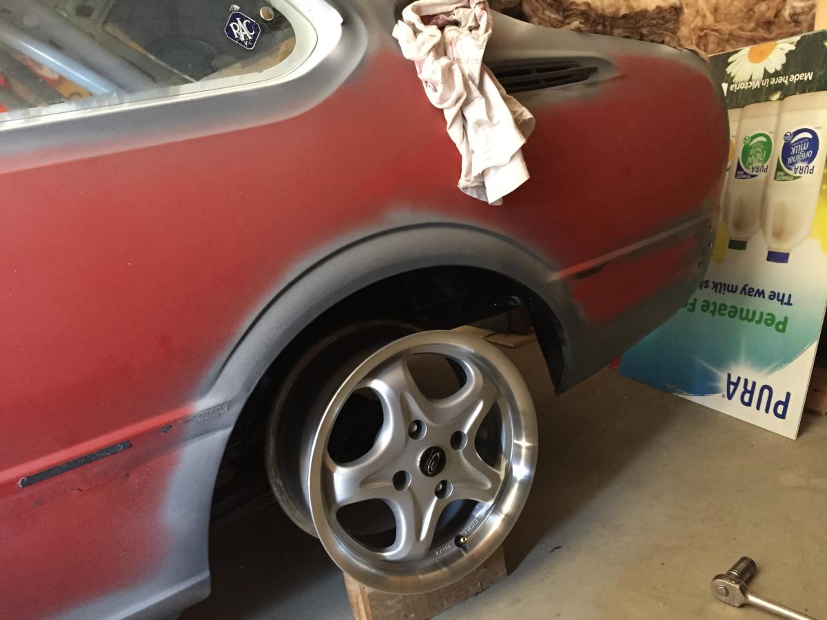

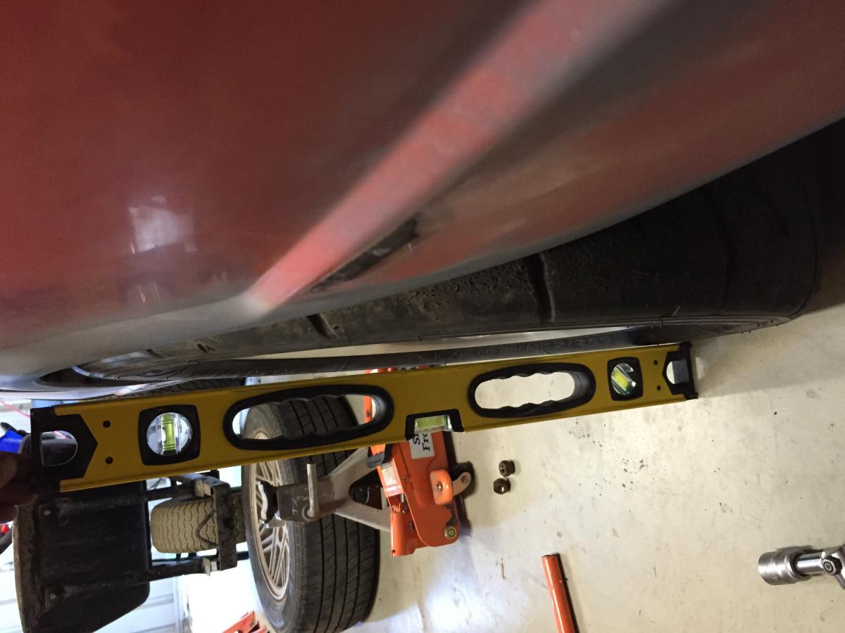

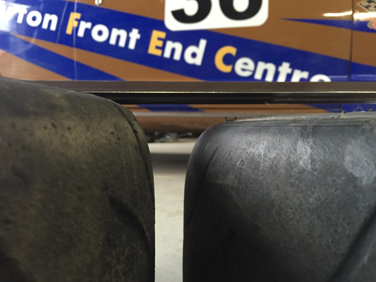

Tough_little_ke20 Posted March 9, 2016 Author Report Posted March 9, 2016 This shows just how critical my wheel size and offset is 1 Quote

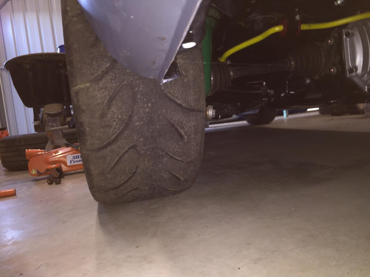

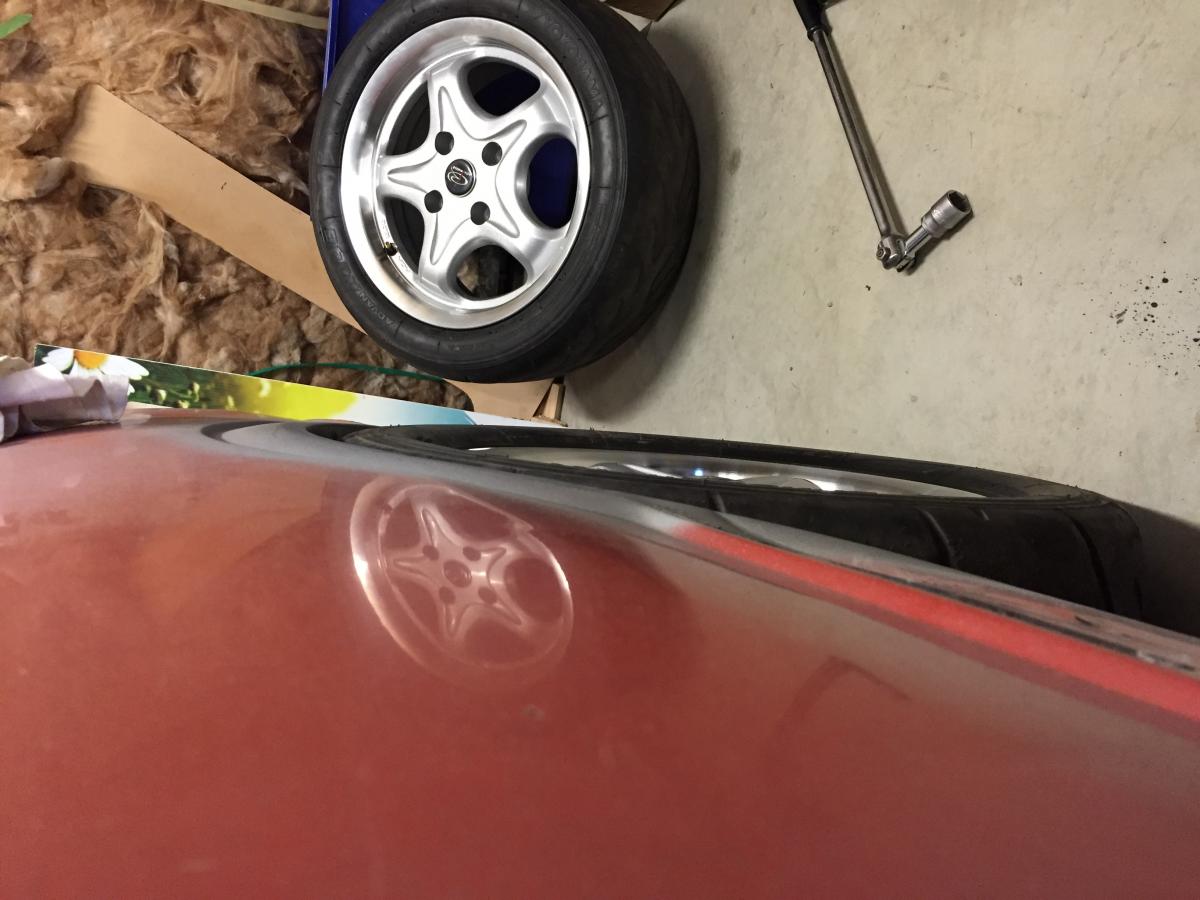

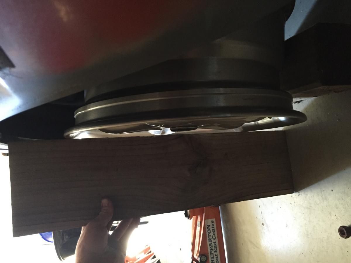

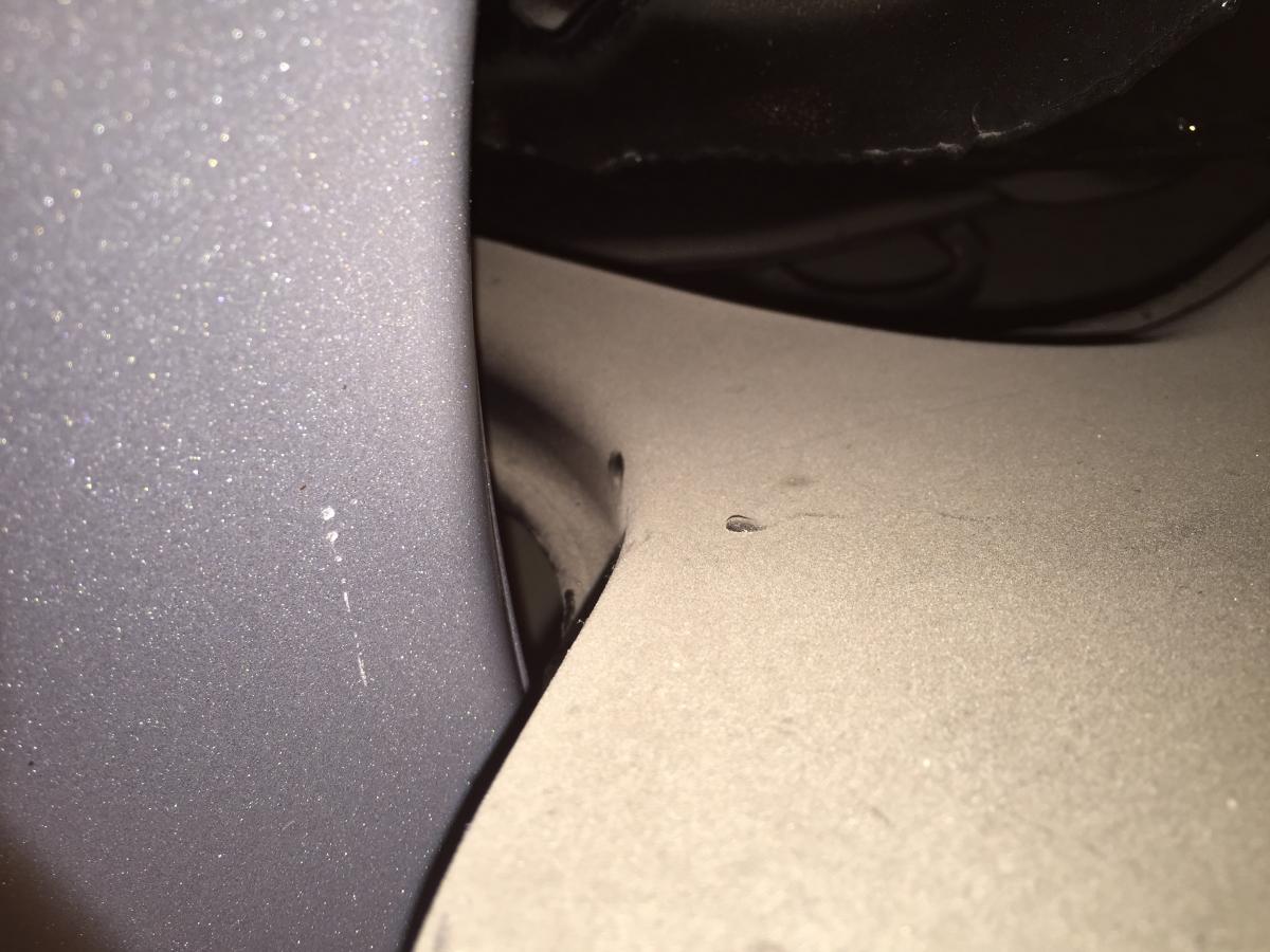

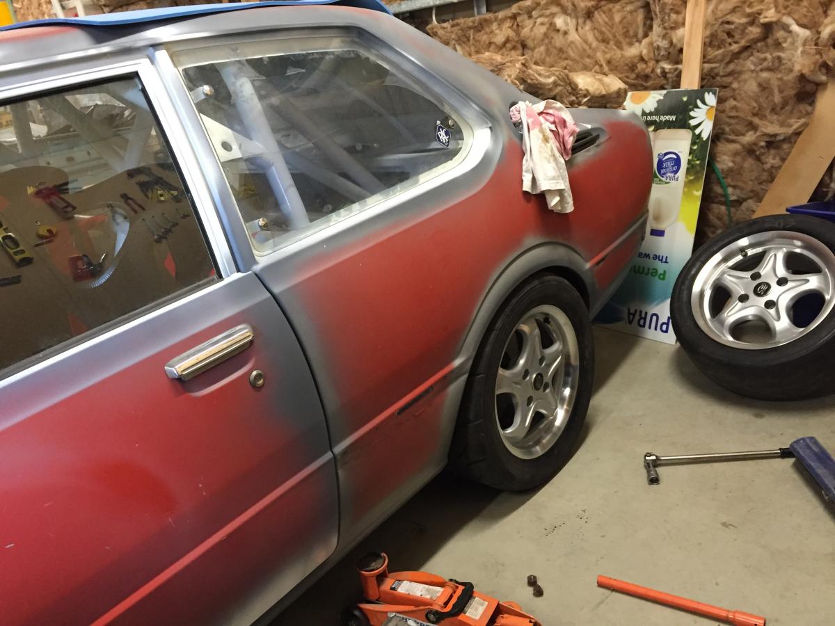

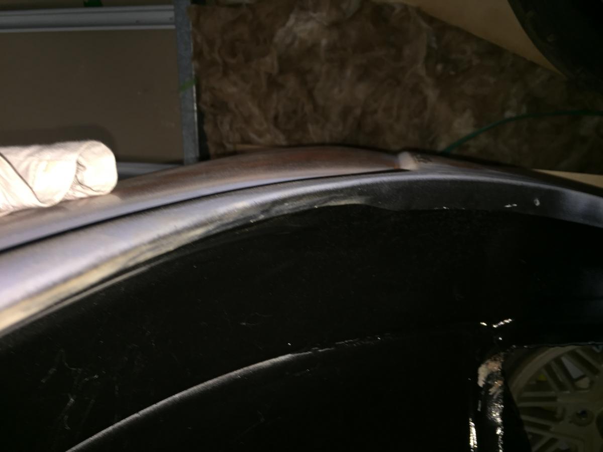

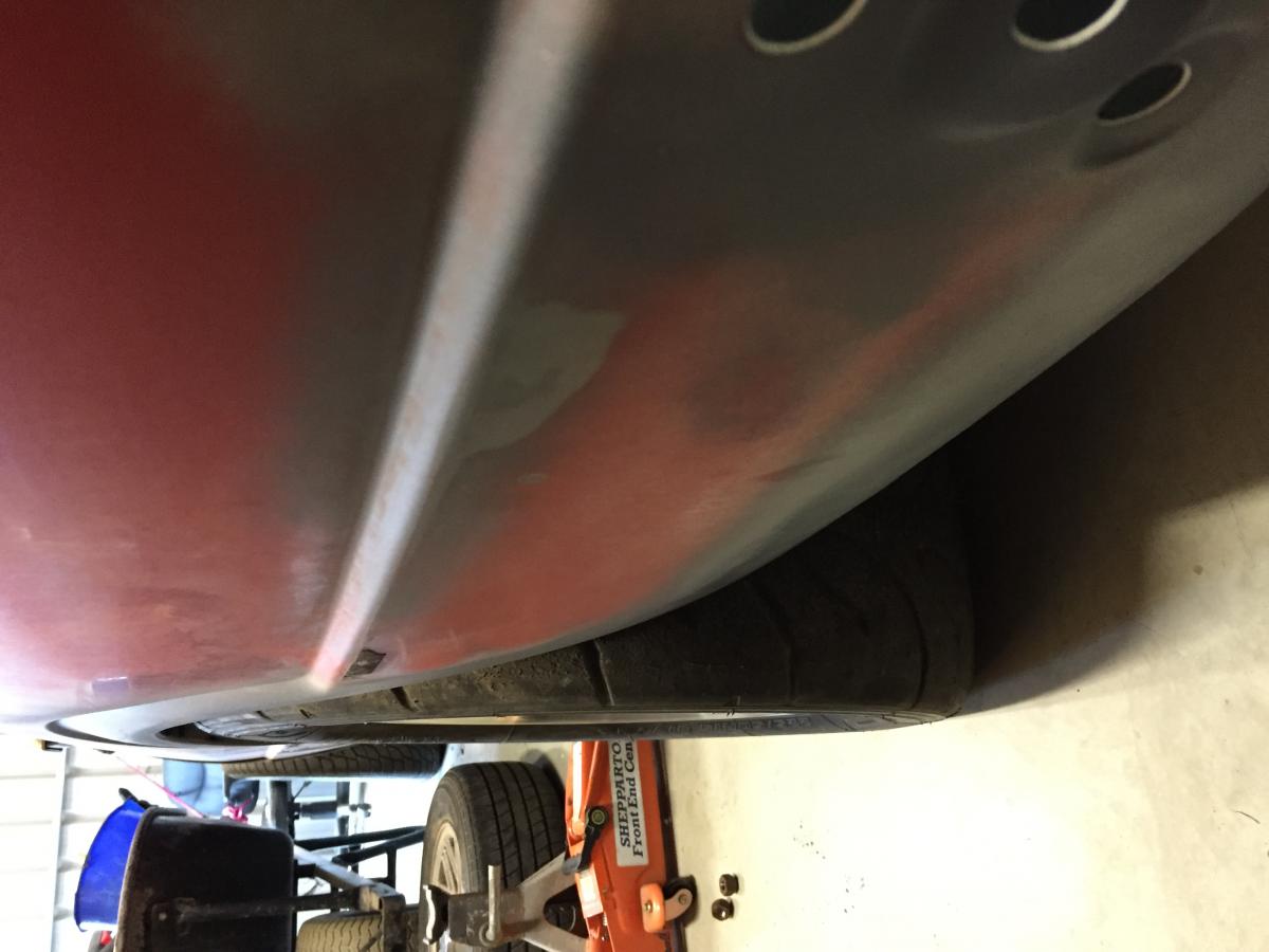

Tough_little_ke20 Posted March 11, 2016 Author Report Posted March 11, 2016 So I got a 205/50/15 fitted aswell as a 225/50/15, 205 is a perfect fit on the wheel but even the 225 still fits nice,I knew the 205 would fit the car, 215 would be close and throught the 225 would hit but lord behold it's absolutely perfect, couldn't be happier, just need to roll the inner lip up and she's good to go 1 Quote

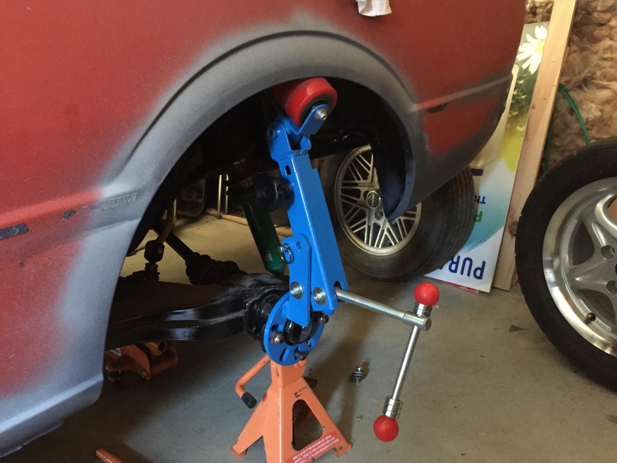

Tough_little_ke20 Posted April 3, 2016 Author Report Posted April 3, 2016 (edited) Ok this thing will hopefully be done in the next few weeks and I can get my 2 door back and put endless work into it to get it done, I've rolled the rear guards and the 225's fit perfectly and have rotors and rebuild kits for the brakes so the next job will be making new front hubs in a 4 stud so I can put the front wheels on. Again sorry to anyone who is missing seeing this car progressing Edited April 3, 2016 by Tough_little_ke20 Quote

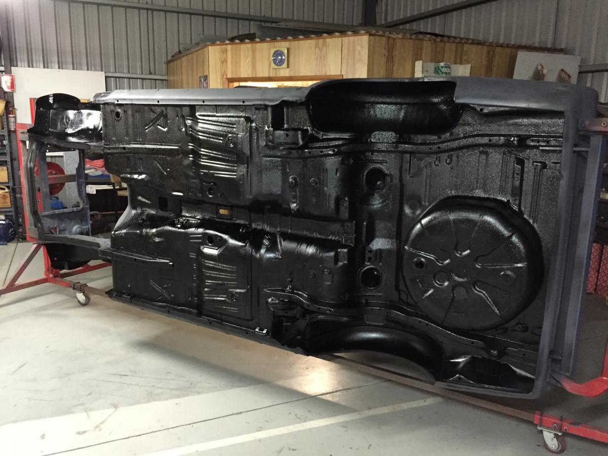

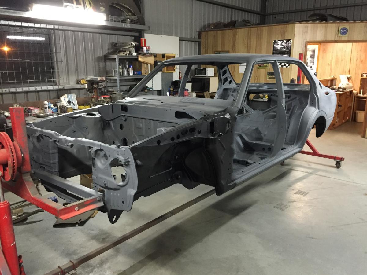

Tough_little_ke20 Posted April 14, 2016 Author Report Posted April 14, 2016 Nah prepped Friday night painted Saturday. The rust was fixed Easter weekend, few late nights this week though, built a spray booth for $200, works great Quote
