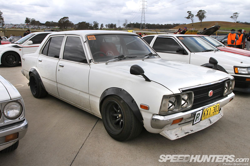

Rolla-Man Posted May 8, 2013 Author Report Posted May 8, 2013 I'm going for hardcore dude I'm wanting the look of that red one :) Quote
altezzaclub Posted May 8, 2013 Report Posted May 8, 2013 haha! It may look cool, but having chased this one down some winding roads, don't expect handling or ride comfort from cars like that- Quote
