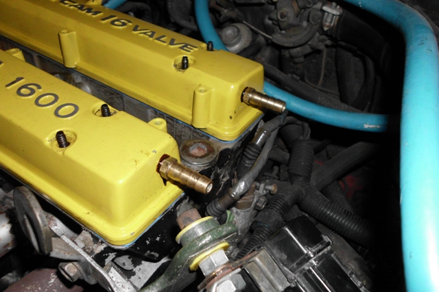

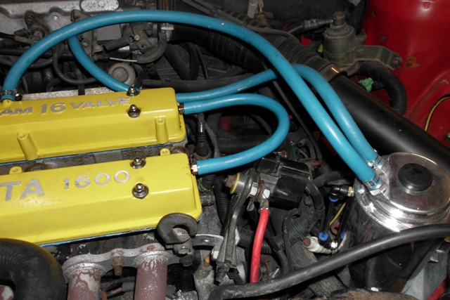

As for the cam seal, i put a breather between the 2 cam covers. don't know if that was the problem but at least it will eliminate that from the list of possible causes. My biggest fear was to spread oil all over the track and spoil the day for all the other competitors. It is round 2 of the Victorian Hillclimb Championship so there are drivers from all over Aus.
Thanks also to ke70dave for your input. I was going to pull the other cam cover off Jills last year car but then I thought of a breather tube between the 2. Let me know what you think.

Did you install the seal with the seal packing on the outside? I can only think the seal wasn't quite seated and it got flicked out by the camshaft. I really doubt it's a crankcase pressure thing.
I would brace the breather pipe, as putting load on an unreinforced section of the cam covers may lead to it cracking.
Atlantic heads suffer from seal dislodging... they make two small semi circular plates and screw them to the front of the head under/around each cam.
As to a better breather... see that rear most Allen plug, remove that plug and install a fitting there, that should be sufficient. OR... keeping your rear breathers... don't connect them, but splice them all into the oil separator.
