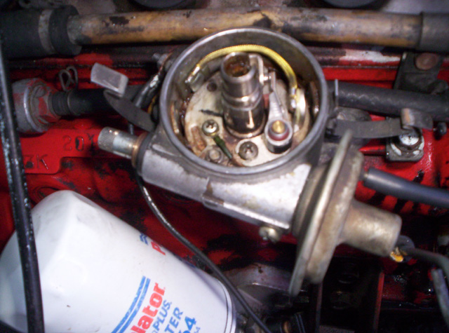

Raven Posted February 27, 2006 Author Report Posted February 27, 2006 (edited) I got a 3K-H in the panel van and it hauls pretty well. Especially once i adjusted the vacuum advance on my nippon-denso distributor! The knob on the left is to advance the timing. :jamie: Who else has this style of distributor? They came out in KE20, 25 & 26 models. Edited February 27, 2006 by AE35 Quote
Toycrash Posted February 27, 2006 Report Posted February 27, 2006 AE35 said: The knob on the left is to advance the timing. :jamie: Who else has this style of distributor? They came out in KE20, 25 & 26 models. Actually it's a octane selector and it's a not the best place to adjust your timing, because it allso restricts your vacuum advance actuators movement. Found in older K-engines. 3K-H is an older bigport engine, ours were pre -75 ones. 3K-B is obviously twin carbie Quote
