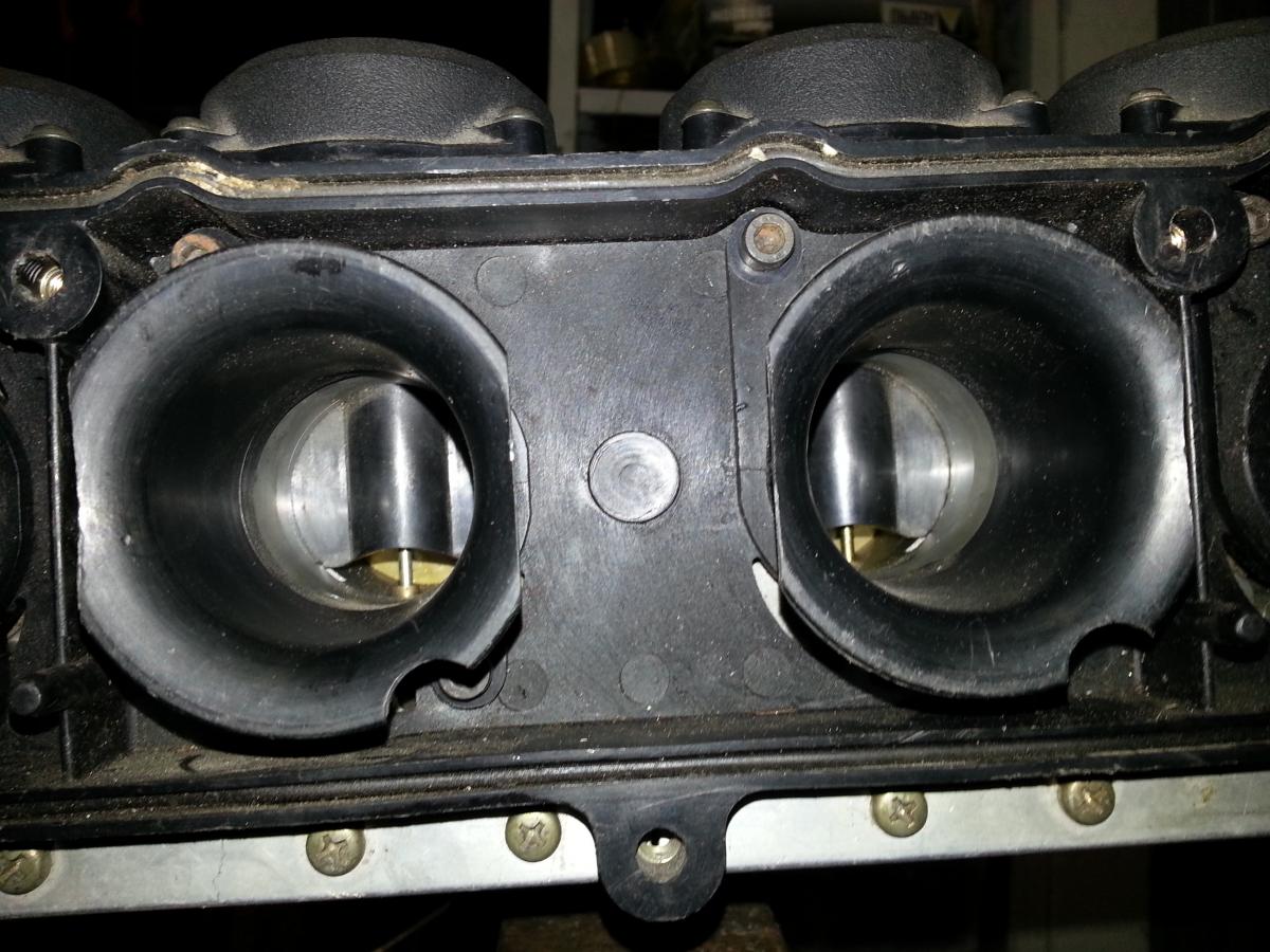

carbonboy Posted August 24, 2013 Author Report Posted August 24, 2013 Bits & pieces for DIY inlet manifold V1.0. Quote

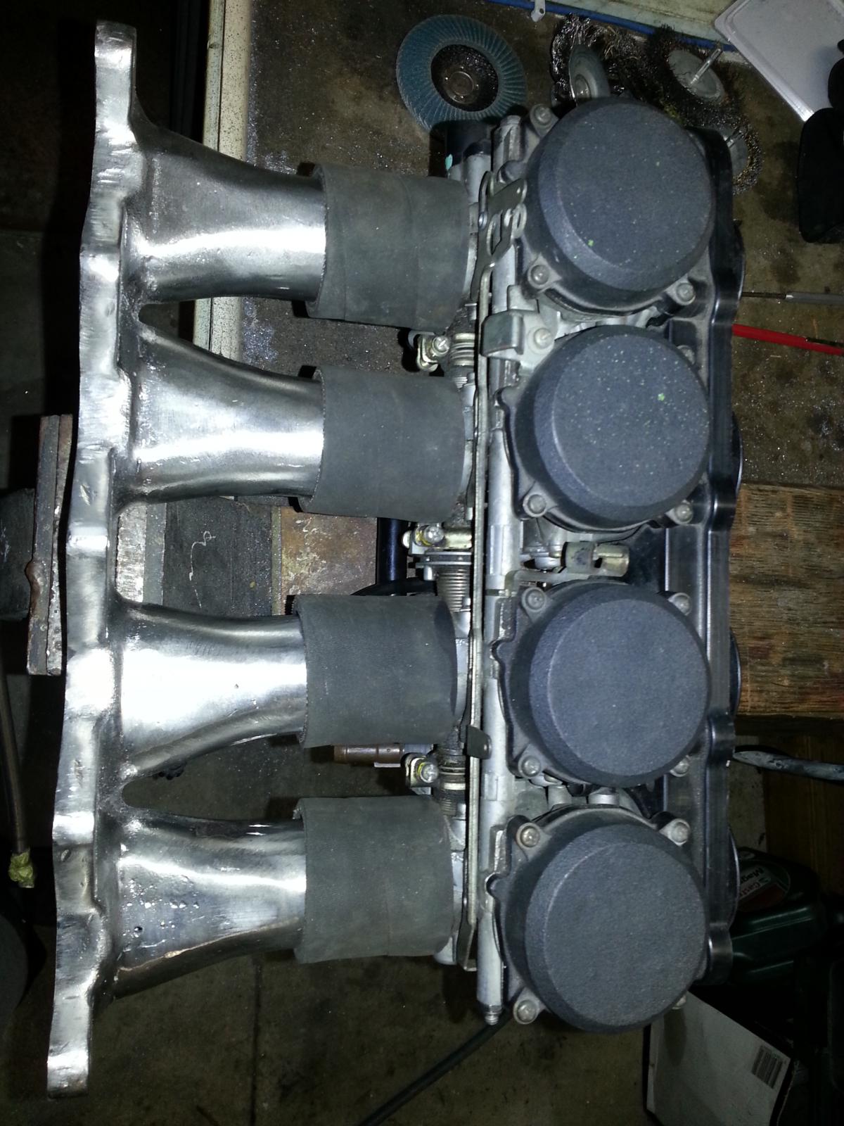

carbonboy Posted August 25, 2013 Author Report Posted August 25, 2013 (edited) Threw out V1.0 & started from scratch on V2.0, made it this far today & will be finishing it off after work during the week. I enjoy doing this on a recreational basis, I don't think this is something I would want to/be capable of doing for a living. :hmm: Thanks to the generosity of a fellow TCCAV member, I had my choice of Arc, TIG, MIG, or Oxy-Acetylene. Used the MIG for tack-welding (first-time user, LOVE these things!) & will use Oxy-Acetylene for the final runs. This is due to sticking with what I know & can do better, my Oxy welds come up better than my MIG welds. So be it. *shrugs* The insides of the runners will need die-grinding to clean them up once welded to the flange, both from the welds & my inability to get the shape of the ports exactly right. Within 0.5mm was close enough, weld is added to the outside so I figure it's all good to take a little off the inside to match the port. Edited August 26, 2013 by carbonboy Quote
carbonboy Posted August 26, 2013 Author Report Posted August 26, 2013 Got it to what I call stage 2 this afternoon. Made up a jig to replicate the carburetor positions, was also useful to making sure they were straight/square/plumb etc. Could have just re-positioned the carbs to suit the port position width-wise, but was going to make a jig of some kind anyway..... *shrugs* Quote
carbonboy Posted August 30, 2013 Author Report Posted August 30, 2013 I'm ashamed to post photos of the 'before grinding' item, so not happening. :P Suffice to say, it's taken a bit of love to get it to this stage. Quote
carbonboy Posted September 1, 2013 Author Report Posted September 1, 2013 Still needs some vacuum ports installed, some hole filling/finishing work, but you get the idea. :) Quote
